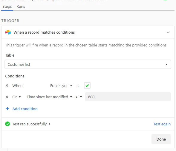

Thanks for the information. The issue you referred to indeed seem to explain my issue. I made the Last modified time field dependent on the Force sync field. That seems to solve it as it will cause both conditions to go to false.
Here is the screenshot of my trigger for later reference.
