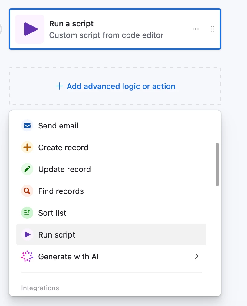

The first thing you will want to do is click the Automation Tab → Create your Trigger → under actions  create an action that says “Run a script”.
Creating The Script Automation

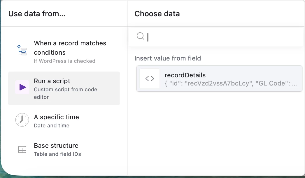

If you have any previous steps with the output.set() function from a previous script you will click the plus sign and for my example Run a script from a previous script and then recordDetails as I have information stored from there using the output.set() I mentioned earlier.
Setting up Use Data from Input Frame

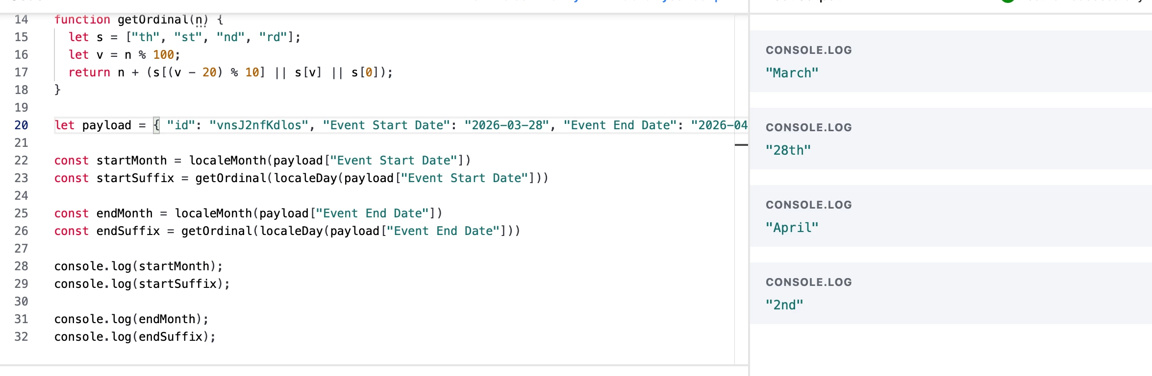

// This will grab the month in long format (January, February, March etc.)
const localeMonth = (d) =>{
return new Date(d).toLocaleString('default', { month: 'long' });
// This will grab the day of the month from our date passed in (mm-dd-yyyy)
const localeDay = (d) =>{
return new Date(d).toLocaleString('default', { day: 'numeric' });
// This will give us the ordinal value based off of the localeDay function format (st,rd,th)
function getOrdinal(n) {
let s = ["th", "st", "nd", "rd"];
let v = n % 100;
return n + (s[(v - 20) % 10] || s[v] || s[0]);
const startMonth = localeMonth(payload["Event Start Date"])
const startSuffix = getOrdinal(localeDay(payload["Event Start Date"]))
const endMonth = localeMonth(payload["Event End Date"])
const endSuffix = getOrdinal(localeDay(payload["Event End Date"]))
Example Inputs & Outputs
Let's apply everything together now and use some sample inputs to showcase what your outputs should look like. For our sample data I will be using this payload to demonstrate. Feel free to just copy this for learning purposes. If you have your own data that you have already cleaned then make sure you have imported it with the steps above.
Sample Code:
{ "id": "vnsJ2nfKdlos", "Event Start Date": "2026-03-28", "Event End Date": "2026-04-02"}
Output example and Input
Reviewing the console on the right you can see that we have the proper month translated from “3” into March and the date of “28” is now “28th” thanks to our getOrdinal function! Hopefully this helps out when you are cleaning your data and using Javascript to work with Date formats. I have also published a full version of this script to the community as well.

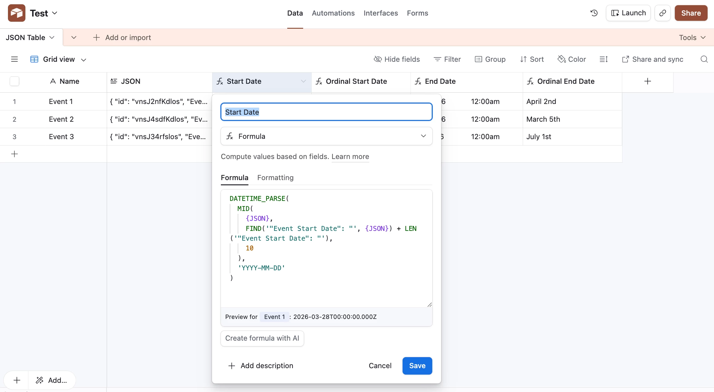

​@Michael_Tyler , this is a great post, thanks a lot for taking the time to share it... Super helpful, especially for people getting started with scripting in Airtable.
That said, one of the cool things about Airtable is how powerful the data layer can be on its own(!) You can actually achieve a lot of this without jumping into automations or scripts.
In your case, you could do the same thing directly with formula fields. Here is how...

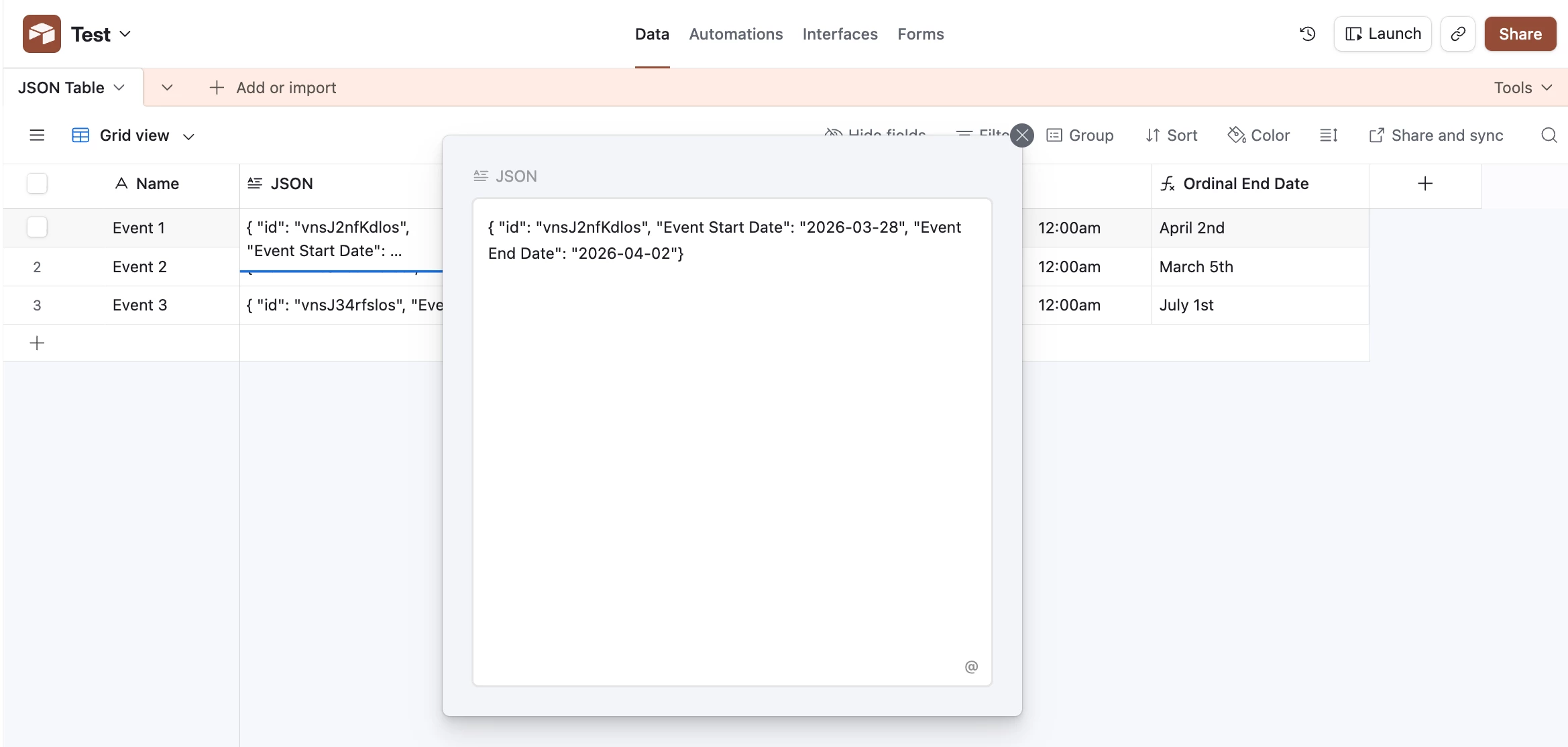

Imagine you have a table where the JSON is stored in a long text field.
Step 1: Extract the date from the JSON
Since your JSON structure is simple, you can pull out the date with a formula like this:
DATETIME_PARSE(
MID(
{JSON},
FIND('"Event Start Date": "', {JSON}) + LEN('"Event Start Date": "'),
10
'YYYY-MM-DD'

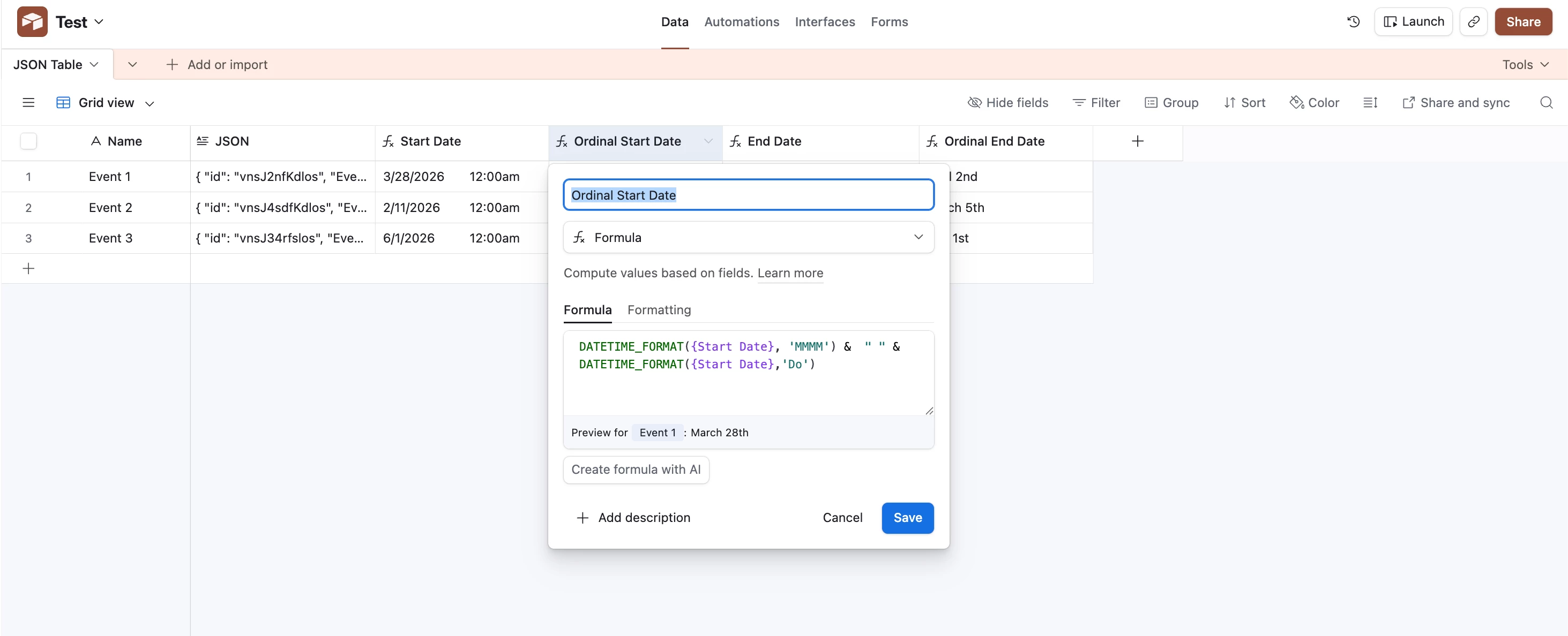

Step 2: Format it as Month + ordinal day
Then create another formula field to format the date into something like "March 28th":
DATETIME_FORMAT({Start Date}, 'MMMM') &  " " &DATETIME_FORMAT({Start Date},'Do')

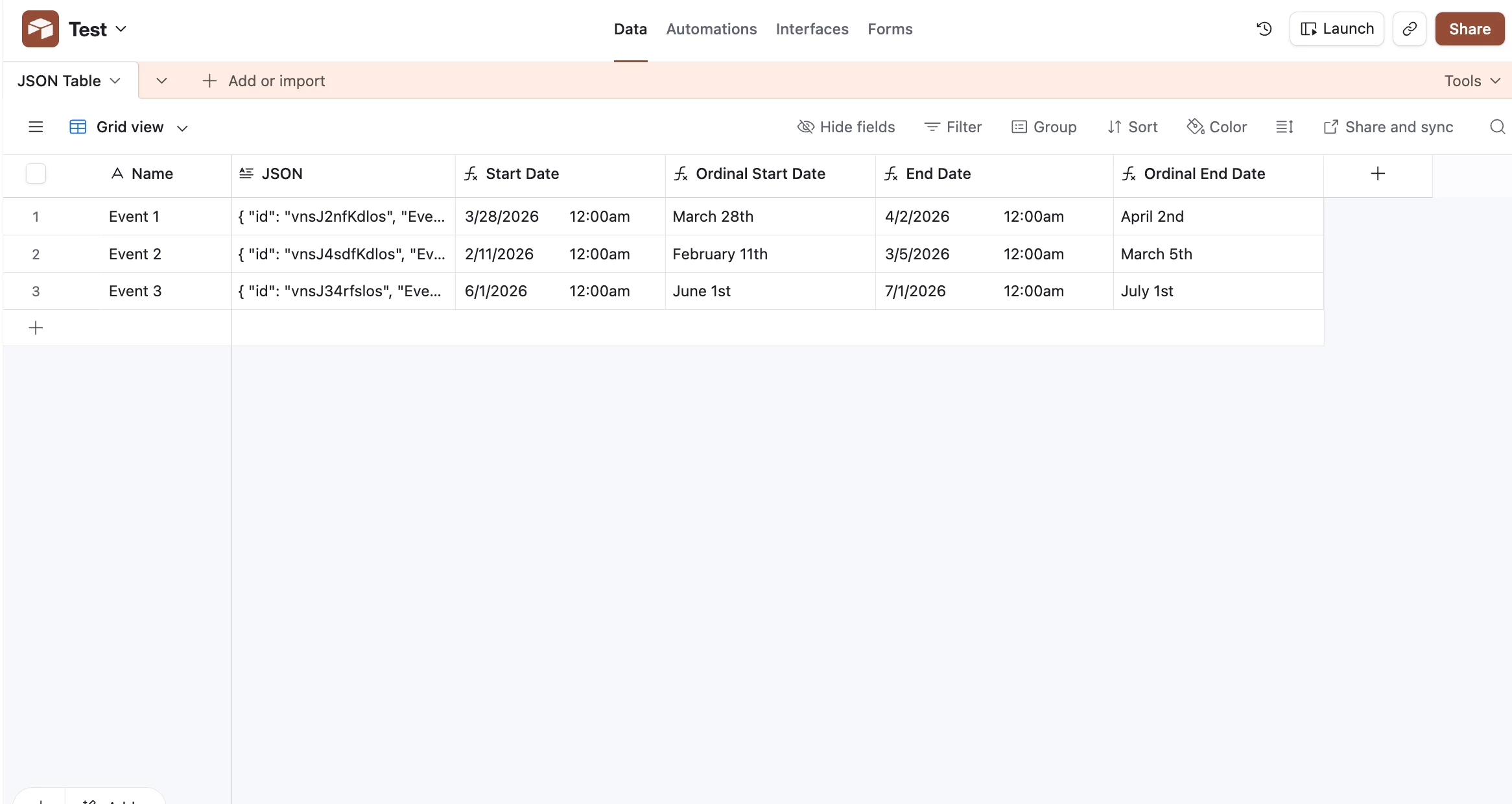

You can repeat the same pattern for the end date as well. And your table will look like this:
Definitely agree scripting gives you more flexibility, but for cases like this it’s nice to keep everything in the base and avoid the extra automation step ;)

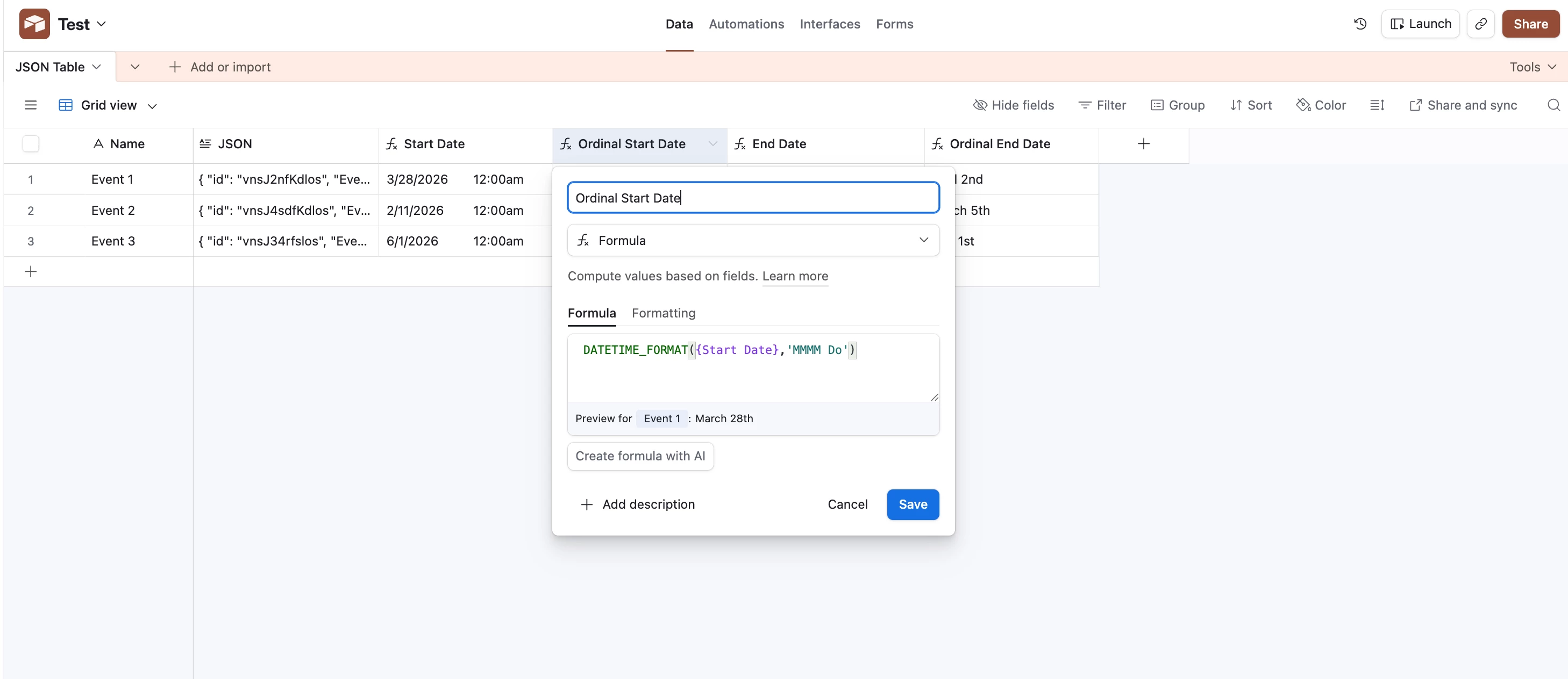

FYI: This is already natively built into Airtable’s formula fields, and it’s even simpler than what ​@coderkid posted above.
You just need to use Airtable’s supported DATETIME_FORMAT format specifiers.
So, if you have a date, and you want to get the ordinal number of the date, you just need this formula:
DATETIME_FORMAT({Date},'Do')
That’s it! :) Hope this helps!

​@ScottWorld thanks, updated!
Correction :
DATETIME_FORMAT({Start Date},'MMMM Do')
