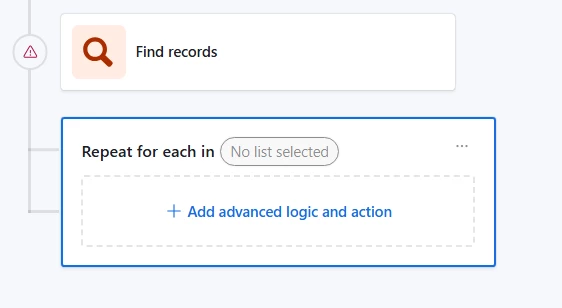

Why don’t you use “Repeating Logic” block in automation after “Find Record” with limit set to 1 record? This will help you loop over every record found in the list and do whatever you want to do. But since you are setting conditions and limit such that you are expecting exactly 1 record from Find Records, your loop win run only once.
