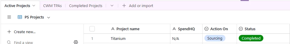

Hello, I would like to write a script that will move this project from “Active Projects” table to “Completed Projects” table when the status is changed to “Completed”. Can anyone help? Thanks!

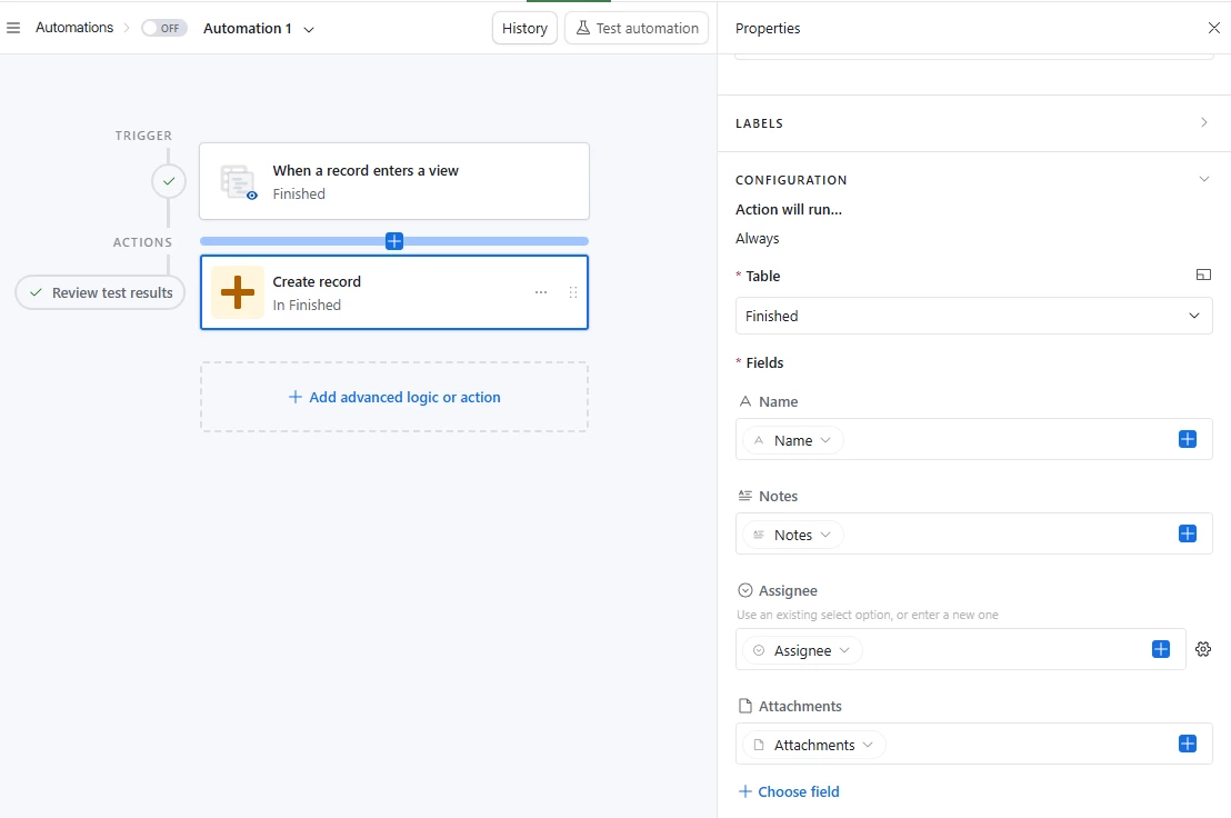

You can do this with an automation BUT I do recommend just using the Views section to filter this. For the automation, you’ll need to do this anyway.
Here’s how I’d do it:
  1. Create a new view in the Active Projects section. Filter this view so it only shows completed projects. Make this a locked view so that accidental errors don’t occur.
  2. Set up an automation that is triggered by a record entering a view. Make it be the filtered view.
  3. Choose Create record to occur next. Create this record in the Finished Projects tab and select the information that you want to carry over.
  4. Turn it on and it should run when a new record enters the view!
And I recommend just using the view inside of the Active Projects tab because there is not yet a “Delete Record” option inside of Airtable automations. The record will continue to live in that base but can be filtered out so that it’s not visible in your Active section.
