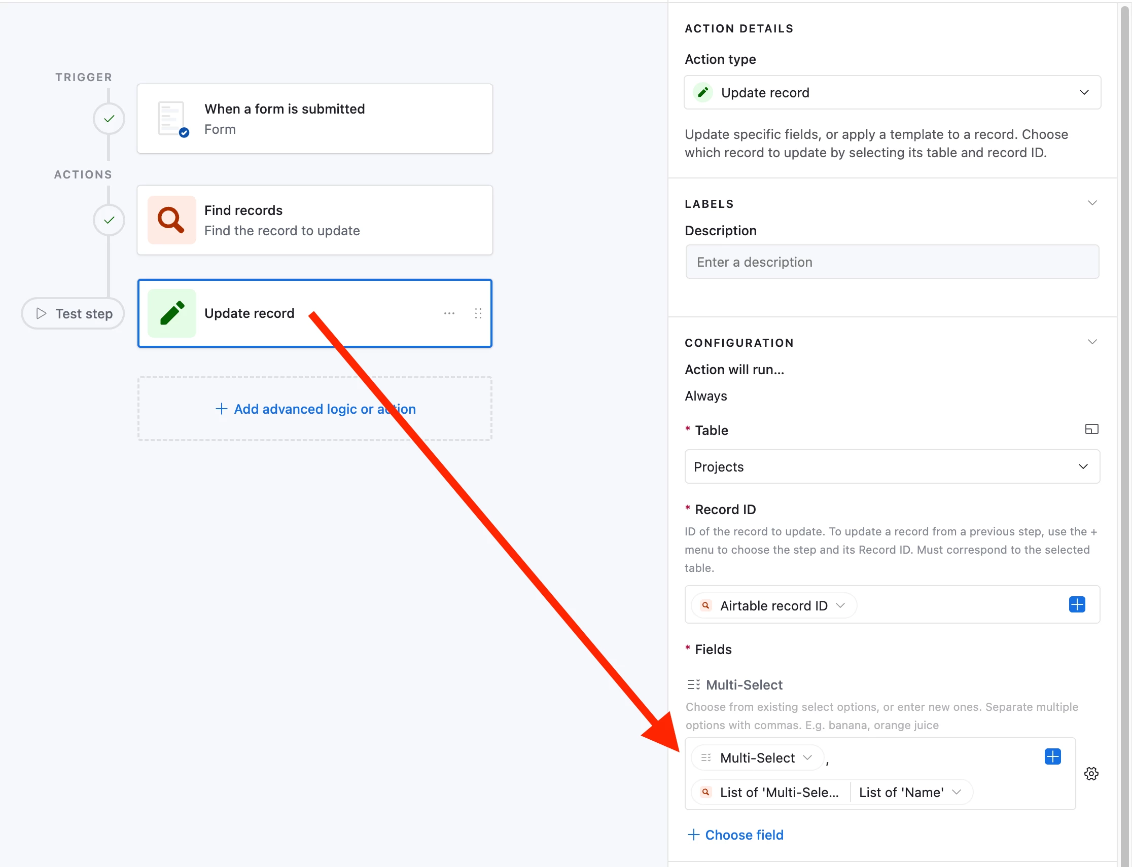

That is not natively supported by Airtable, but you could create an automation that updates the existing record’s multi-select field by appending the new data to the old data.
Within your automation’s “update record” action for the multi-select field, you can do this by inserting the NEW multi-select values, then typing a comma, then inserting the OLD multi-select values.
Please see my screenshot below for how this might look in your automations.
However, you will get unexpected results if either the OLD or the NEW values are blank. Airtable will add a blank entry to your multi-select values. To prevent that from happening, you would want to add some conditional actions to your automation to take different actions if either of the multi-select values are blank.

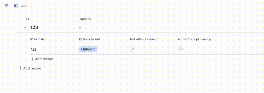

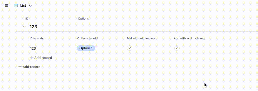

The quickest way to do it would be like Scott mentioned above!  This adds a sort of ghost option in situations where the initial value is empty.  This is just a display thing and doesn’t affect one’s workflows normally

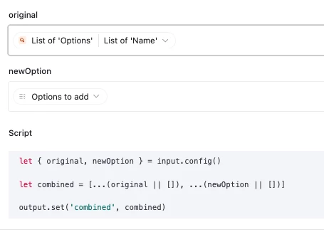

If you want to, you can add a Run a Script step to your automation to make that not happen and I’ve set it up here for you to check out!
And here’s how the script’s setup:
let { original, newOption } = input.config()
let combined = [...(original || []), ...(newOption || [])]
output.set('combined', combined)
