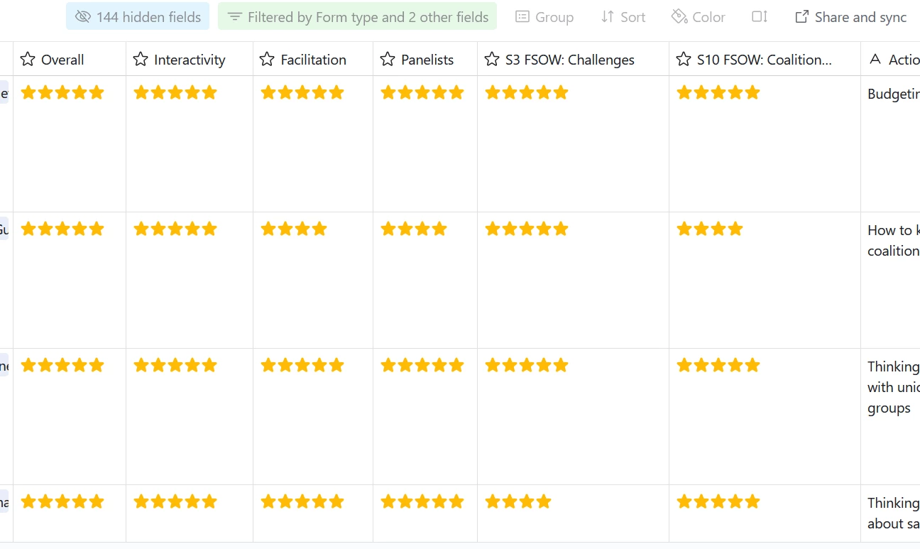

my organization does trainings and after each training, we send participants a post-survey to fill out. each training covers slightly different topics, so the questions we want feedback on change slightly with each training as well.
right now, i have one table called post-surveys where each field corresponds to the questions we ask, and the field names are shortened versions of the questions. then we build the form for each post-survey based on which questions we’d like to include. the downside is that it means that table has a huge number of fields and it’s hard to see if the question you want to include already exists as a field or you need to create a new one. (e.g. “S3 FSOW: Challenges” means in session 3, we had a question about challenges that related to the reasons we did the session, you can see how that makes it hard to keep track of the actual question)
i’d like to have a table that’s a list of the questions & what type of question they are, a related field for the training it was used for, and be able to build the form from that. is that possible??
if not, any other ideas to better keep track of the questions we’re using for each survey?

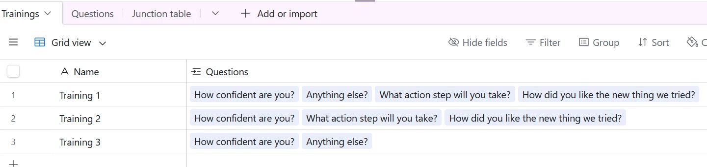

thanks for this suggestion! give me a little more info about how to set up the Junction table? here’s what i’ve got so far (just playing with concept):

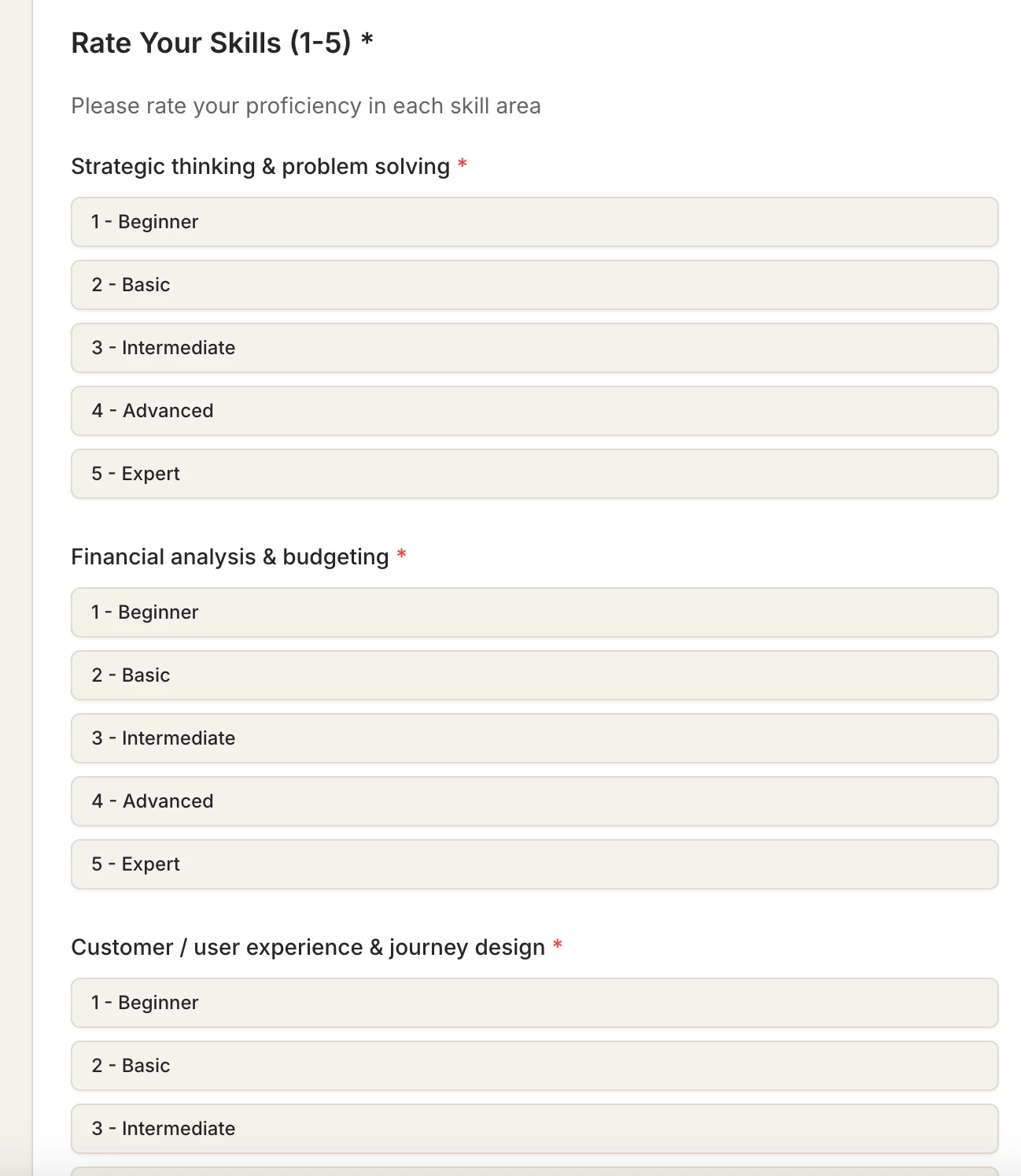

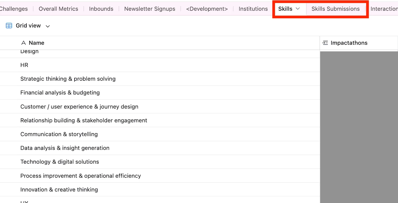

Hey ​@cori_parrish1!
Building on top of what ​@ScottWorld mentioned, this is the exact use case I built on Zite (Fillout’s “AI APP” product) a few weeks ago. See a couple of screenshots below.
My AT architecture handles Skills and Skill Submissions.
My Zite app will show for the corresponding Imapctathon, the only the corresponding skills, and for each it will create Skill submissions records linked to the user signing up.
Feel free to grab a slot if you need any help setting this up! I’d be happy to show you around.

i still don’t get how to set up the junction table. can one of y’all give me just a couple more sentences on what the fields are in that table? thanks & sorry to be dense!

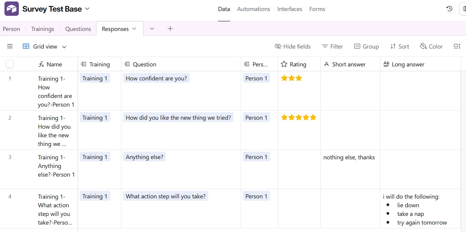

I don’t have the full picture, so you might want to tweak the following a bit, but I’d suggest the following structure of tables:
Contacts
Training
Signups
Questions
Answers
Contacts is linked to Signups
Signups is linked to Training
Questions is linked to Training (this is you “list of questions”)
Answers is linked to Signups and to Questions (this is you junciton table. You get one record per answer per question for each training).
You can check out the video below for more info on junction tables!
Does this make sense?

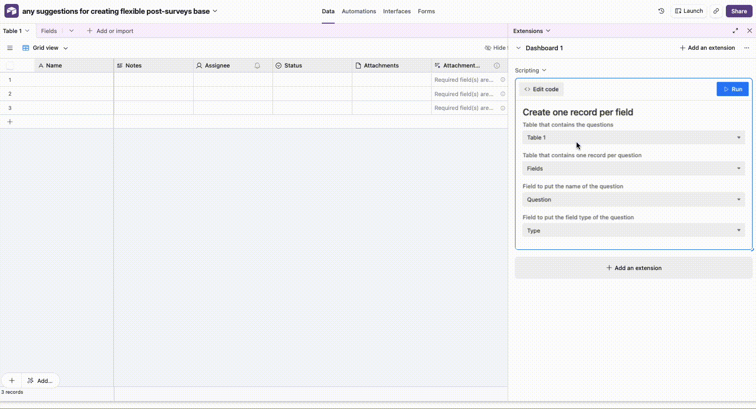

You could try using a script extension for this!  You’d create a new table where each record represents a single field, and then use the table.fields model to grab all the fields and create one record per field
https://airtable.com/developers/scripting/api/table#fields
I’ve set it up here for you to check out
let settings = input.config({
title: "Create one record per field",
items: [
input.config.table("questionsTable", { label: "Table that contains the questions" }),
input.config.table("fieldsTable", { label: "Table that contains one record per question" }),
input.config.field("nameField", { parentTable: "fieldsTable", label: "Field to put the name of the question" }),
input.config.field("typeField", { parentTable: "fieldsTable", label: "Field to put the field type of the question" }),
let { questionsTable, fieldsTable, nameField, typeField } = settings;
// get all fields from the source table
let sourceFields = questionsTable.fields;
// build records to create
let recordsToCreate = sourceFields.map(field => ({
fields: {
[nameField.id]: field.name,
[typeField.id]: field.type,
while (recordsToCreate.length > 0) {
await fieldsTable.createRecordsAsync(recordsToCreate.slice(0, 50));
recordsToCreate = recordsToCreate.slice(50);

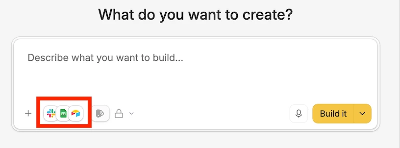

Hey ​@cori_parrish1,

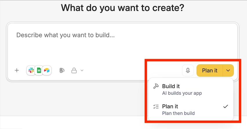

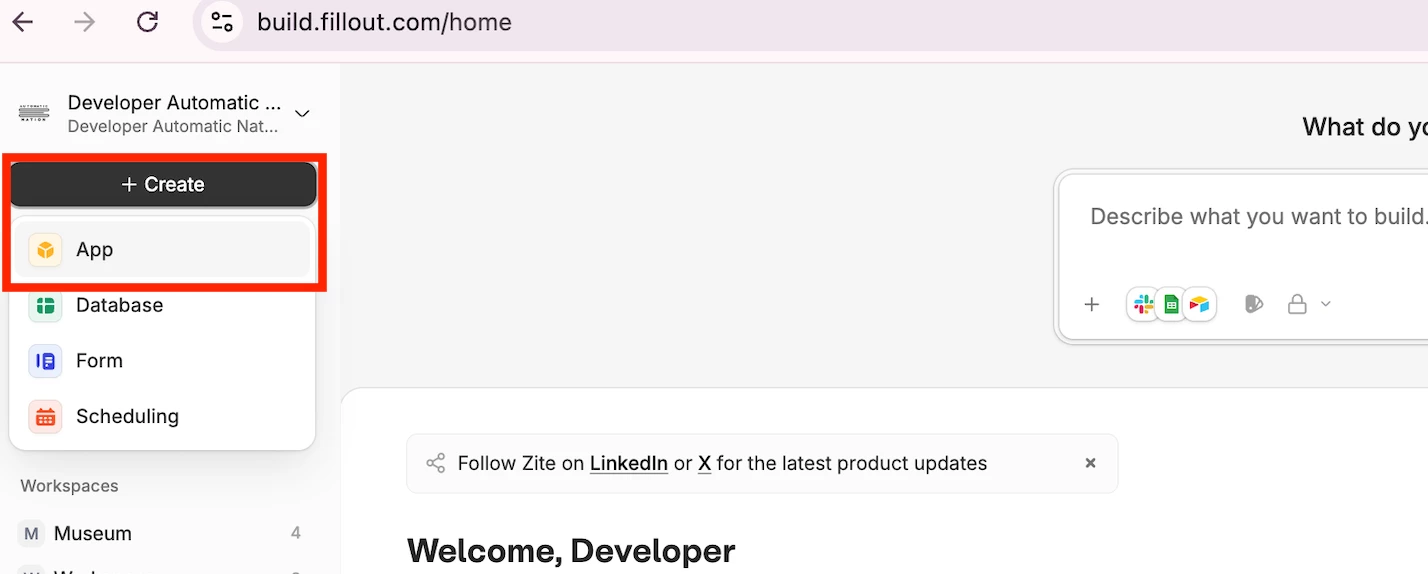

Great! You have the first step. For the form creation I would highly suggest: Avoiding Airtable custom forms (you will not be able to get this done via native forms). Use Zite.
Open Zite.
Create a new App.
Connect your airtable base and table.
 Prompt the system what you need using their “Plan” mode first.
Then use “Build it” when the plan looks good enough!
Important note:
You can decide to have (i) generic url, and heve the contact provide their email address and then you set up an automation or manually map the corresponding person to the feedback record, or (ii) have dynamic urls which include a url parameter such as “?person={person record id}” and to pre-populate the person field on the back.
If the latter, you’ll have to create a formula in airtable to construct this.
For sure your url will need to capture training parameter, as depending on which training we are talking about which questions should be asked. Also discuss this with Zite.
Additional suggestion: You might want to have some back and forth with Claude before pushing your initial prompt to Zite as not to spend too many credits nor messages (limited on the free plan) just brainstoriming!
Feel free to reach out as needed!
