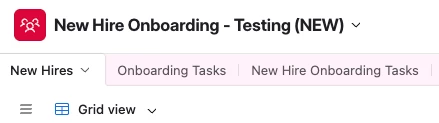

To do this i’ve set up three tables so far:
  • New Hire Tab (the employee info)
  • Onboarding Steps (the process the employee goes through, but managed by a number of internal teams)
  • A junction table combining both of these

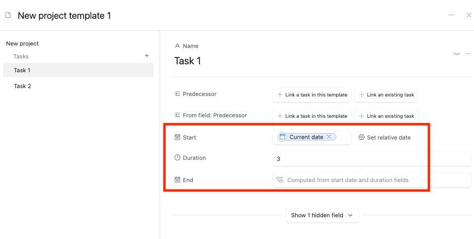

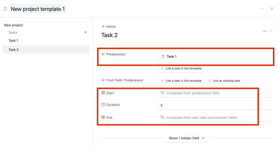

For the predecessor tasks + durations thing you may want to check out record templates: https://support.airtable.com/docs/using-record-templates-in-airtable
In the following example, Task 1 is set to start on the day the task is created with a duration of 3 days, and Task 2 automatically has Task 1 as its predecessor:

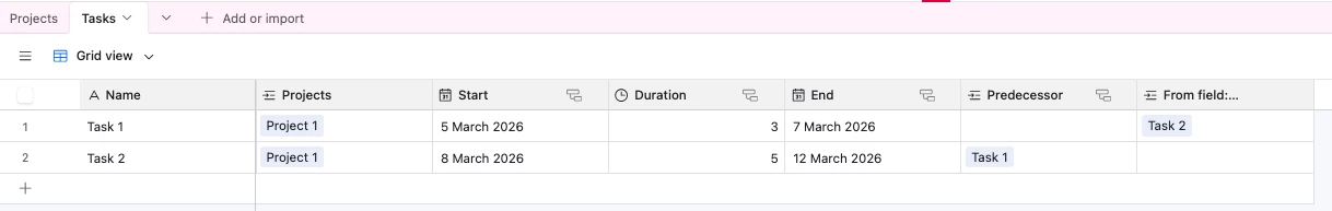

And so after we apply the template, the predecessor + dates get set automatically:
I think we can get the predecessor links working with just an automation as well but record templates are simpler for this
