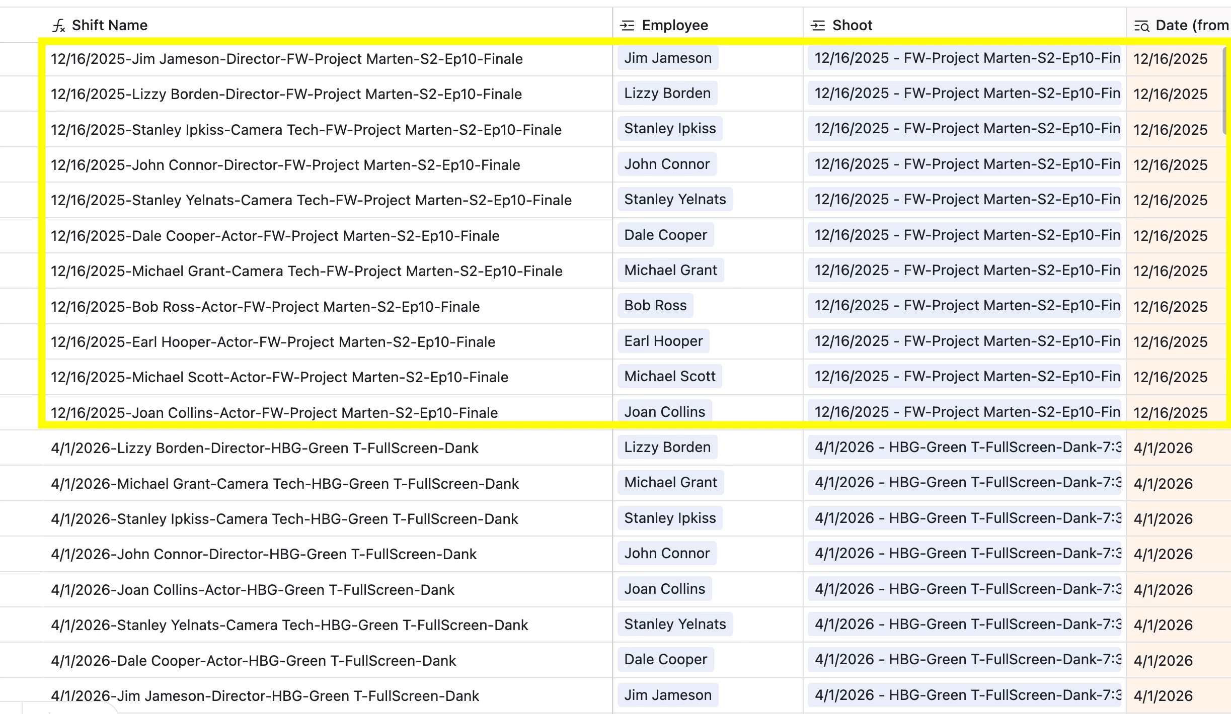

I am trying to create a breakdown of call sheets for group shoots and create individual “shifts” in a junction table. The goal is to be able to adjust start and end times for those linked in the shoots and to be able to create a more comprehensive reporting interface to track hours and OT by multiple criteria.
I cannot show the actual base, but have created a basic example of the structure and result of Airtable’s junction table extension.

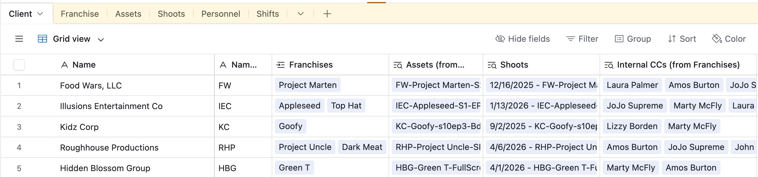

Client tab:

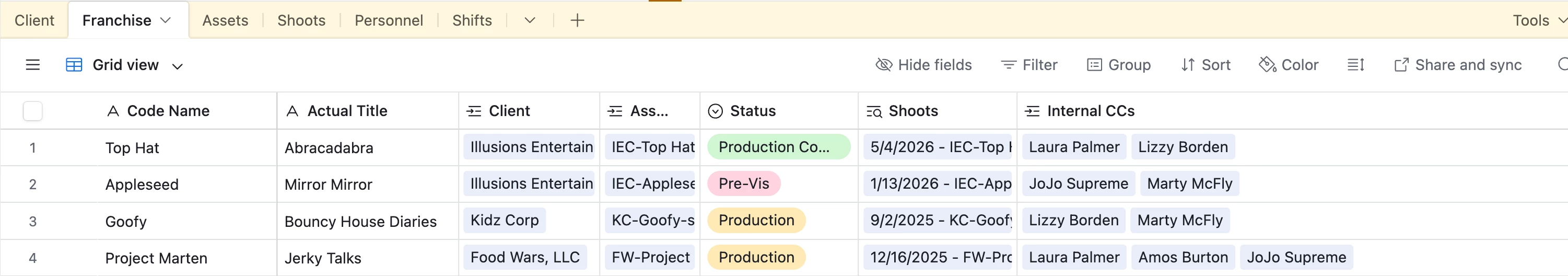

Franchise:
Franchises have assigned POCs for internal notifications. This could include executive roles/higher level visibility. Would not include anyone linked in “Shoots”

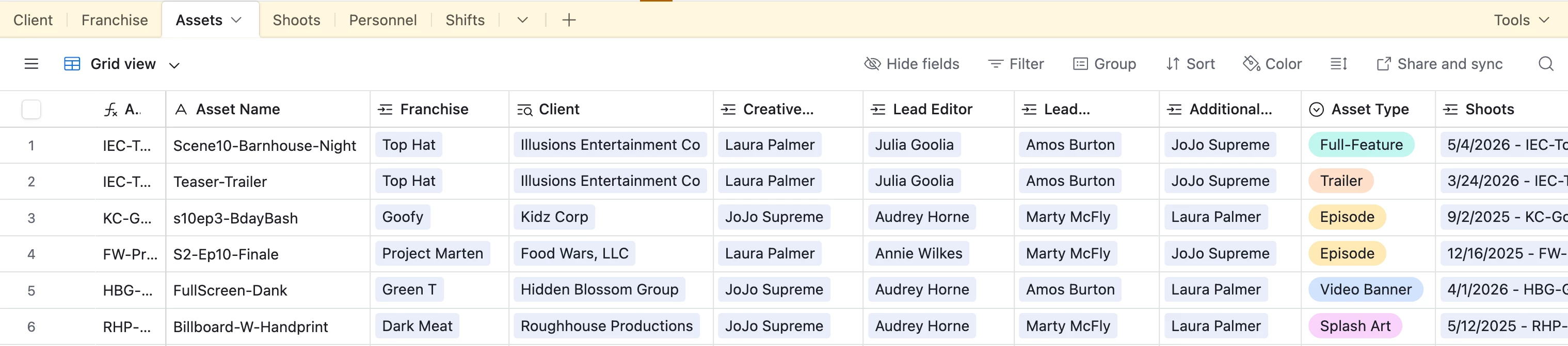

Assets:
Linked directly to Editors, Creative Directors, and Producers.

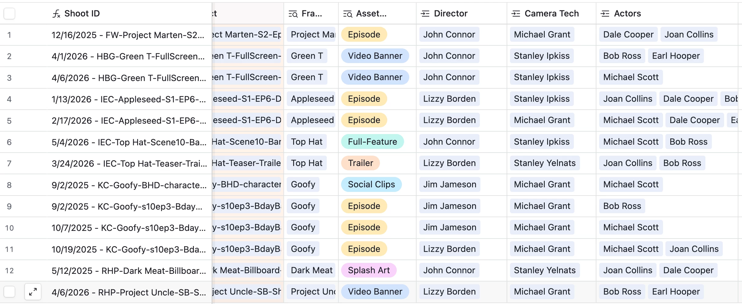

Shoots:
Only linked directly to Directors, Camera Techs, and Actors.

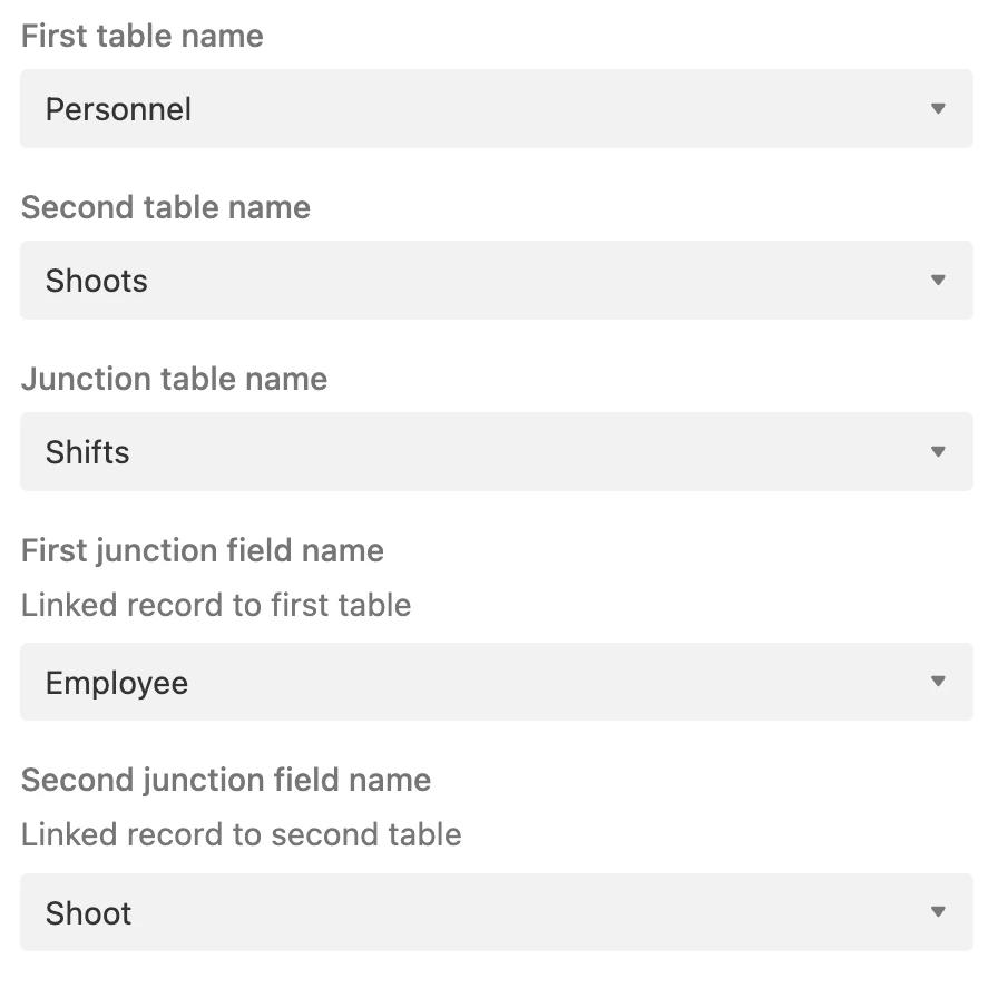

Settings for Junction Table Extension:

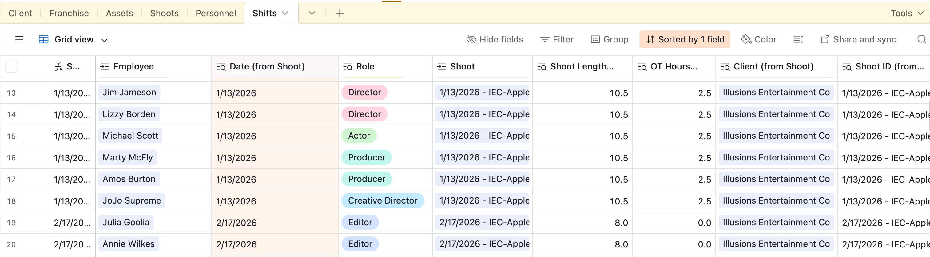

Result - Shifts (Junction Table)
As you can see, it is pulling in combinations for Producers, Editors, and Creative Directors when they are not directly linked within Shoots. Is there a way to restrict the junction table to parse only what is directly linked between Personnel and Shoots? I only want to consider the “shifts” of Directors, Camera Techs, and Actors.

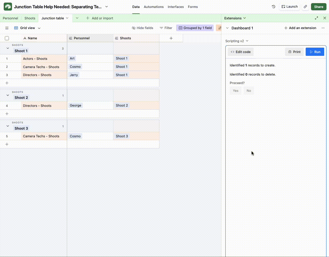

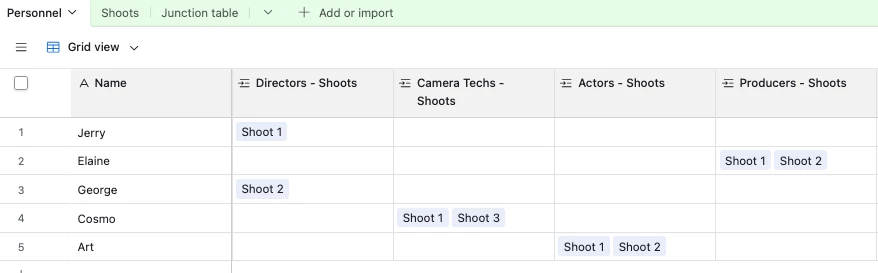

Ah you’re right, so sorry!  I’ve updated the base with a new script that I think should do what you need, let me know if it’s wrong and I’ll fix it up!
The new script will ask for:
  1. A view in Personnel for you to select from
  2. For each of those records in Personnel, the specific linked fields that you want to create records for

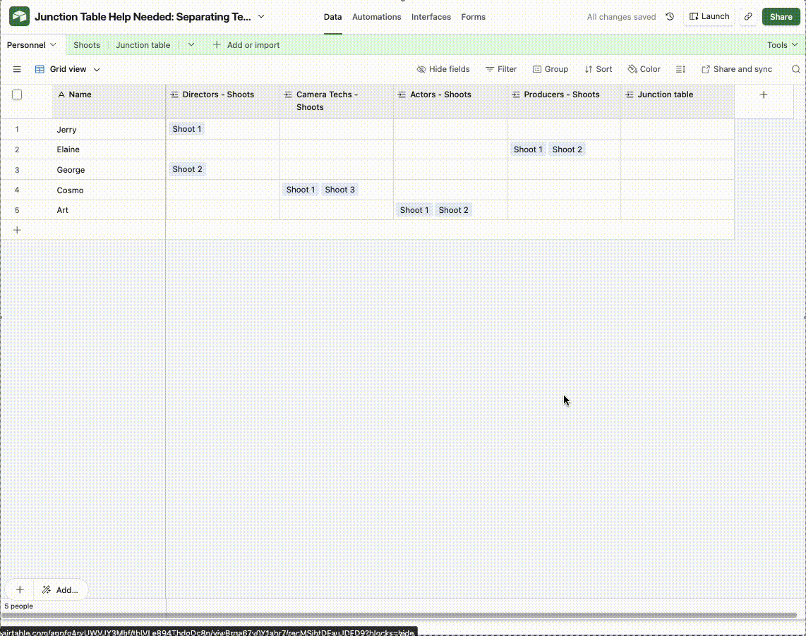

    1. And so with reference to the screenshot below, it’ll create 2 records for Cosmo, one for Shoot 1 and one for Shoot 2
This can also be set up to be an automation, but that really depends on the workflow.  Thinking about this, it feels like you’d probably be setting up all the Personnel data on a per Shoot basis, and then creating all the Shifts at once from there?

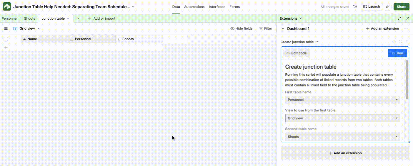

Ah this is happening because the Junction Table Extension grabs every record from the Personnel table when creating the junction records, while you want it to only grab the Personnel records that are linked to a Shoot
To fix this, you’d need to:
  1. Create a view in Personnel that only shows records that you want
    1. Specifically, the linked fields to Shoots for the Directors, Camera Tech, Actors aren’t empty
  2. Update the Junction Table Extension script to let you select a view instead

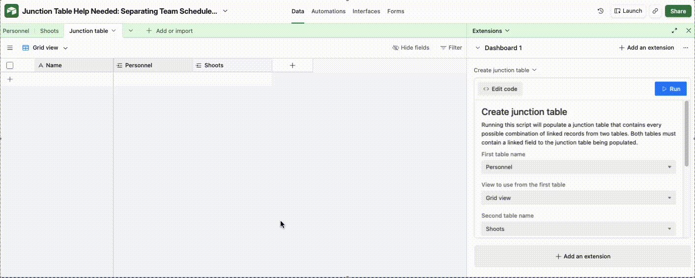

I’ve made the update to the script here for you to check out, and you can see how it works below
Here’s the original Personnel table and when we run the script on this view it creates one record per person per shoot:
And here’s the view where we filtered to only show the records where the Directors field wasn’t empty:
And we select this view and run the script on that view instead:
Here’s the updated code!

​@TheTimeSavingCo Thank so much you for putting that together! I applied the script to my test base and while it does filter out positions that are not referenced in the Shoots table by using a view in the Personnel table, it is creating Shift records with personnel that were not assigned to that Shoot:
For example, wee the first shoot listed for 12/16/25 for Proj. Marten in the Shoots table: The only personnel attached to that shoot is J Connor, M Grant, D Cooper, and Joan Collins
In the Shifts table (junction), it has created entries for additional personnel never assigned to that shoot:
  • Apr 13, 2026 7:57 PM UTC
​@VikasVimal If I knew how to script and set custom parameters within that script, I would! Unfortunately, I do not have the skill set to build it out myself. 🙂
