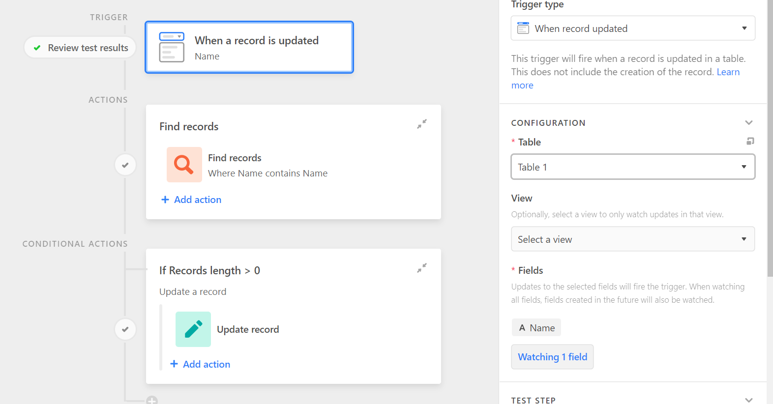

1) Automation
When a record is updated - Lookup the values in the SyncTable and update record in Target table.
  • not using here record created - because human created record will be created as empty first
  • limit the trigger to react only to update of the Product Name field

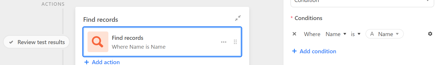

  • use Find records to look up the name in the other table

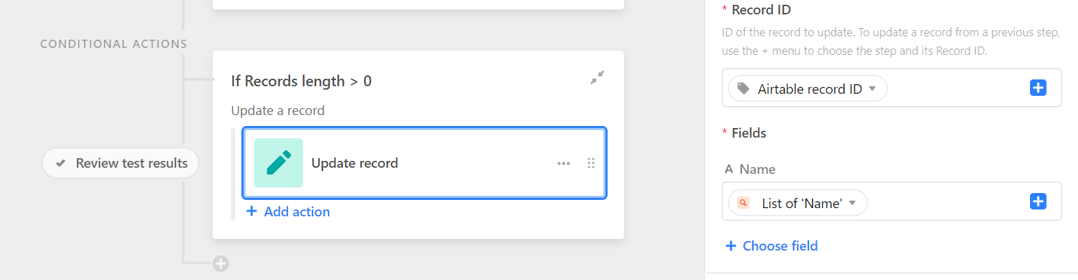

  • if there are records found, updates the fields you want with the “List of” values you want from Product table:
