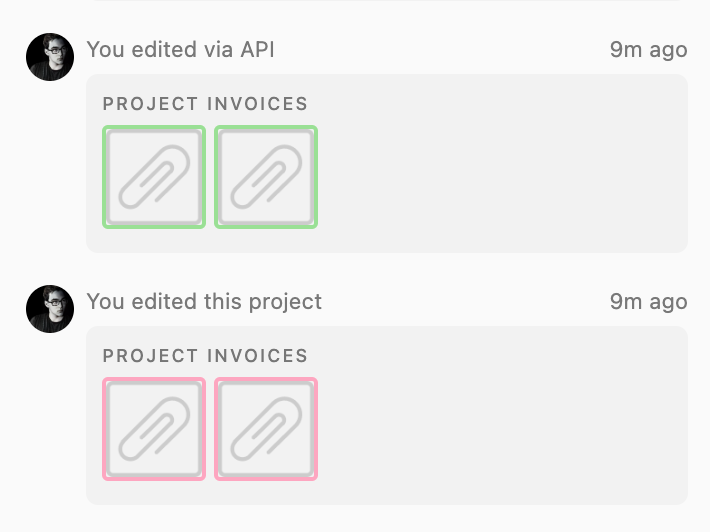

I have an automation that uploads attachments to OneDrive, then adds them to Airtable with their publically accessible URL.  This has worked for for well over 2 years, and a few months ago, randomly stopped with no changes on my end.  No errors get thrown anywhere, and we can actually see an attachment pop in for a second in Airtable and then clear out.  The revision log appears to show me adding the attachment, then deleting it.

This is a common problem that usually indicates that the file is not publicly accessible at the URL that you are providing Airtable.

If your still working on it I was able to make this work with a very small script function with AWS blobs.  As Scott says above it needs to be publicly accessible.  With AWS you can create a presigned link that expires quickly which is what I am doing and once you post the link it uploads.  Very easy and although I am using a lambda function in aws it costs only less than next to nothing a month for many thousands of transactions.  If its more than a dollar I'd be surprised
