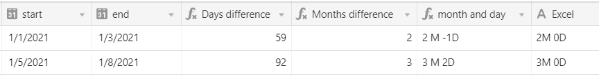

I had searched through the community and seen a post stating about the date difference of a period showing data like 2 months and 31 days or 3 months 30 days.
It is worse if it involves February as it will be calculated as 1 month 30 days.
Example as below.
I’m making all the months defaulted to have 30 days, as per below formula.
DATETIME_DIFF(end,start,‘months’
& ’ M ’
DATETIME_DIFF(end,start,‘days’
-DATETIME_DIFF(end,start,‘months’
*30
& ‘D’
I would like to know if there is any way to make the difference to be more accurate like those in Excel?
I saw that there is a post regarding Switch() formula but I have no idea how to include that into this formula.

Is there a way to calculate the difference exactly in Months and Days? Or should I forgo this method and just count by days instead?
Simplifying the solution from a similar topic
would give you:
DATETIME_DIFF({end}, {start}, "months") & " M " &
DATETIME_DIFF(
   {end},
   DATEADD({start}, DATETIME_DIFF({end}, {start}, "months"), "months"),
   "days"
) & " D"

First, thanks for the help in offering solution. But it still comes to the same answer, just in a simplified way.
The point of 2 months and 31 days which is supposed to be 3 months 0 days are still not solved.
That 31 days not being automatically converted to months are a real headache.

For your date fields is “use same timezone” turned on? Try toggling that to see if it calculates correctly. It works on my end.
  • August 13, 2021
Ok, weird. But I tested using your formula again and it somehow does its work.
hmm… Perhaps I’ll just keep monitoring it… My brain suddenly works now.
