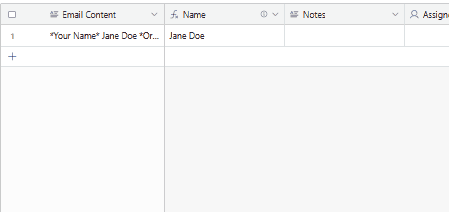

To extract the name:
REGEX_EXTRACT({Email Content}, '\\*Your Name\\* ([^\n]*)')
Do the same for the other fields, replacing "Your Name"  with the desired field name.
Quick explanation: the part between the brackets (...) is the one we're matching for, [^\n] means anything other than a line break, and the star at the end matches any amount of these (non-linebreak) characters.
So this finds the line that start with *Your Name* and finds the rest of that line.
Hope this helps, good luck with your setup 🙂

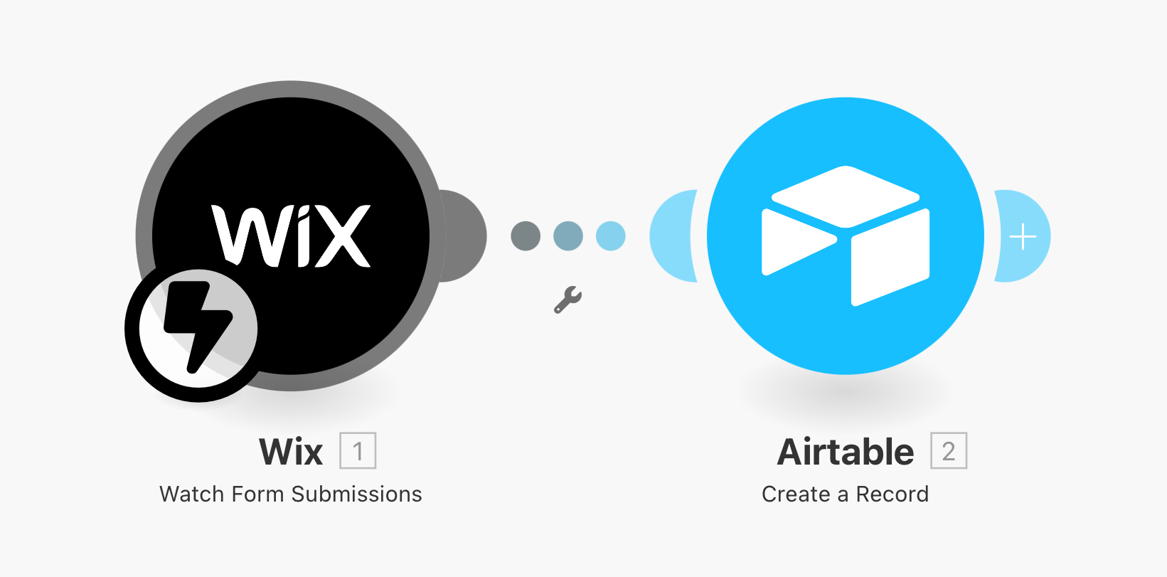

FYI: Instead of parsing the body of a email using formulas, there are typically more efficient & more straightforward ways of process incoming forms coming into Airtable.
Where are your forms coming from? You can typically use Make’s advanced automations (for 100% free) to automatically process your incoming forms for you and then parse the data into the proper Airtable fields.
For example, let’s pretend that your forms are being submitted through a Wix website. You could simply use Make’s Airtable integrations and Make’s Wix integrations to create an automation that looks like the screenshot below.
Furthermore, Fillout’s advanced forms for Airtable is 100% free and it is designed to directly communicate with Airtable — with no automations needed at all.

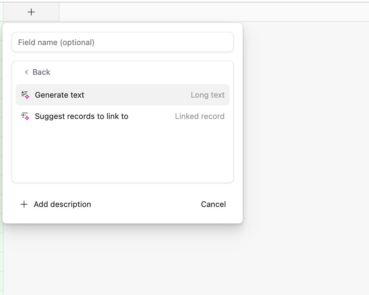

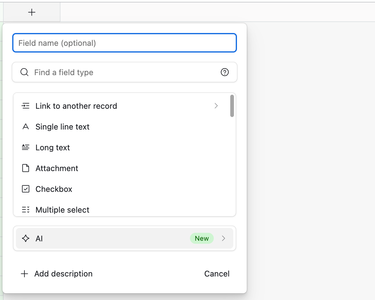

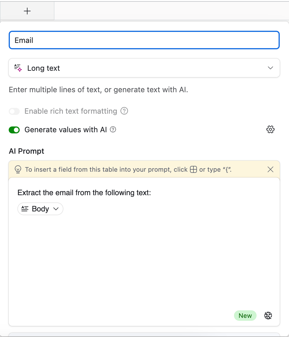

Hey @teri_d!
I'd love to pitch in my suggestion as well, in addition to insights shared by @ScottWorld and @Milan_Automable.
Regex is great in the sense that it is a pretty lean and straightforward solution. However, it also assumes that your data is super structured and formatted correctly every single time. However, if end users sending the emails do not format the email correctly every time, Regex might miss some of the data.
To extract specific data from unstructured text, you might want to give Airtable's AI field a try (Teams plan). You can find out more about the AI Field here.
Within the field configuration, you can select the "Generate text" option, and then the "Start from scratch" option.
For last, you can write the corresponding prompt for the corresponding field. Below see an example on how to extract email from field "Body".
This might be overbuilding for your specific case, but just bringing it up in case it is helpful for someone 😄

  • February 21, 2025
Thanks, everyone! was able to make it regex work! But would definitely look into the other suggestions here. You guys are awesome!
