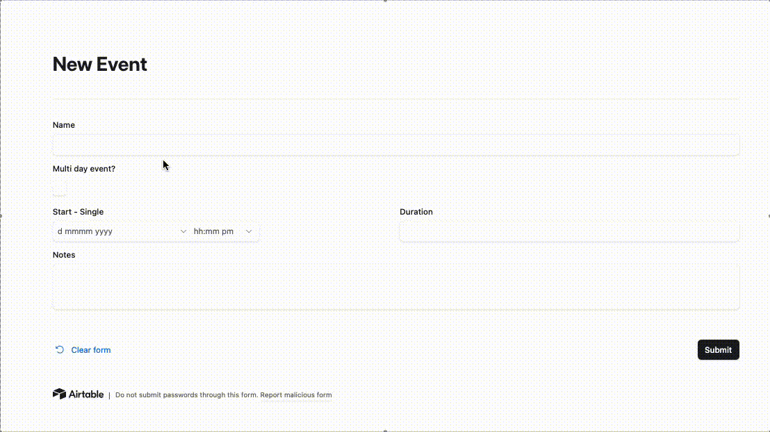

Hm, how this is set up depends a lot on how you want your users to be keying in data, really.  My take on this involves using specific fields for a multi day or single day event.
  1. Single day
    1. Start date
    2. Duration
  2. Multi day
    1. Start date
    2. End date
(We can use another ‘End Date’ field for the single day instead of a Duration field too)
And we’d use the ‘Multi day event’ checkbox to make the relevant fields visible in the form.  I’ve set it up here for you to check out.   This way the single day events allow for selection of a start time, and the multi day events only have dates
And here’s how the data looks after submission:
