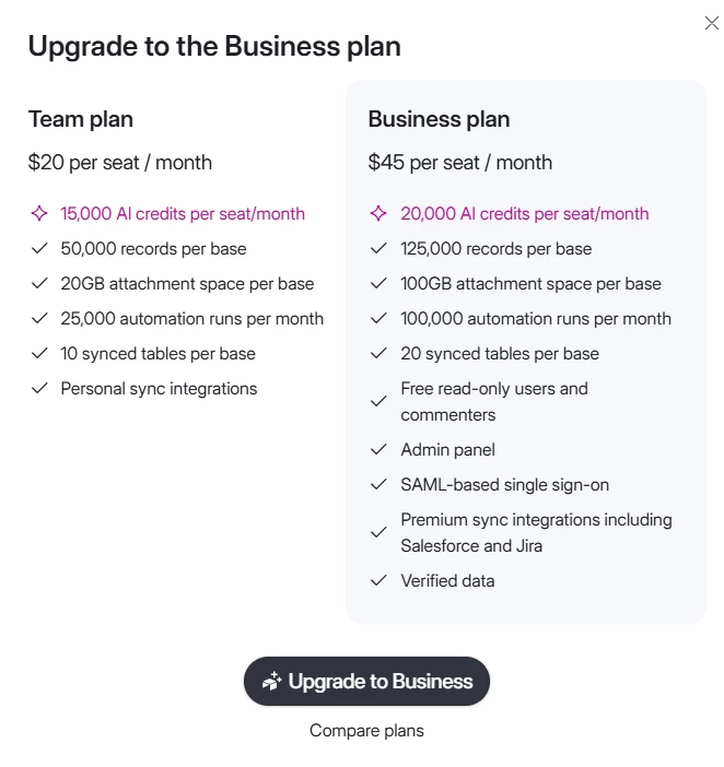

​@0800-grizzly It is available for team plan too. You will see a section called “Rules” on side menu, and under “Rules”, “Visibility”...

  • March 31, 2026
​@coderkid, it is not available on the Team plan. Here’s what I get when clicking the visibility switch.
