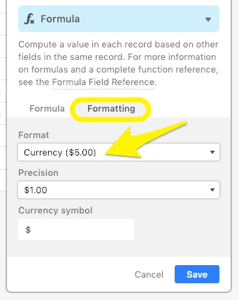

If the output of your formula is going to be a number, you can use the formatting tab in the field customization menu to do this—just switch the Format from Integer to Currency.
If the output of your formula is going to be text rather than a number, then you will not be able to use the formatting tab in this way (this might be the case, if, for example, you’re concatenating the value from a currency field with a value from a text field). However, if you’re just performing mathematical operations on a value from the currency field, this shouldn’t be an issue.

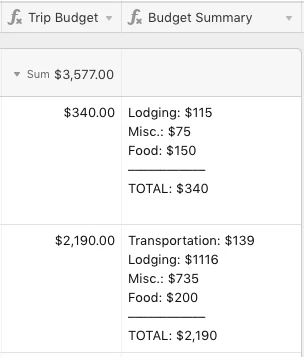

@Katherine_Duh if you’d like a use case, here’s a shot from my table that sorely needs such a function:
To keep my table a little cleaner/legible, I combined 5 Currency fields into one column using a formula in the {Budget Summary} field. However, this means the formula needs to include the 774 character snippet (which in reality would be longer to handle decimals) featured above for each number.
The CURRENCY() function could operate just like DATETIME_FORMAT() does and would only make formulas less cluttered

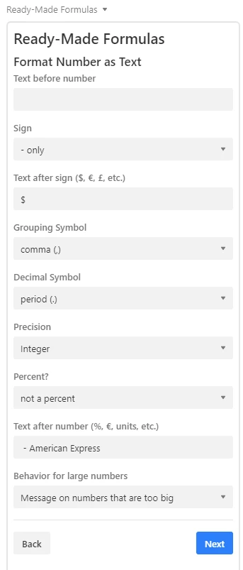

+1 this request - I’d like this for a formula so that the field that displays in the calendar view of my budget is something like $20 - American Express
  • July 6, 2021

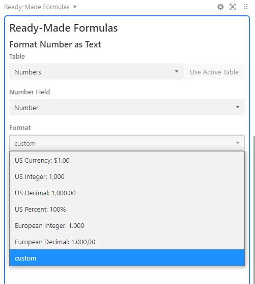

My app Ready-Made Formulas will generate a formula that does this. You can pick from several different common formats, or you can choose a custom format.
For a custom format, you can enter a currency symbol, how many decimal places, and several other options.
This formula does require a premium license, but it saves a lot of time versus finding and implementing less robust formulas on the internet. Plus, one license grants access to all the formulas in the app for one base.
