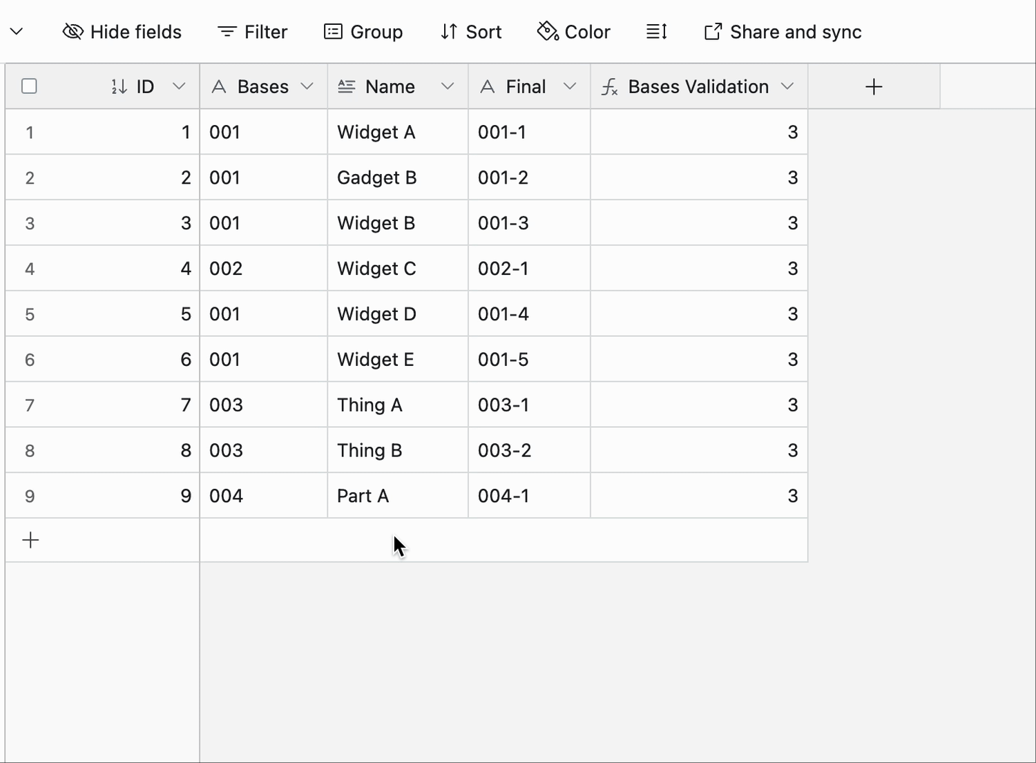

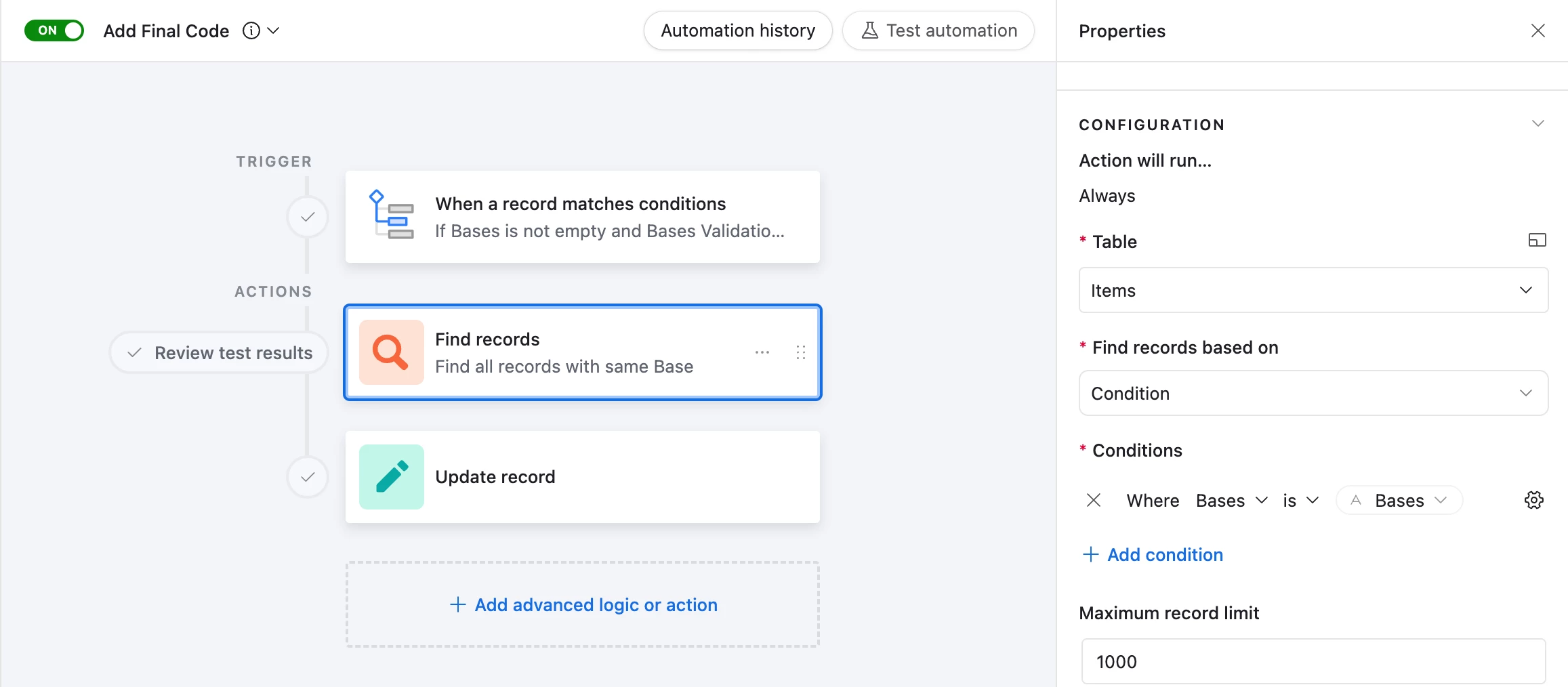

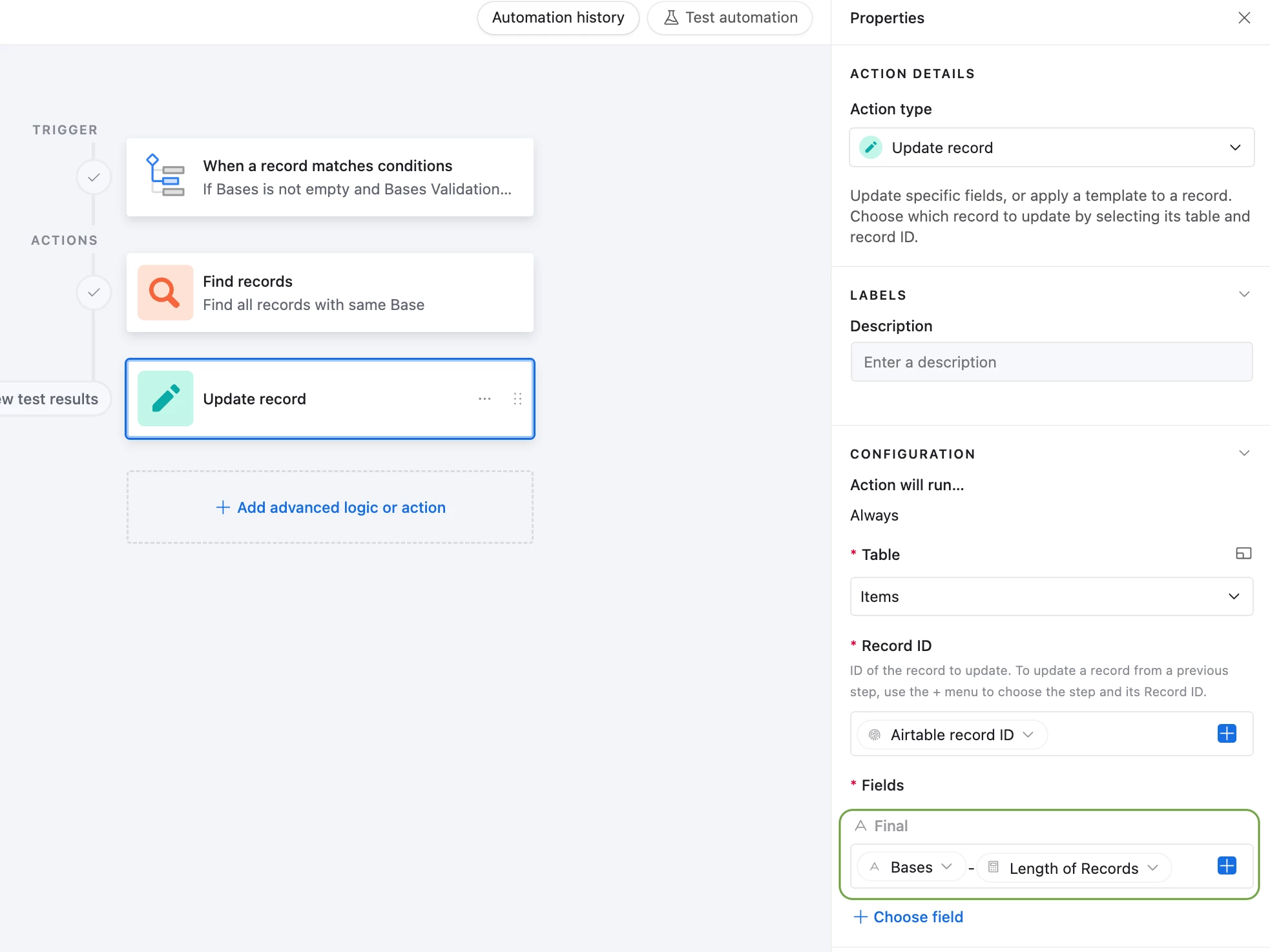

After experimenting with both the formula-based approach (using SUBSTITUTE + string manipulation) and another method of counting linked records in a separate base table, I’ve found that leveraging Airtable automations can simplify the process. The original SUBSTITUTE-based solution is clever and works great, but it involves linking all records to a “control” record or table, which may not feel intuitive for some users.
What Worked Best for Me:
A Single-Table Setup Using Automations:
By setting a trigger that fires when a record is fully ready (e.g., once {Base Code} is entered and confirmed for expected char length etc), the automation finds all other records with the same base code and updates the new record with a permanent, incremental code. This removes the need for complex formulas, record linking, and multiple tables.
Why I Like This Solution:
  • Simplicity: Avoids complex formulas like ARRAYJOIN and SUBSTITUTE.
  • Maintainability: Adjusting an automation is imo easier than modifying formulas.
  • User Experience: Team members simply fill in a required field, and the numbering is handled automatically.
Downsides:
This solution will consume some monthly automation runs and may introduce a short delay (a few seconds) before the final code appears.
