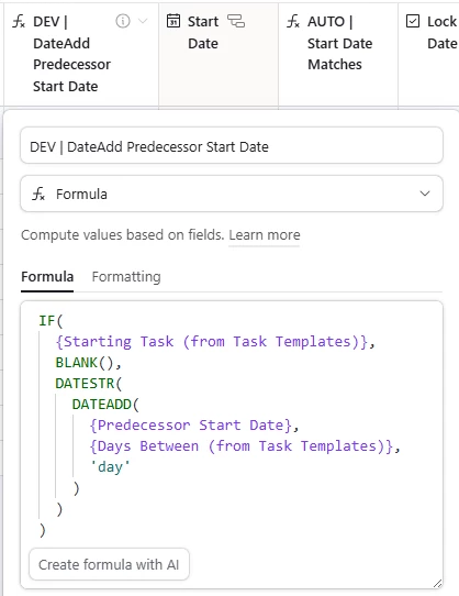

I have a formula that looks up the start date from the predecessor task and adds the appropriate number of “days between” to generate the expected start date for each task (called “DEV | DateAdd”). This requires a date in the Start Date field for the first task in the sequence (marked with the checkbox and called to this table via lookup field). Once the first one is added, the dates trickle down correctly in this formula field. However, I need all my start dates in the same column (Start Date) for (1) ease of use and (2) so I can use the Timeline view in my interface.

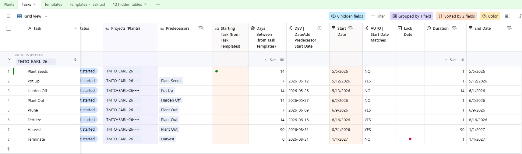

Task List Grid View
DEV | DateAdd formula

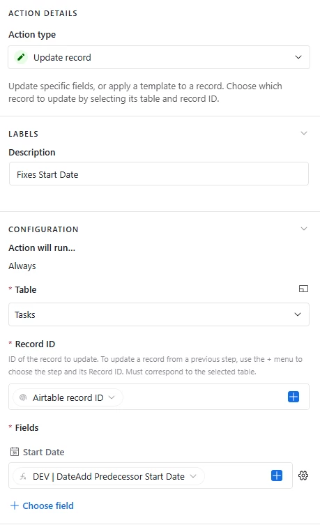

Rather than having to go retype every date in the Start Date field, I want to create an automation that just takes the date from the DEV | Date Add field and puts it in the Start Date field. I also want the Start date to update automatically if I change any of the dates in the column, and I want to lock certain dates (like final termination date for the season) so they don’t change once they’re added. In theory, this should be fairly simple, but it’s returning some odd results and I’m having trouble figuring out what I’m doing wrong.

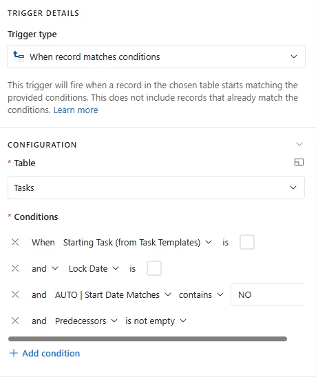

Automation Trigger
Automation Action
It originally tried to enter the DEV | Date Add value for the starting task, but that’s always going to be blank, so it caused an error. Easy fix: add a condition to the automation so it doesn’t run on that record.
Then it was causing a strange loop where it would just constantly redo the fields, changing the dates to something that appears random because the math ain’t mathing. So to try to fix that, I added a formula called “AUTO | Start Date Matches” to check if the DEV | Date Add field matches the Start Date field. It returns a simple YES or NO. I changed the automation to only run if the check formula returns NO for a field.
Now, it’ll change the dates correctly once, then immediately change some of them to random dates that don’t match the DEV | DateAdd field or honor the automation set up. Then the automation just stops and leaves things incorrect, even if the check field is NO and the dates aren’t honoring the formula. It’ll even change the start task and tasks with locked dates, which it shouldn’t be doing at all. You can view the automation in action here. And here is a copy of the base: https://airtable.com/appmZMKUT1WpuHan2/shrHAcDvikePeSCxm.

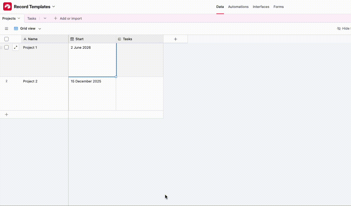

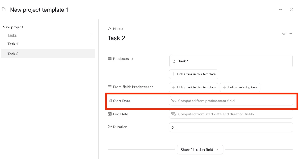

I’ve set up a base here for you to check out.  In the screenshot below you can see Task 2 has a predecessor of Task 1, and its Start Date is automatically calculated based off Task 1’s data
And here’s how it looks in action:
I do free half hour calls and would be happy to jump on and do a screenshare and troubleshoot if you’d like, and you can grab a time here!

Looks like this is an Airtable automation re-trigger problem.  When your automation updates Start Date, that field change can trigger the automation again on adjacent records.  Your YES/NO check slows it down but doesn’t fully stop it, especially when multiple records update in quick succession and the formula recalculates mid-run.
Something worth trying:
First you can try adding a condition to skip records where Lock Date is checked, it looks like the conditon may not be fully configured yet based on what you’re describing.
Next you can consider restructuring the trigger a bit: instead of “AUTO | Start Date Matches contains NO”, try triggering only when the DEV | DateAdd field itself changes.  This makes the trigger more specific and reduces the likelihood of it firing on records that were just updated by the automation.
