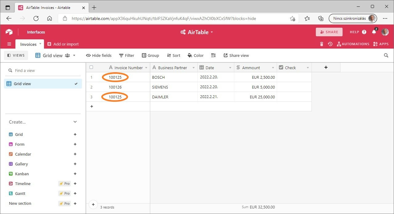

Hello!
I want to list duplicat records within a table in a view so we can check them.
I found this, this would be good for us, but I don’t realy know how to make it work in the automation:
I did some automation, so it’s not new to me, but maybe not as complex like this.
Best regards
Attila

Hello Alexey!
Thank you for your tip.
You might be right, but I don’t understand to to a 100%.
If I share my demo AirTable with you, could you make it there work?
This way I would have a “spare” tabel, right!? Not sure I want to see such a table all the time…
Would an anotmation be much more complex?

Hello Alexey!
Ok, I tried and I might get your idea, but this works only if I copy some row from my table into the new column, right!?
If I want this “notification” of duplicate record also at new records, do I have to input data also into the new column?
Best regards
Attila
