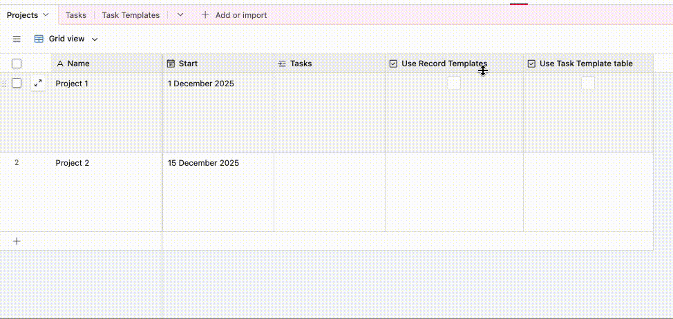

Does the same thing as Task Templates but without the extra table and will let you do relative dates based off of the original record too which is nice, and I have an example set up here
In the example below, Task 1 is set to start on the same date as the ‘Start Date' value, while Task 2 is set to start 3 days after ‘Start date’
