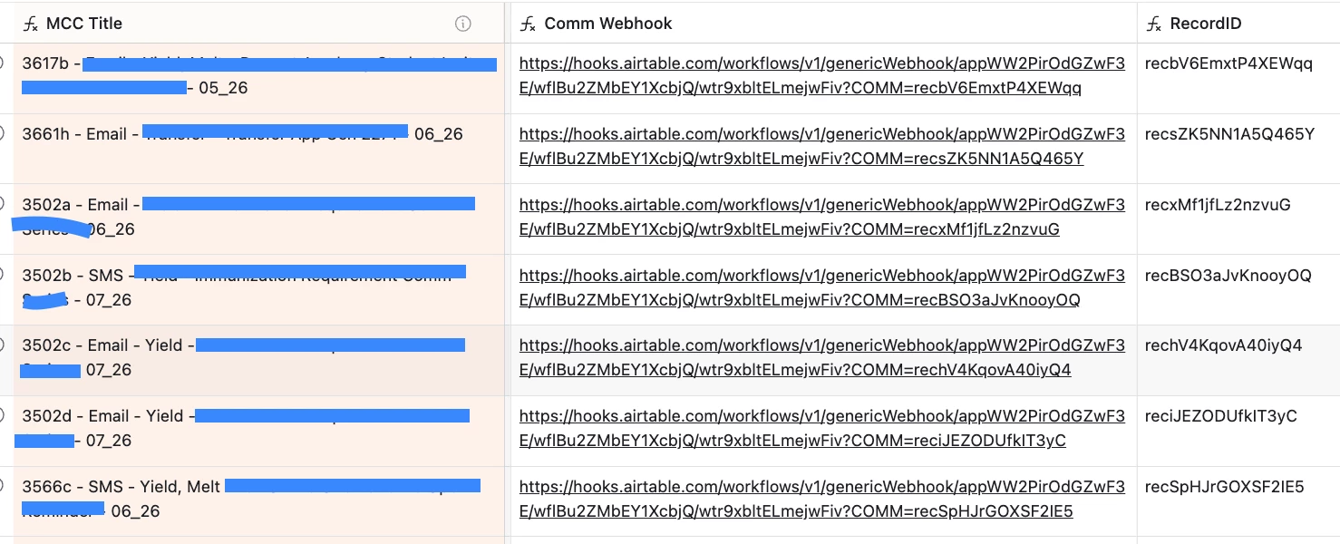

Hi everyone!
I’ve been trying to use Webhooks for a while to create a simple link that will allow my University’s Data Team to click a link to let us know that a query has been created. The Data Team will not use Slack either, so I’m basically trying to do an Actionable Message, but automating sending an ‘actionable’ link through our Microsoft Teams Channel.
I have the Webhook examples below.

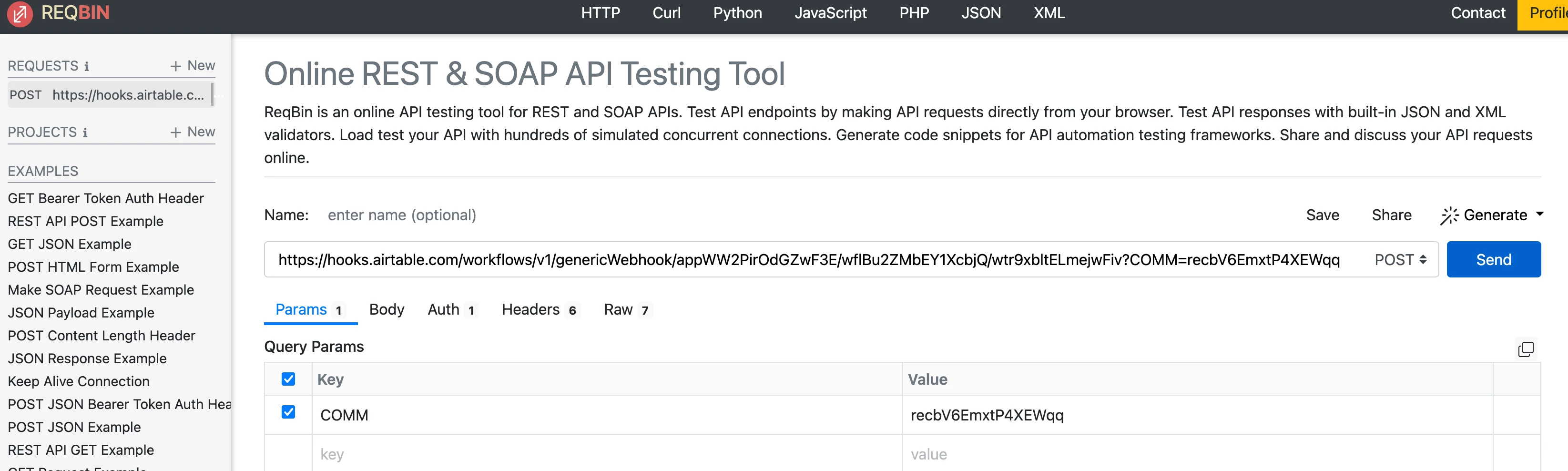

The formula automatically generates the RecordID into the Webhook so that when it is sent, the RecordID appears in the Params. However, I can’t get that information to go into the Body, so I am not able to use the RecordID in my “Update Record” automation.
(AirTable recommends using ReqBin for webhooks/testing, so that’s what I’m in)
With University Guidelines and permission issues, I am only able to do this through AirTable and not any 3rd party tools. Do you have any suggestions on how I can do this?
Thank you!

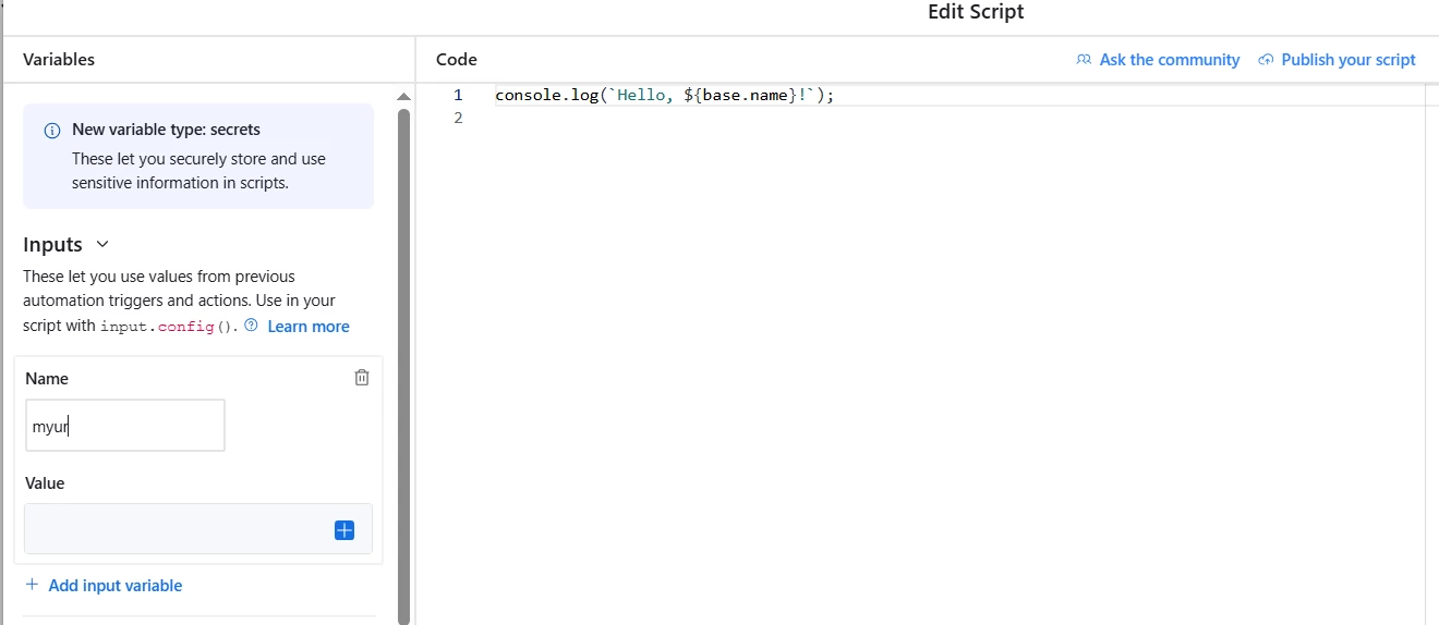

​@pittmarcomm I know JavaScript very well and use it a lot in automations. But in this case, it won’t help you because Airtable’s “When webhook received” trigger is only giving us the visibility on request body and not the query parameters of the url. I’m not sure what their reason is but technically it isn’t a big thing. Maybe they want to keep the webhook trigger super simple.
Anyway, the next best option is what ​@TheTimeSavingCo described.
PS: If Airtable gave visibility on query parameters, the JavaScript needed was just a couple of lines to get the record id from your url as following:
In “Run a Script” automation step, first you would have provided the complete url as input with following code:
const url = input.config().url;
const comm = new URL(url).searchParams.get("COMM");
output.set("COMM", comm ?? "");

Thank you very much for this, Anmol! So in order to use this in my automation, should it be a Trigger of “Webhook Received” still, and then I do “Run a Script” right after before the rest of the steps? Can I then put my dynamic field of “Comm Webhook” in there, which formulates the exact Webhook for each record with the identifying RecordID in the URL?
If so, where/how do I put “Comm Webhook” into the script you sent?

​@pittmarcomm Yes, trigger would be “Webook Received” and then “Run a Script” step.
To provide your dynamic variable from previous steps as an input to a script, there is an option of providing inputs into a script on the left panel of a script.
However, all of this is hypothetical because currently Airtable is not providing the URL that was hit :(
