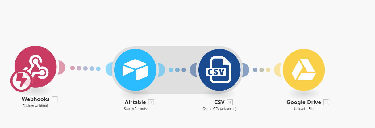

@ScottWorld, after watching one of your videos, I set up a Make scenario to automate a csv export from an Airtable view:
I used the CSV "create csv advanced" module and it works fine.

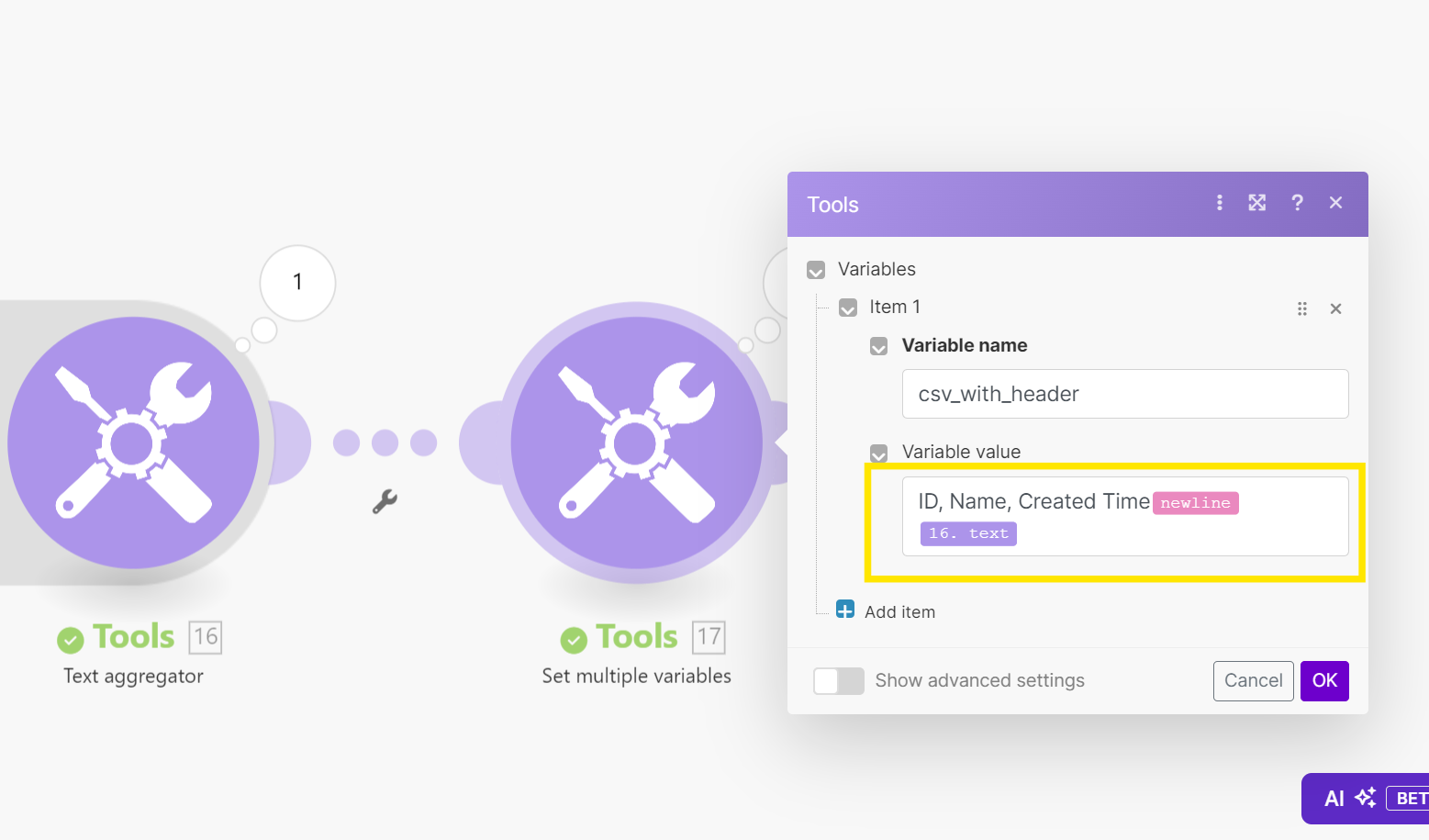

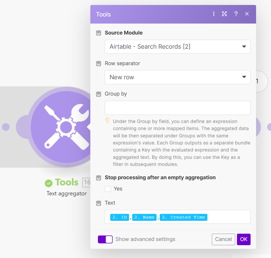

While you use Make there are lots of options but in your case.
Try to use Text Aggregator and then set up a variable for headers of csv.

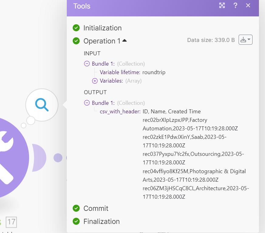

Output
You need to make sure to use your all variables and give a proper header if it's required.
Another important thing is that most CSV are surrounded with "(quotes) because sometimes the comma(,) is used within some of the values and at that time all csv goes messed up. So you need to remember this.
