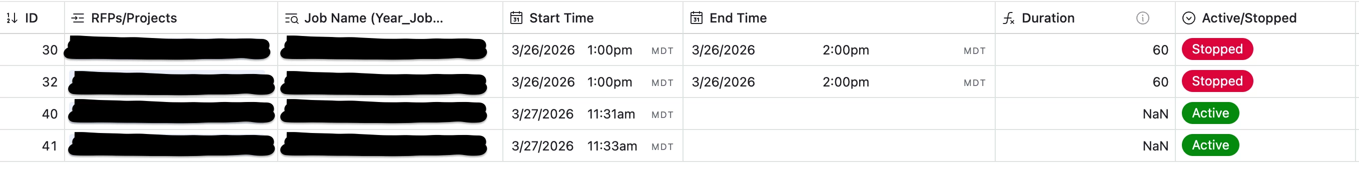

Current Table

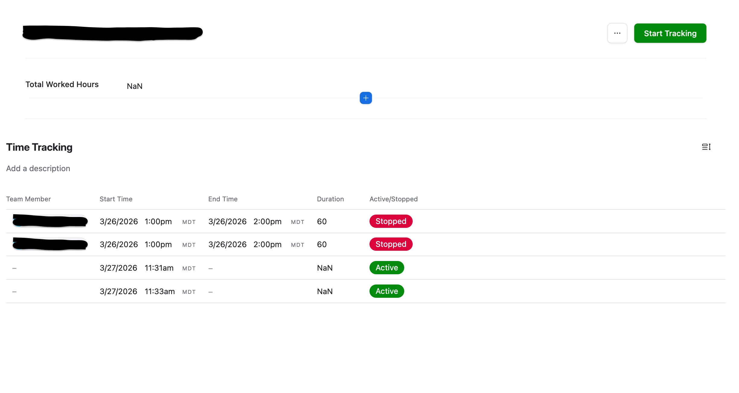

Current Interface View

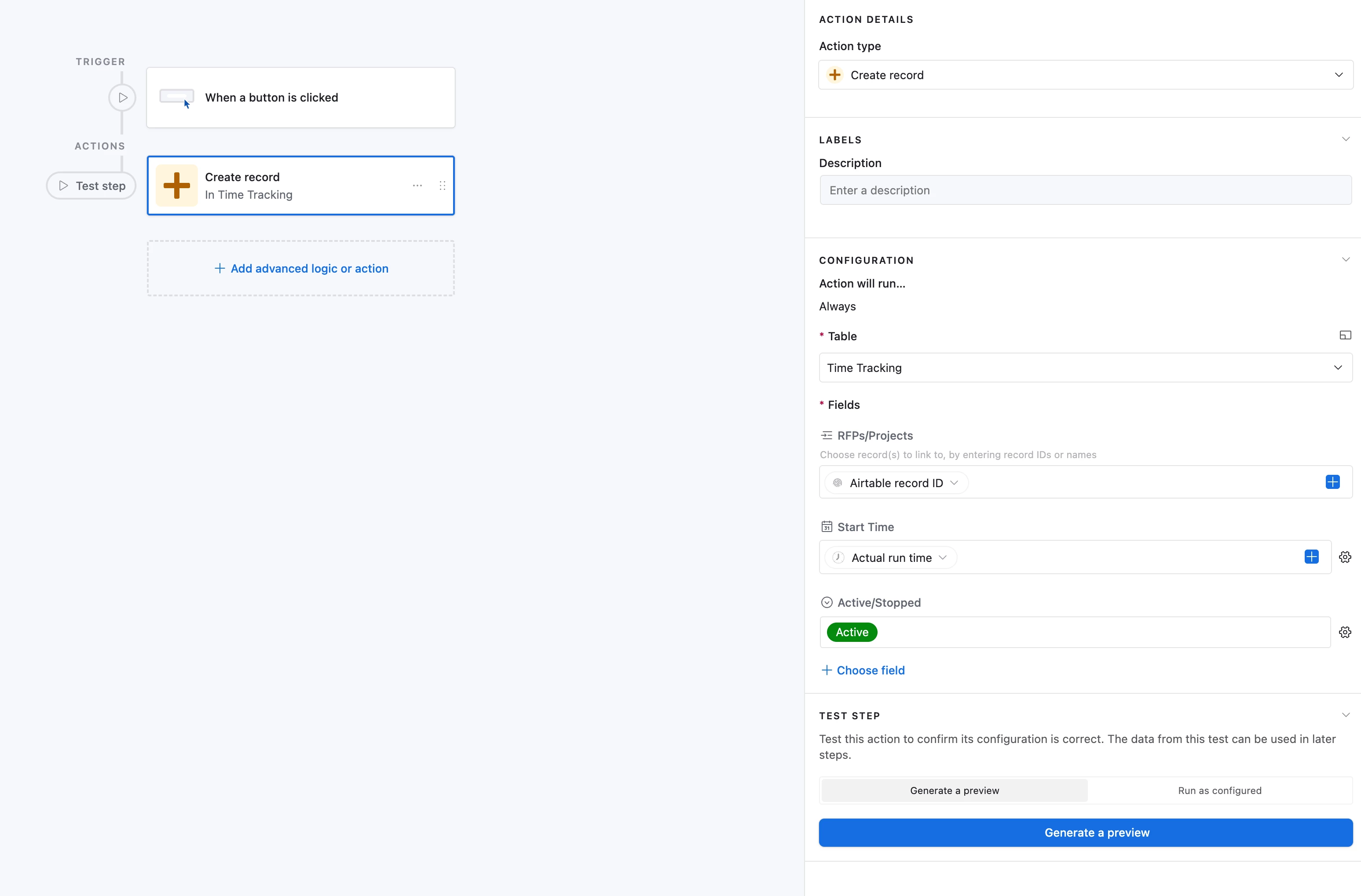

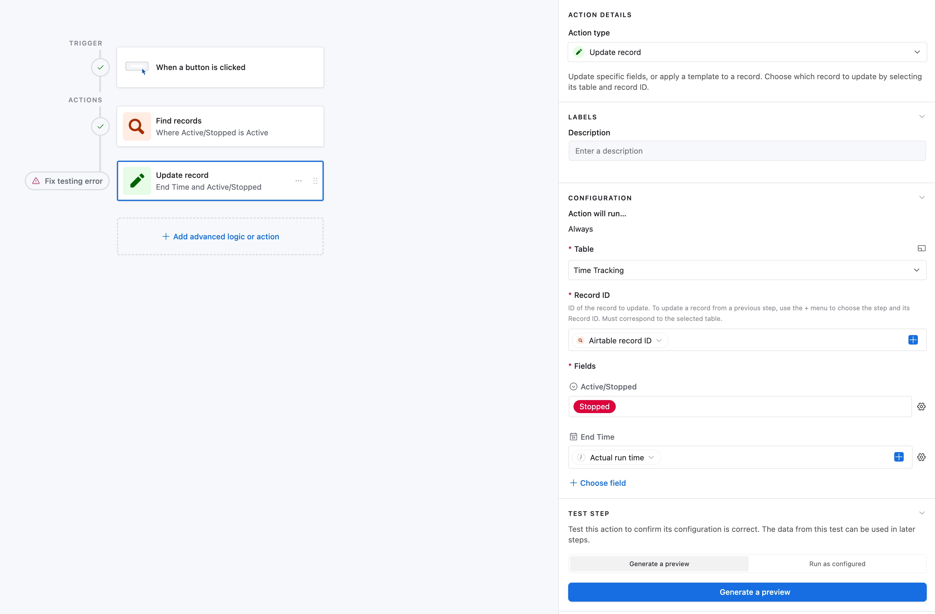

Current “Start Tracking” button Automation
Current “Stop Tracking button Automation step two … unsuccessful
This is my current table, interface and automation set up to try and create a time tracking interface. I am stuck on the “Stop Tracking” button automation. I can’t seem to be able to update the “End Time” field with the current time when the stop tracking button is pressed.

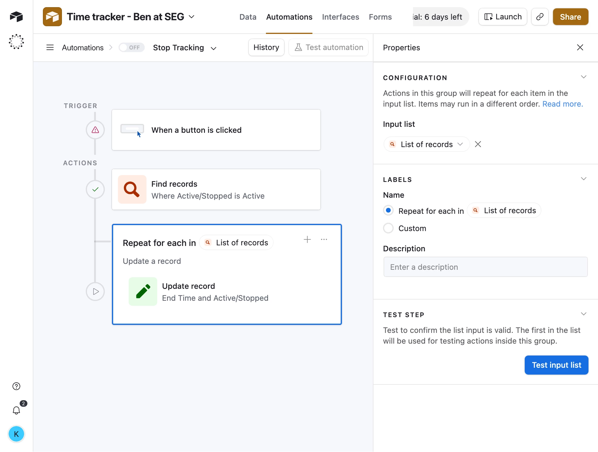

I think the problem is that the “Find Records” action of the “Stop Tracking” button automation returns an array, and you need to wrap the “Update Record” action with a “Repeating Group”
  • Mar 27, 2026 7:32 PM UTC
​@coderkid Could you explain further and/or share a solution for this automation? Thank you
coderkid
Forum|alt.badge.img+7
  • Mar 27, 2026 8:00 PM UTC

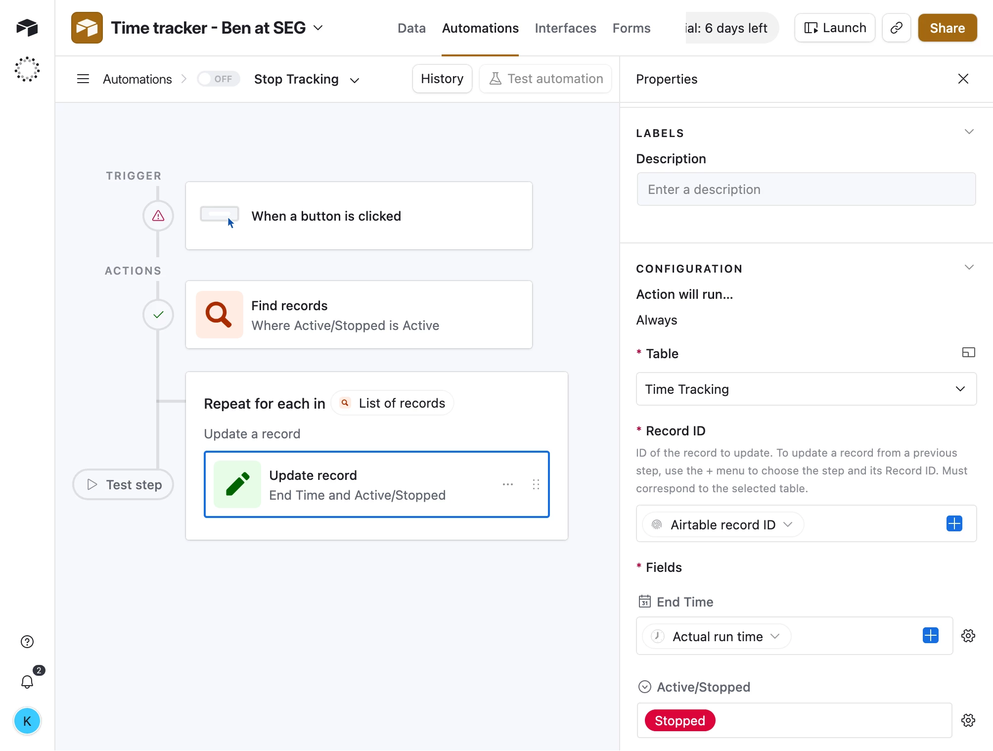

Since search may return multiple records;
Update the records, inside the loop :
  • Mar 27, 2026 8:17 PM UTC
​@coderkid Awesome! This works, thank you.

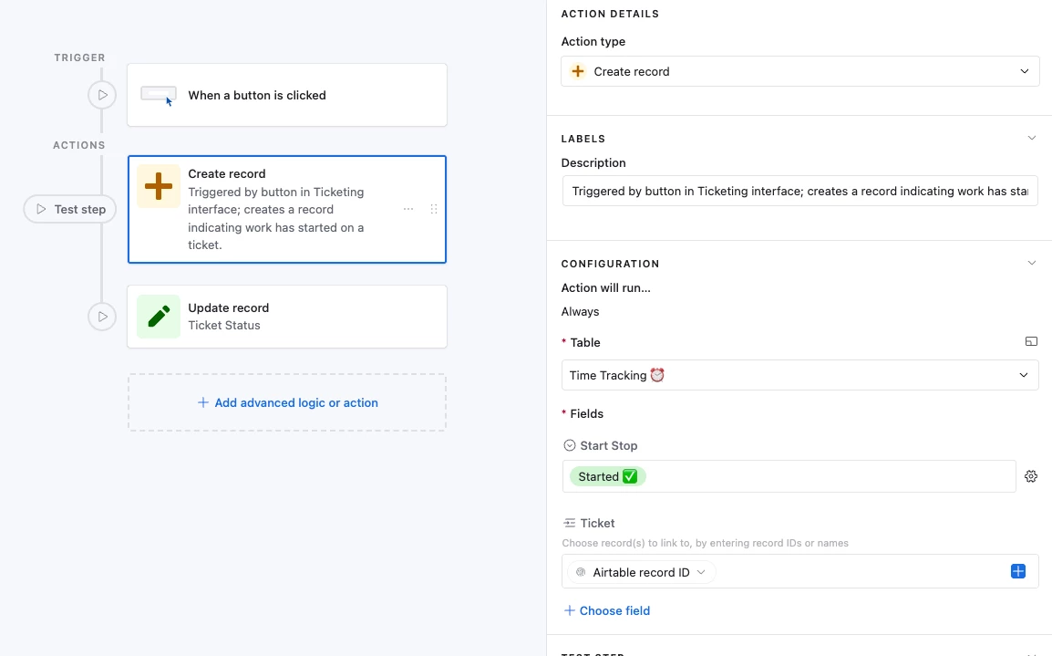

I have an interface that’s tied to a “Tickets” table. Once I pick which ticket to work on, I can click a green “Start Tracking” button that triggers an automation. The automation creates a record in a separate “Time Tracking” table and updates a single select ‘Start/Stop’ field to say “Started.” It also automatically links the time tracking record to the Airtable Record ID from the Tickets table. (It also runs an Update Record automation to change the ticket status to “In Progress”.)

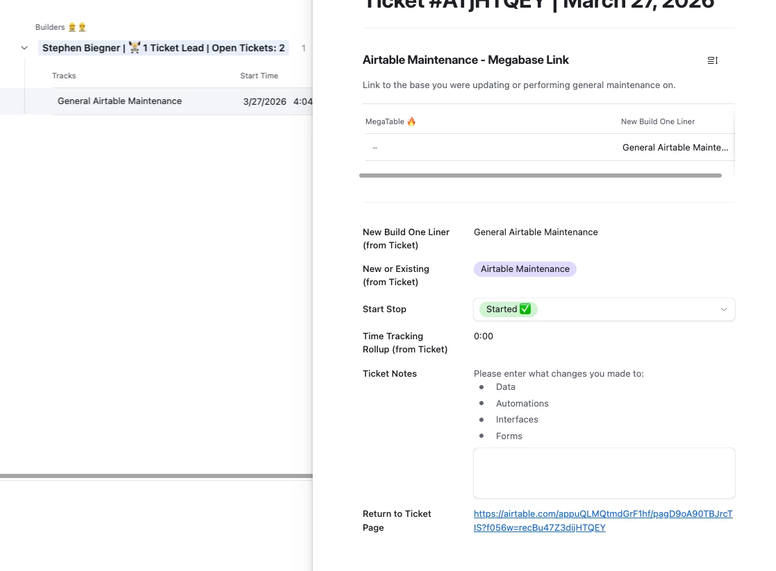

When I’m done working on a ticket, I click a red “Stop Tracking” button in the same interface, and it takes me to a new “Time Tracking” Interface. This interface uses the Time Tracking table as the source. I jot down notes documenting what I worked on, and then I toggle the Start/Stop single select field to “Stopped.”

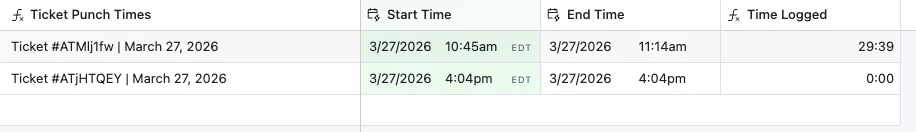

In the time tracking table, I have a “Start Time” field which is simply a Created Time field tracking when the record was created. I also have an “End Time” field which is a Last Modified Time field tracking when the Start/Stop field is updated (i.e. when I switch it to “stopped”). Finally, there is a formula field calculating the difference to show the total time logged. To keep track of multiple punch-ins/outs against a single ticket, I have a Roll-up field calculating the sum of all punch-ins logged to that record.

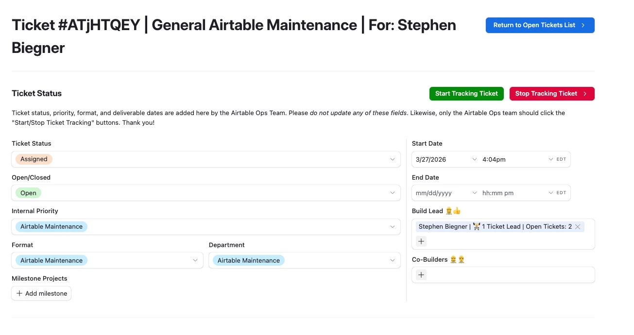

The green button runs an automation to create a Time Tracking record; the red button next to it takes you to a time tracking interface to log notes and punch out.
In the expanded record view, I can add notes, toggle the Start Stop field to “Stopped” and this will be tracked in the “Last Time Modified” field in the time tracking table.
Here’s the automation that creates the record when the green “Start Tracking” button is clicked.

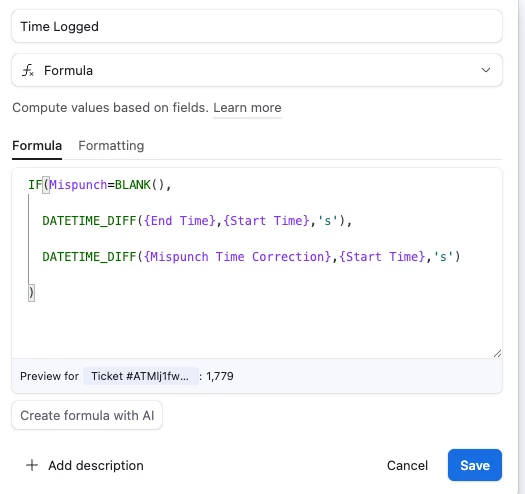

Quick screenshot of the created time field (Start Time), last modified time field (End Time - watching the Start Stop field), and the formula field calculating the total time logged.
Here is the time logged formula. Note - I did add the ability to indicate a mispunch in the event myself or a colleague forgets to punch out which this formula takes into account.

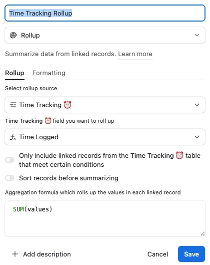

Finally, back in the Tickets table, I have a rollup field that looks at all linked records and provides a sum of the values of the time logged field.
