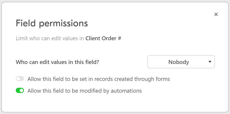

I’ve managed to get something similar to work by using the “Find records” automation to look for all the related records, for example “Project 1”, and then updating the field with that value
Consider:
Your table already has two records associated with “Project 1”
You create a record associated with “Project 1”
The automation looks for all records associated with “Project 1” and finds 3 records
The automation updates the record that triggered the automation run with the number 3, which you can get via the length value of the find result
You then create a record associated with “Project 2”
The automation searches for records associated with “Project 2”, and finds 1 record, i.e. the one that was just created
The automation updates the record that triggered the automation with the number 1
Let me know if you end up looking into this and have questions
