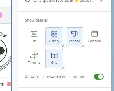

WHAT IS A "PAGE" Really: What counts as a page in the interface is not simply the list of pages when you go to "add page". Instead, any page that also uses multiple ways to view that page, counts as a page (see image).
Example: You have a Page for viewing contacts. Your default view might be "List View". Great that is one page. However, you may (inside that page) include different ways to view that same data. You perhaps select, Calendar view, and Grid as well.
Well, now you are apparently using 3 pages according to Airtable.
Be aware of this everyone, as it isn't explained anywhere and Airtable support, unfortunately, couldn't seem to understand when I explained it to them and I had to figure it out on my own through troubleshooting.

To clarify one point in some of the earlier posts, using different visualisations (e.g. a List and a Grid and a Calendar) on one page does not influence the page limit. No matter the number of visualisations used, that still only counts as one page.
