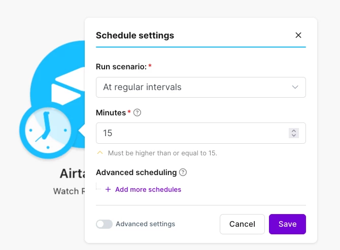

This is pretty much your only choice I believe.  Note that your polling schedule will also count towards your credit usage even if there’s nothing new, and so if you’ve got it set to 15 minutes that’ll cost 2.8k~ish credits a month (might be fuzzy on the math here!)
The other way to trigger things on Make is to hit a webhook, and you can do this either via a Run a Script action in an automation (which defeats the purpose of what you’re trying to do here) or a manual click by the user
Generally you would only use this for stuff you’re comfortable running in the background that doesn’t need a quick response time, and on a paid plan you can reduce the scheduling interval (with commensurate credit usage)
Zapier also does scheduled polls while looking at a view but doesn’t charge for them, and so depending on your usage the math might work out for using Zapier instead even though it’s more expensive
