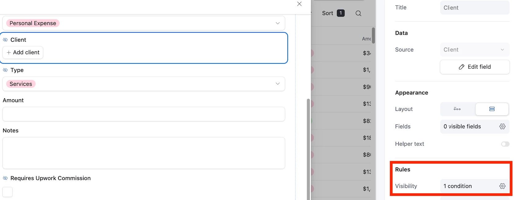

Hey ​@KR956, I’m not sure I am 100% following but you will probably want to take a look at the visibility rules set for the fields that are being conditionally shown on your form. See screenshot below.
Is this helpful? Otherwise please provide further detail!

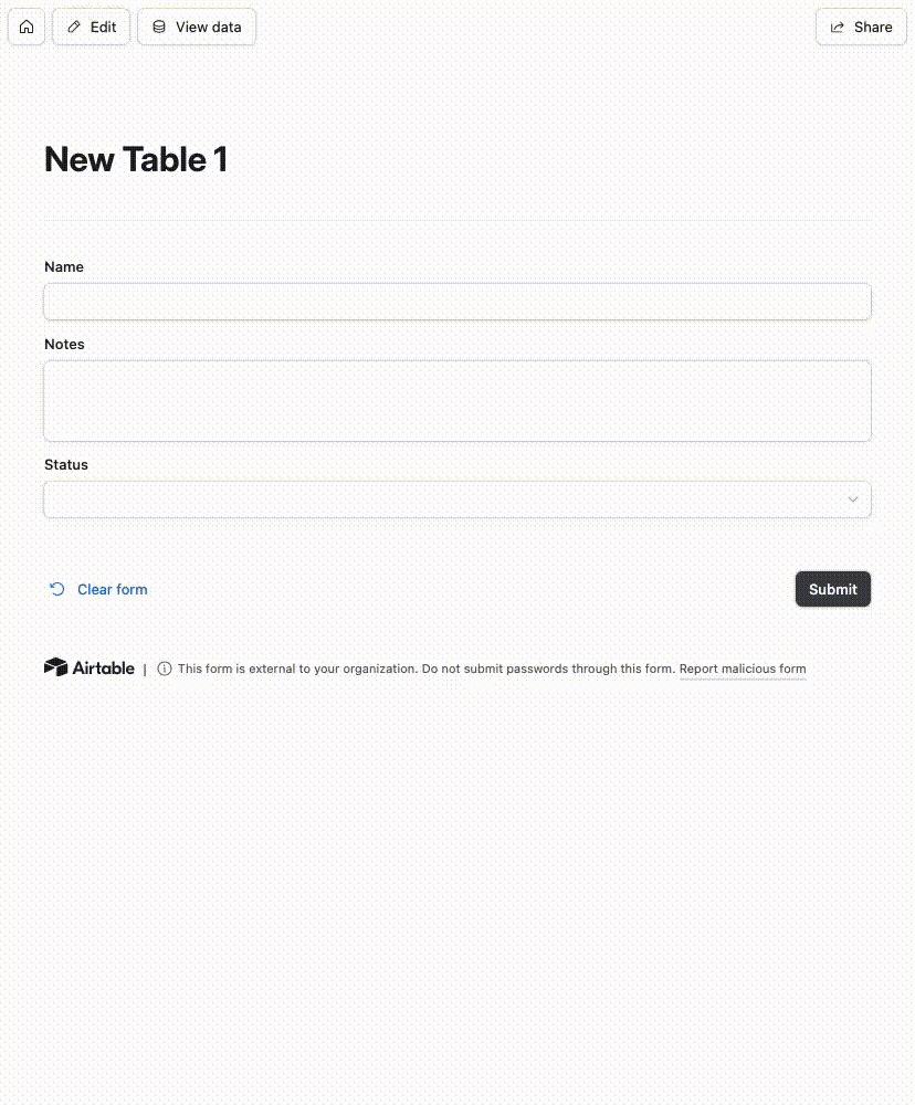

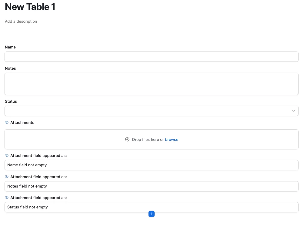

If you don’t mind cluttering up your base with a ton of helper fields you could do this natively!  (You should probably just use Fillout lol)
I created one field per possibility and gave it a default value to explain why the Attachment field was visible, and as you can see at the end both fields popped up:
Form setup:
