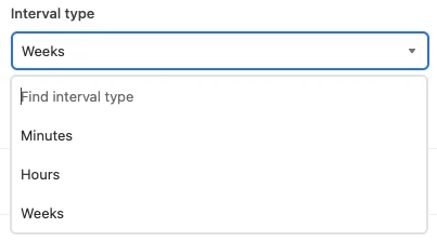

We just released an update to the “At a scheduled time” automation trigger. Updates include:
  • Ability to select a start date/time for when the trigger should start firing
  • For the weekly interval, you will now be able to specify the # of weeks it should reoccur in (used to be only every week)
Our updated support documentation covers all of the new functionality!
