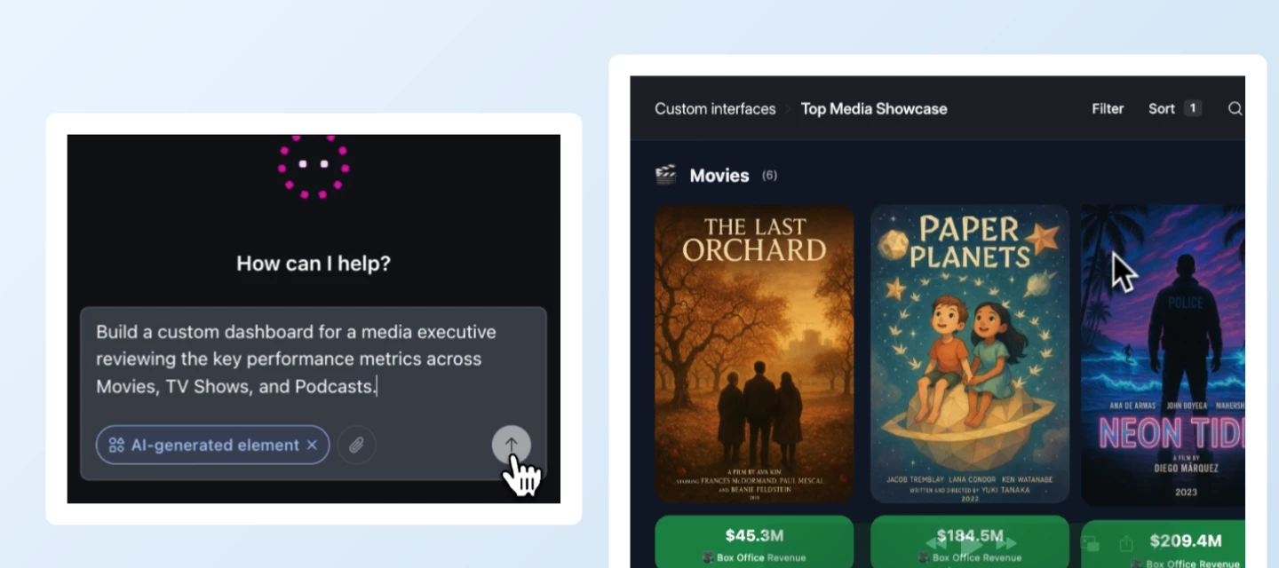

Building on the recent launch of AI-generated interface elements, we’re excited to announce that custom interface elements can now pull in data from multiple tables. This was the community’s #1 request since launch! This capability applies to custom elements created via Omni (AI Labs) or created through the SDK (open beta for Teams, Business and Enterprise Scale plans.)

Build fully custom interface elements to visualize, edit, and interact with your data in ways that go beyond standard Airtable components. Rapidly generate custom elements using natural language through Omni, or develop your own with code through our SDK, supporting a wide range of technical needs and skill levels.

AI-generated interface elements are available in AI Labs. Workspace admins can enable AI Labs from Account > Workspace Settings, while Enterprise admins can enable AI Labs from the Admin Panel. Once enabled, select “Tools” and then “Generate an Interface element” in Omni and describe the element you want to build. Reference the kinds of data (e.g. projects, tasks and teams) that you want to use in your element and Omni will help connect the element to the right tables.
