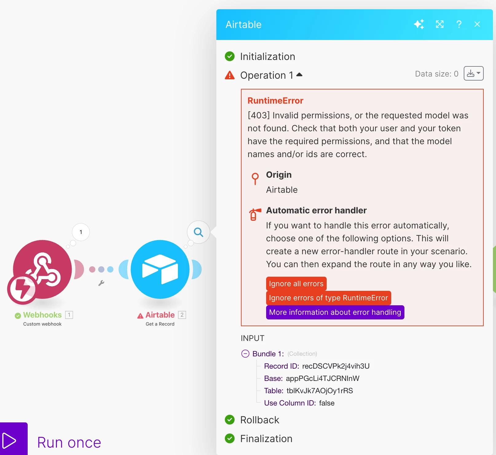

I am new to Airtable and Make.com… have tried to make 2 steps work for a month and it has not been working…
THE GOAL: What I am trying to do is to extract the transcript from a video file, so after I can produce a written article, a title for the article and the video, and a description for Mr. YouTube.

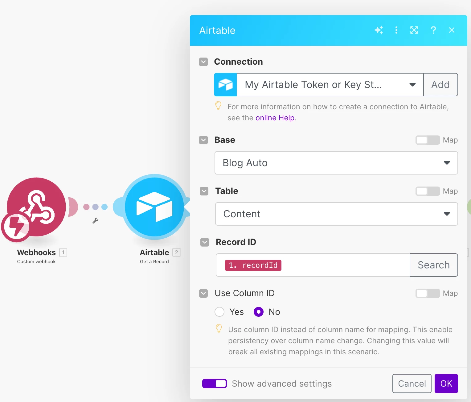

ERROR: Use Column ID: False or 403

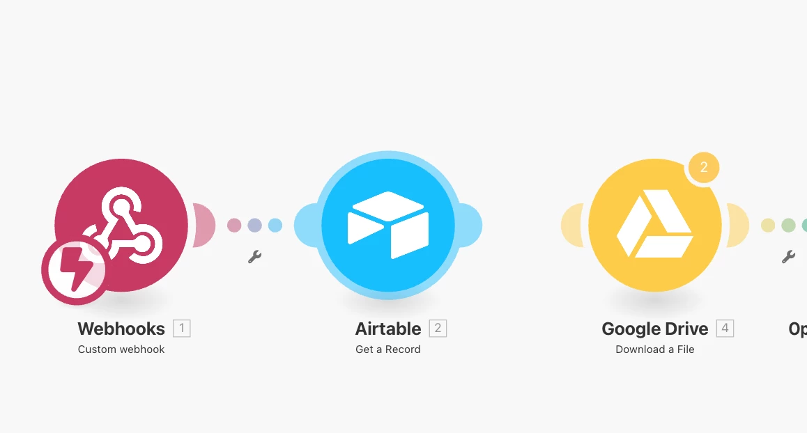

STEPS: (STEP 1: connecting with Webhook => OK). STEP 2: Getting a record from Airtable and put it into make to transfer the info into Google Drive (video transcript).
Problem in STEP 2

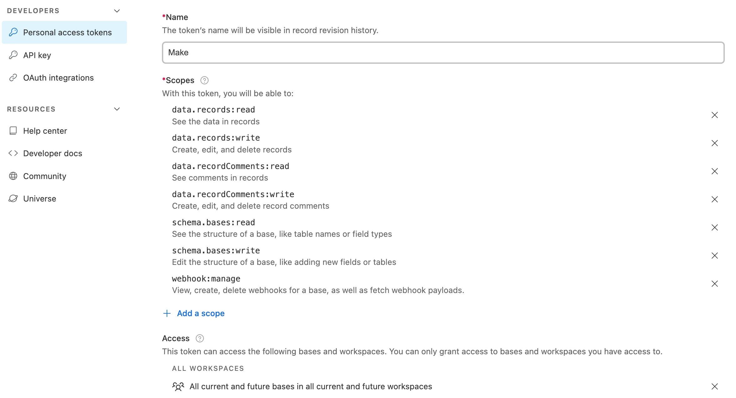

I have checked the names and IDs and I don’t know what I am missing. My administrator did the same operation and it showed the “Use Column ID: false”, but we didn’t have any problems or errors until now. I have re-written all the code, redone the tables and the whole process. Have updated all my permissions and the token on Airtable. I have 1 test record.
ID formula: RECORD_ID()
@ScottWorld @Olpy_Acaflo What can I do to solve this issue?

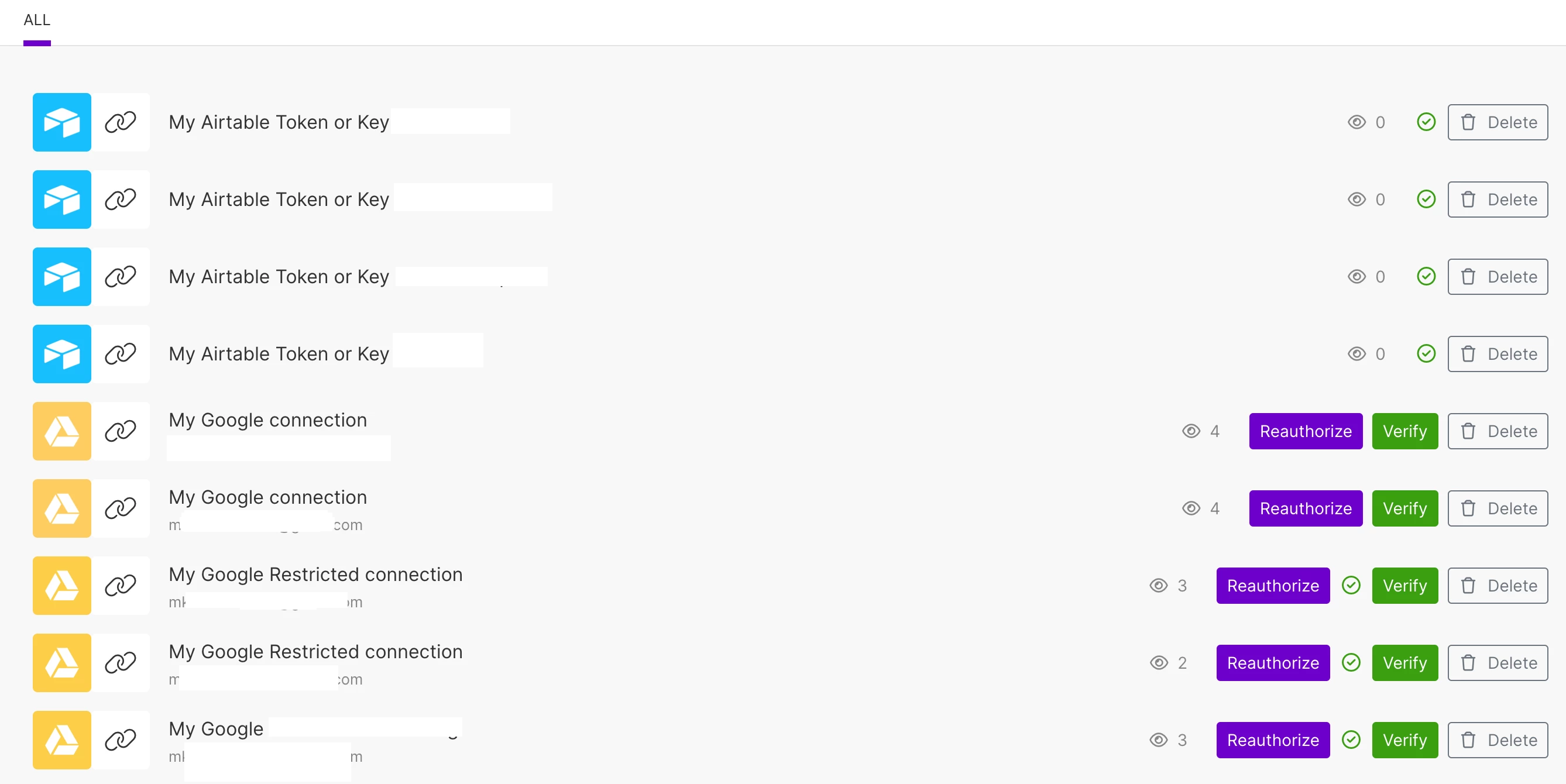

Hmm, you shouldn't need to deal with permissions / tokens at all actually, when you set up the connection in Make that's already handled for you when you grant access to the table
Does the connection you're using in this scenario work in any other scenarios?

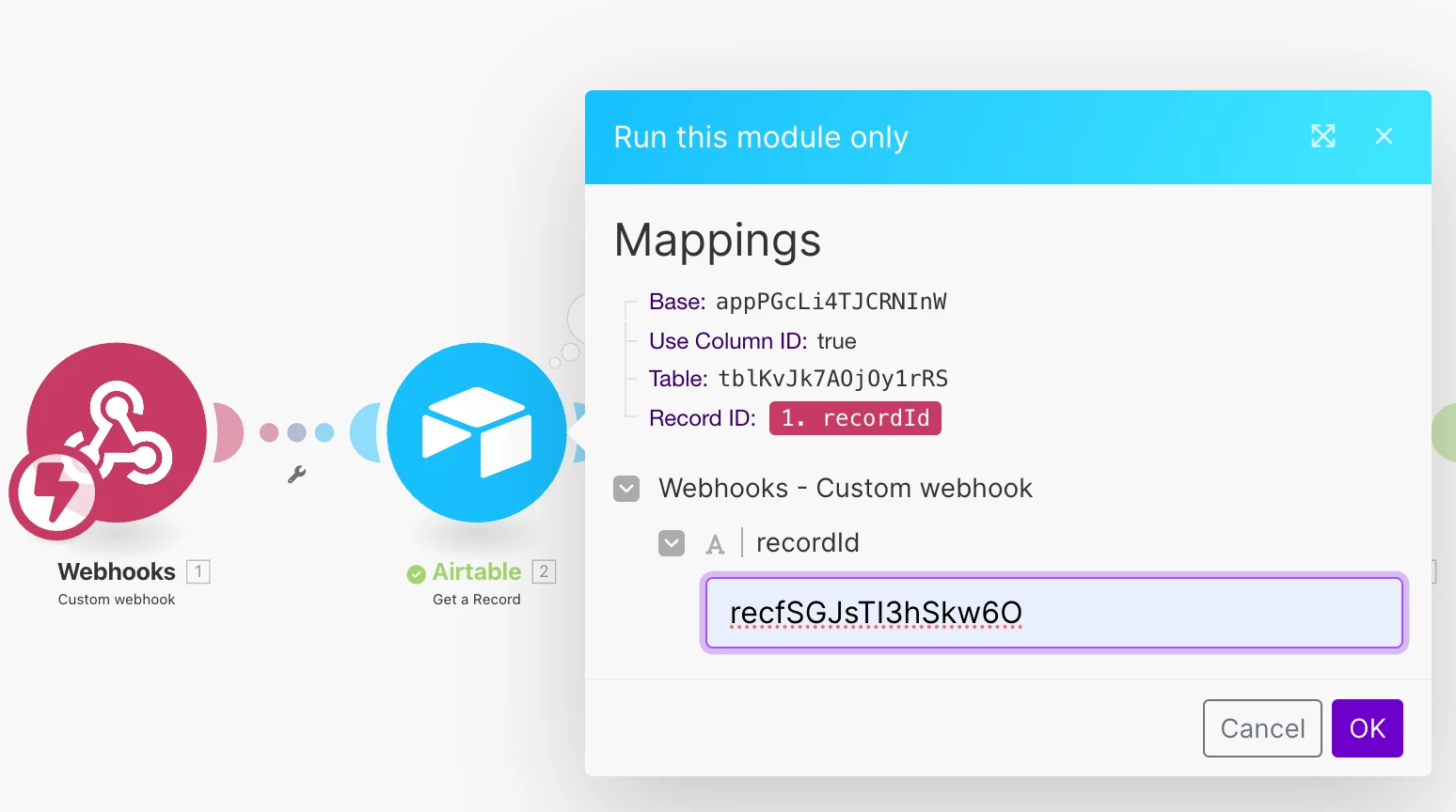

I think I got it... I had to put the RecordId manually along with selecting it in the pink fields. But I don't know why the "recordId" is not pulled automatically. Is this normal? If not, what should I do?

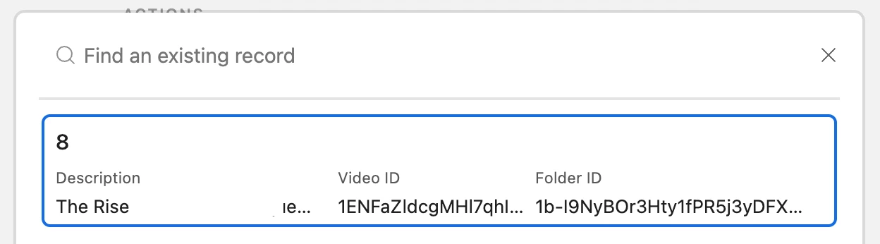

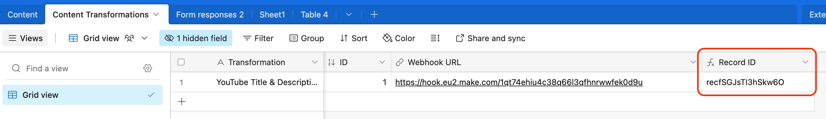

  2. Please see images for ID data.

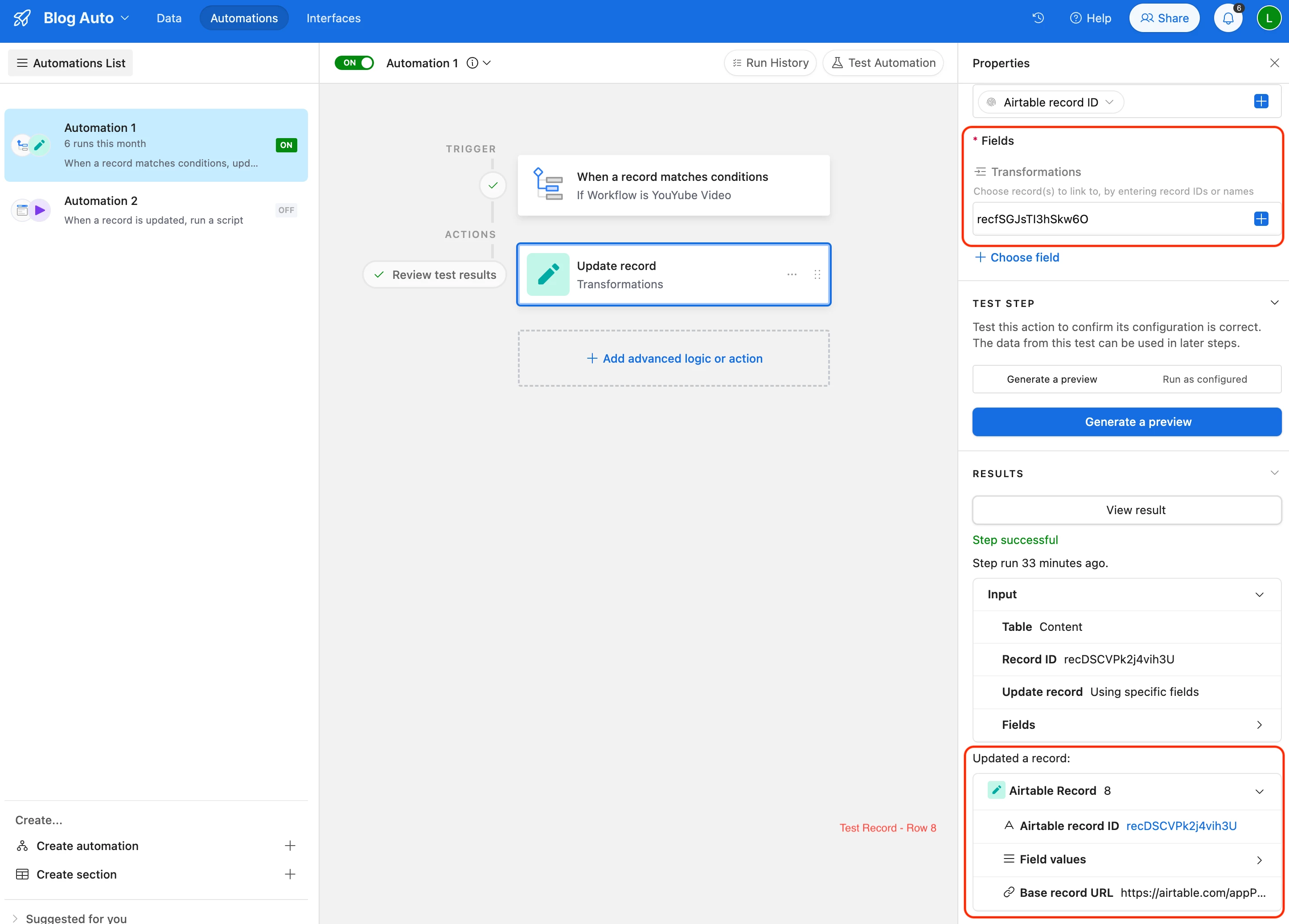

    1.  in Airtable's Automation #1: RecordID = recDSCVPk2j4vih3U
    2. in Airtable's Automation #1 + Airtable Record 8  : Airtable RecordID= recfSGJsT|3hSkw60
    3. in MAKE in step2 connection to Airtable: RecordID= recfSGJsT|3hSkw60
    4. in Table that connects with the webhook in Make: RecordID= recfSGJsT|3hSkw60

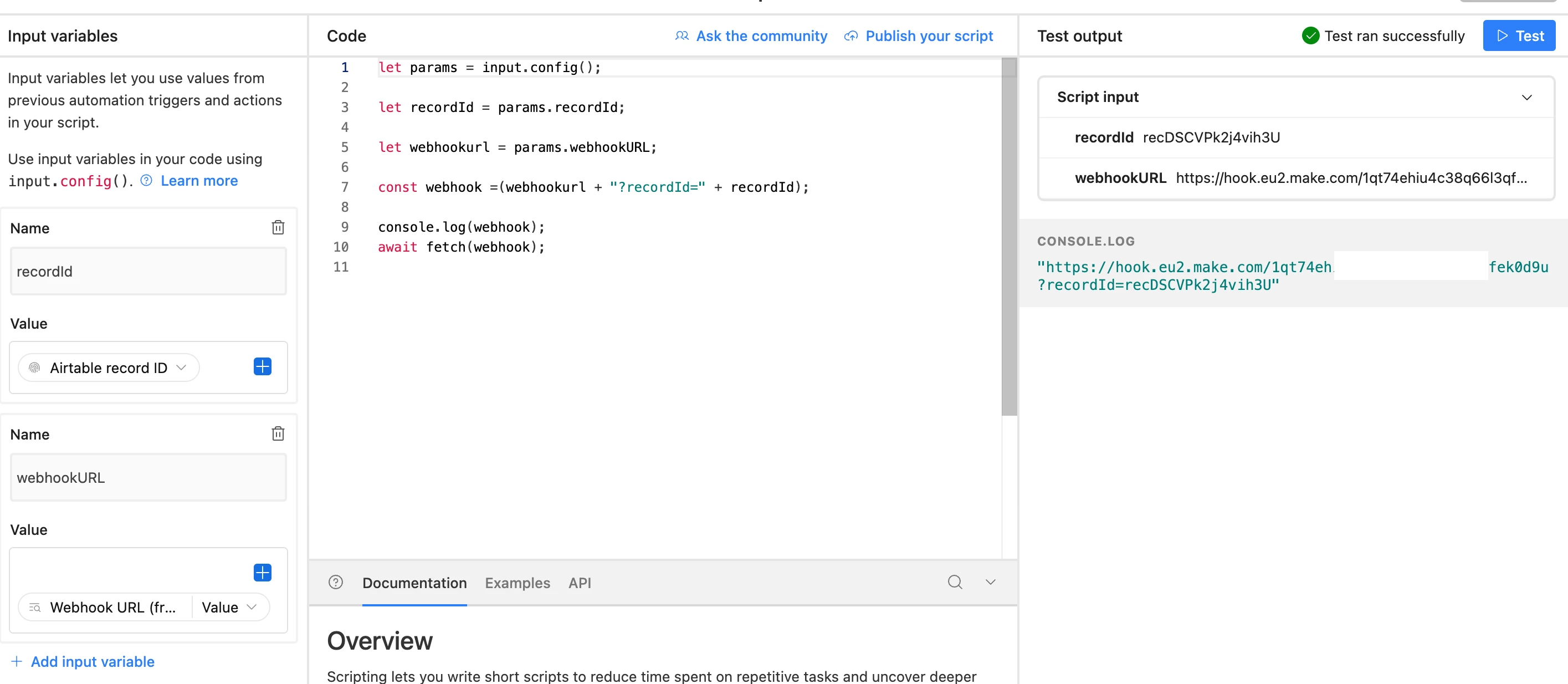

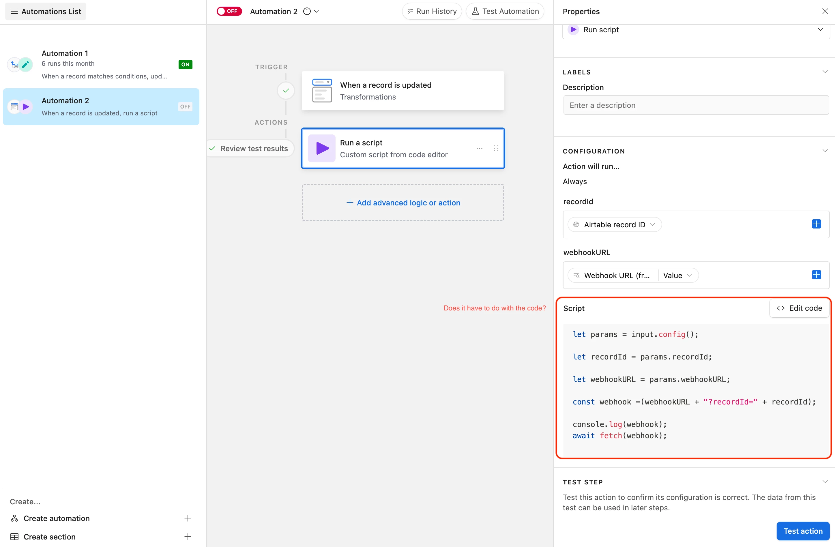

  3. Does it have to do with the code? I wrote it first the "recordId" so it would be autocomplete:
    1. (1) const webhook =(webhookURL + "recordId" + recorded);
    2. And later added the “?” and the “=“
    3. (2) const webhook =(webhookURL + "?recordId=" + recorded);

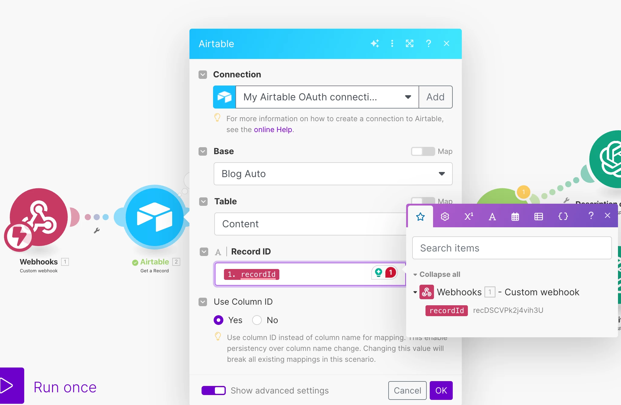

Questions: @Sachin_191
I am sorry but I don't understand where are the settings to avoid "Use Column ID: False" error, how to know for sure what is the schema in Make.com, I already tested with a sample record from row 8 (in images)
