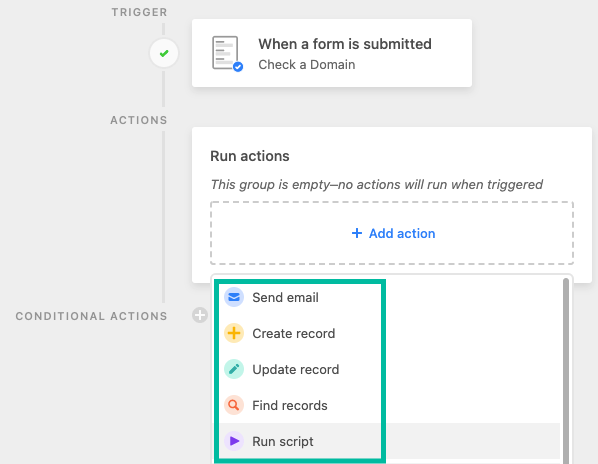

  • April 7, 2022
Adding to this. I’d also love to be able to automate a button execution. For example, if triggering a button was in this list my problem would be solved:
