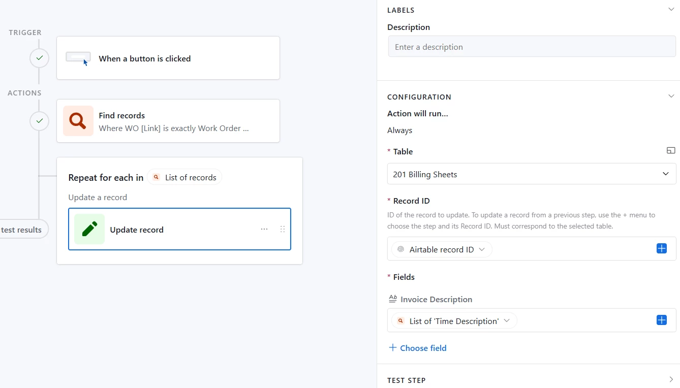

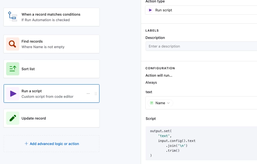

I have an automation that aggregates all the line items for an invoice - see attached image…
That works fine but I would like to have each item be on its own line. So somehow I need to be able to insert a break <br> presumably. Not willing to go to Make or Zapier for this.
How can I do this?

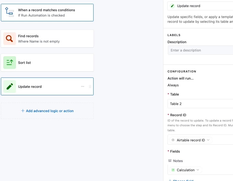

The automation will:
  1. Use a ‘Find Record’ step to find the records you want
  2. Sort them in the order you want
  3. Separate each value with a new line
  4. Update the original record with the new line separated value

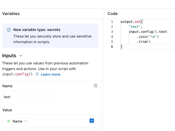

And here’s the script:
output.set(
'text',
input.config().text
.join('\n')
.trim()
Got the first part to work, but why does JavaScript add a comma?

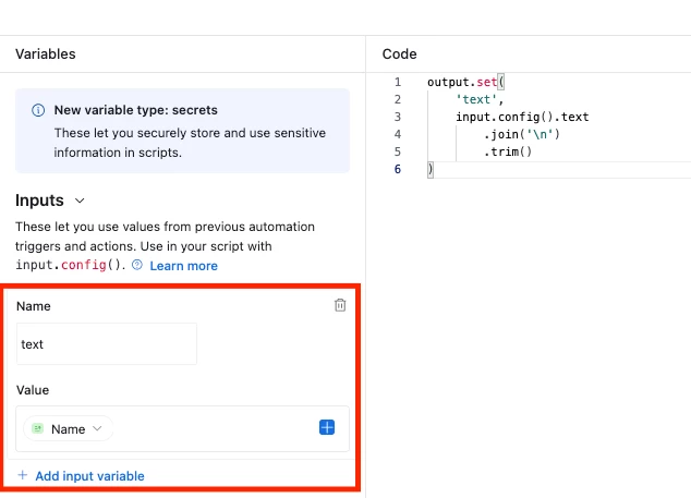

Not sure how to handle your code snippet. Don’t I need to get the field value and then update it?
Yeap, that’s what the script is doing!  We pass in the value in the left sidebar:

Hm, I just realized that if we want new lines without the comma and are okay with using a script then we don’t even need the formula field.  I’ve added it to the base as an automation called ‘No leading new line, remove commas’
You can duplicate it to your own workspace to view the settings more in depth!
output.set(
'text',
input.config().text
.join('\n')
.trim()
I take it you’re referring to the commas in red below?
1,
2,
3
If so, that’s being done by the ‘Find Record’ action
  • Jun 11, 2026 7:10 PM UTC
That works great. Thank you also for pointing out the variable input on the left hand pane - something that I was blind to previously.
