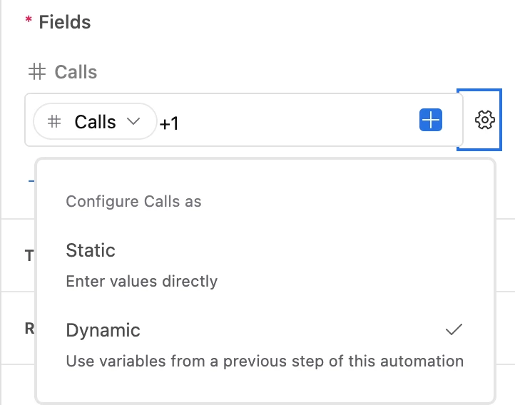

Seems like it should be relatively simple, all I want to do is use a button from an interface to add 1 to a number field in my table

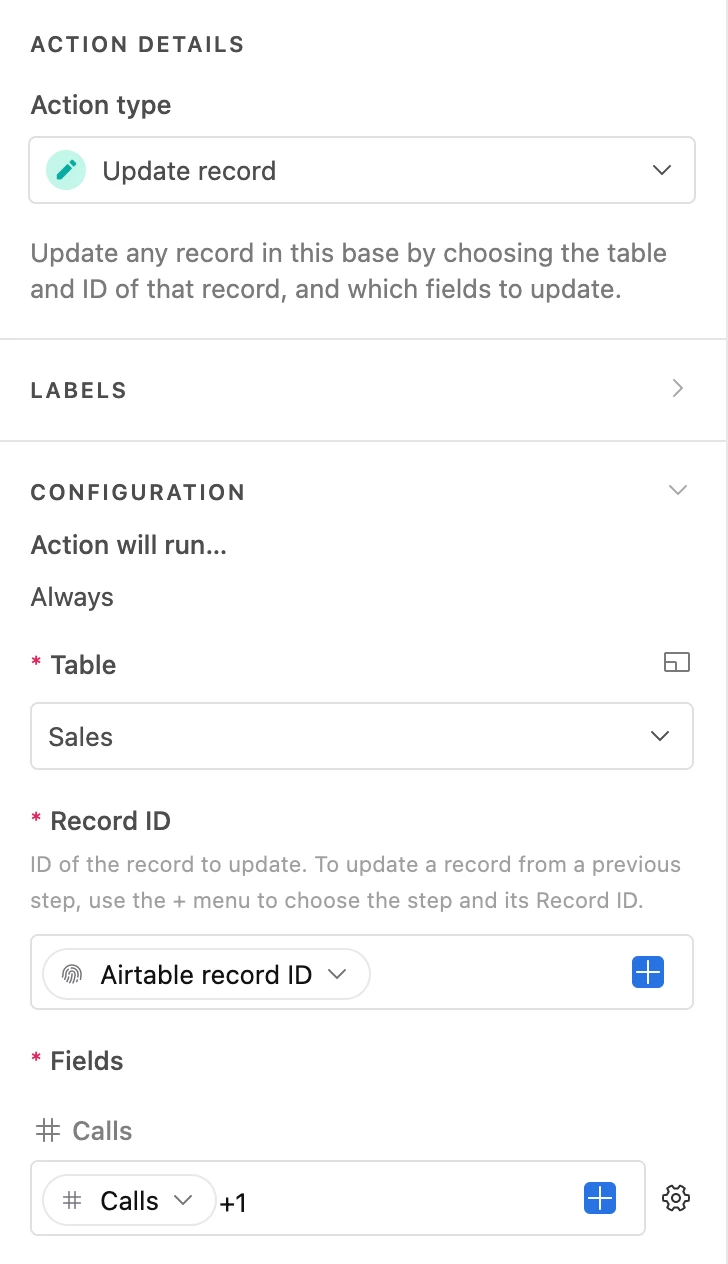

I'm using the button linked to an automation and here's what it looks like:
And this is using a dynamic update:

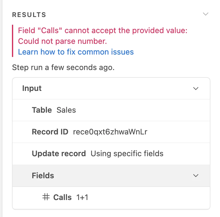

But here's what happens when I test this:
So I guess it's the wrong format, and I can't find any documentation on formatting for this. Seems like I can't even add two fields together.
So how would you do this?
I'm afraid you'll need a formula field specifically for this, with the formula being `{Calls} + 1`, and you'd get your automation to paste the value of that formula field into the "Calls" field
  • March 2, 2023
Okay thank you!
