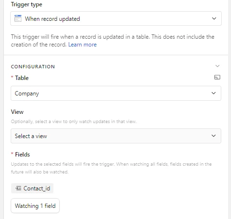

You can modify the trigger this way:
Hence, when a record is updated on table "Task assigment", Assignee (your linked field to Employees table) being the field to be watched.
This way, you make sure that mail address does exist when the automation is triggered.

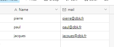

Table "Contact" is similar to your "Employees" table, with a mail adress for each person.

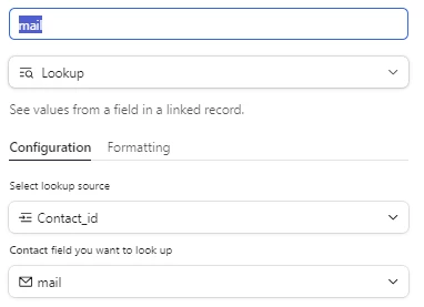

Field Mail is a rollup from contact table:

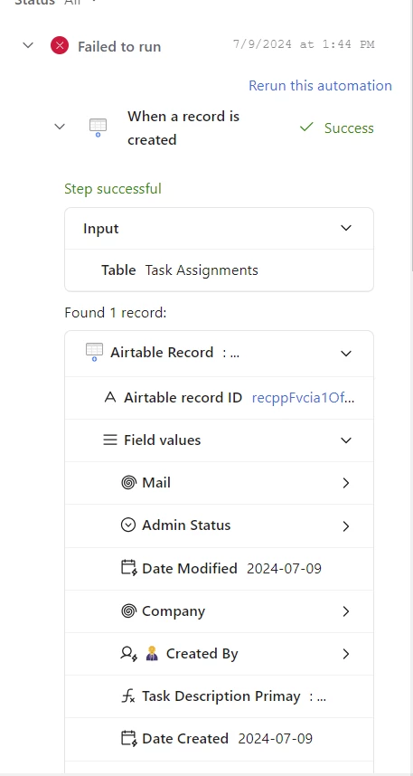

Hello Pascal, thank you for the quick response. I just added a rollup field and tested the automation. When I test the automation itself it works. But when I try to trigger it from adding a new task the rollup field is unavailable in the automtion. I will attach a ss for reference. I appreciate your help. Thanks

I have also tried the lookup field similar to what you have as "Mail" by adding a field "Assignee Email" from the "Assignee" field. But the lookup field is not available in the automation when I trigger it by adding a new task. Altough the automation works when I test it from the automation panel itself but the lookup fields are always empty when I try to trigger it from the Task Assignment table by adding a new row. Please let me know if you can guide me on this.
