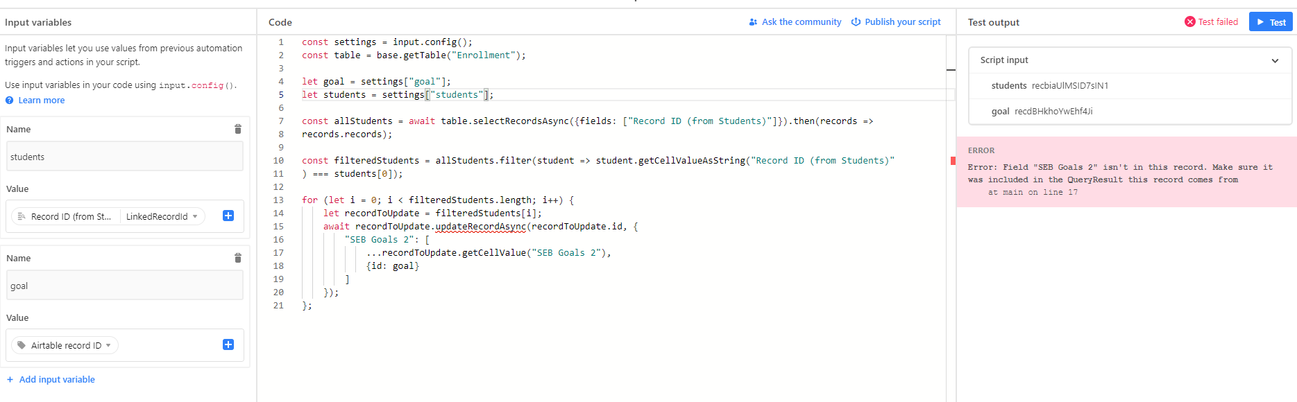

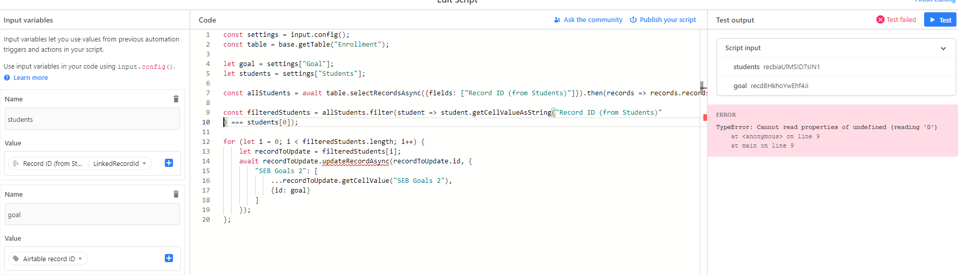

Hi Ben!  Thanks so much for help!  I tried each of your solutions. Here are screenshots of both. The problem is that as a beginner, I don't know what I don't know.  I see the error messages but don't know how to fix them.
  • February 14, 2023
Sorry, forgot to change to lower case.  Here's what it says now...

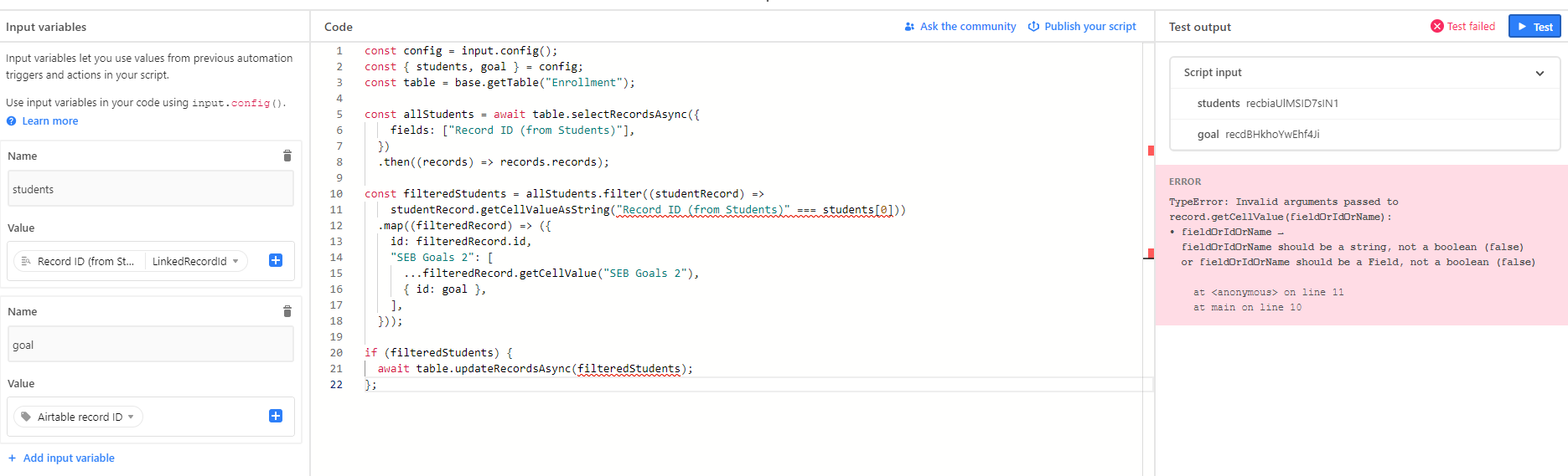

Whoops! I misplaced a parentheses in my original script it seems.
Here it is corrected:
const config = input.config(); const { students, goal } = config; const table = base.getTable("Enrollment"); const allStudents = await table.selectRecordsAsync({ fields: ["Record ID (from Students)", "SEB Goals 2"], }) .then((records) => records.records); const filteredStudents = allStudents.filter((studentRecord) => studentRecord.getCellValueAsString("Record ID (from Students)") === students[0]) .map((filteredRecord) => ({ id: filteredRecord.id, "SEB Goals 2": [ ...filteredRecord.getCellValue("SEB Goals 2"), { id: goal }, ], })); if (filteredStudents) { await table.updateRecordsAsync(filteredStudents); };
I'd be more than willing to write out an explanation of what we're actually doing with this script if you'd like!

It still throws
Error: Field "SEB Goals 2" isn't in this record. Make sure it was included in the QueryResult this record comes from.
I'd be happy to learn anything I can about this but want to be respectful of your time.
I think I follow most of what's happening but then I get tripped up in certain places. For instance, the
The error message throws me too since I know there is a field called "SEB Goals 2" in the "Enrollment" table.

It still throws
Could you just quickly confirm that your script contains this specific snippet:

  • February 14, 2023
If you confirm that this is in the final script, go ahead and try this and see if it still throws the error:
const config = input.config(); const { students, goal } = config; const table = base.getTable("Enrollment"); const allStudents = await table.selectRecordsAsync().then((records) => records.records); const filteredStudents = allStudents.filter((studentRecord) => studentRecord.getCellValueAsString("Record ID (from Students)") === students[0]) .map((filteredRecord) => ({ id: filteredRecord.id, "SEB Goals 2": [ ...filteredRecord.getCellValue("SEB Goals 2"), { id: goal }, ], })); if (filteredStudents) { await table.updateRecordsAsync(filteredStudents); };
If you paste in this entire code snippet, the editor is going to strikeout the selectRecordsAsync() portion of the table.selectRecordsAsync() call.
Despite this, the script will still run without an error. No need to worry.
And don't worry about my time!
I live and breathe Airtable. It's literally how I pass time.
You were right, it struck out that portion of the code.  However, this is the error now...TypeError: filteredRecord.getCellValue is not a function or its return value is not iterable
(filteredStudents); on the last line has been underlined red each time as well.

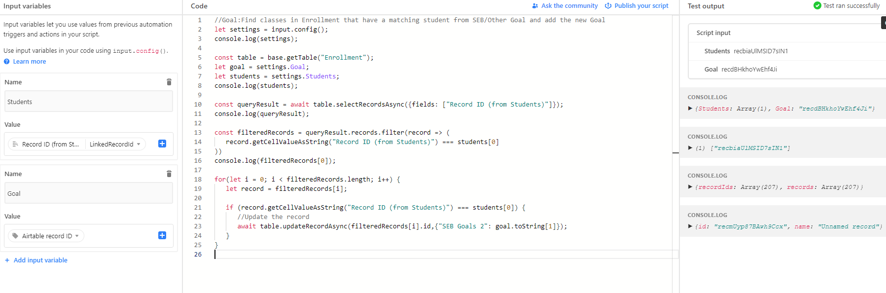

  • February 14, 2023
The following code actually placed a goal id into the "SEB Goals 2" field, but replaced the goal that was previously there.  I'm getting closer.
let settings = input.config();
console.log(settings);
let goal = settings.goal;
let students = settings.students;
console.log(students);
const queryResult = await table.selectRecordsAsync({fields: ["Record ID (from Students)", "SEB Goals 2"]});
console.log(queryResult);
const filteredRecords = queryResult.records.filter(record => (
   record.getCellValueAsString("Record ID (from Students)") === students[0]
console.log(filteredRecords[0]);
for(let i = 0; i < filteredRecords.length; i++) {
   let record = filteredRecords[i];
   if (record.getCellValueAsString("Record ID (from Students)") === students[0]) {
      //Update the record
      let goals = record.getCellValueAsString("SEB Goals 2")
      let goalsArray = []
      if (goals) {
        goalsArray = goals.split(",");
      if (!goalsArray.includes(goal)) {
        goalsArray.push(goal);
      await table.updateRecordAsync(filteredRecords[i].id,{"SEB Goals 2": [{"id": goal}]});
