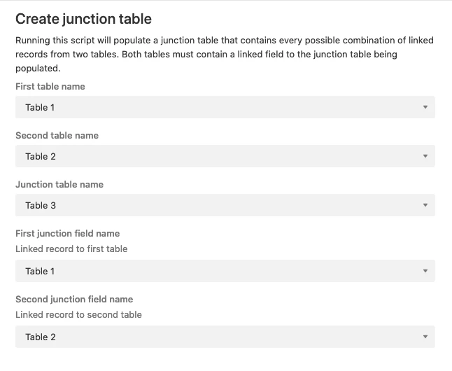

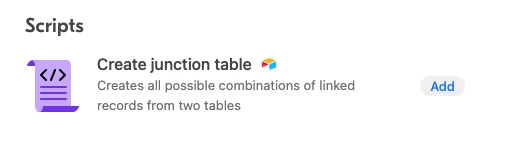

What frustrates me is that the Create Junction Table “Script” (see image) does exactly what I want. It creates a many many junction table, and fixes any errors every time it runs. If a record is deleted, it deletes the junction records associate with that also.
It’s absolutely perfect!
The problem is, I can’t run it from an automation, because when I install it it becomes an “App” and not a “Script”. Even though it’s listed as a “Script” in the app store area. And everything I’ve read says you cannot “run” an app through an automation.
I have tried to just copy the javascript code from it and make my own script inside an automation, but it always throws an error. And my limitations in this area prevent me from seeing why it isn’t working, even after creating input variables.
Does this make better sense now?

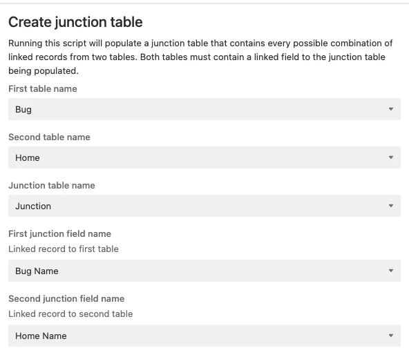

Hm, that looks simple enough to modify. Could you take a screenshot of how you’ve got it set up right now? i.e.:
With a script in an automation action, all the fields and tables will have to be hardcoded, and so whoever assists you would need that information
Forum|alt.badge.img+8
  • May 24, 2022 4:02 AM UTC
sure thing.
  • May 24, 2022 4:06 AM UTC
I’m trying to get it working in a little temporary table, so then I can modify it from there. Here’s my temp table for you. Sign up - Airtable

This is some confusing terminology on Airtable’s part.
  • A Script is some JavaScript code.
  • Scripting App is an “app” that lives in a “dashbaord”–the right-side panel that appears when you click “apps”.
  • A Scripting Action is an action in an automation
Some scripts can run in both Scripting App and an Automation Scripting action, others only work in one location or the other. Someone experienced at writing scripts for Airtable can convert a script that works in one location to the other location.
