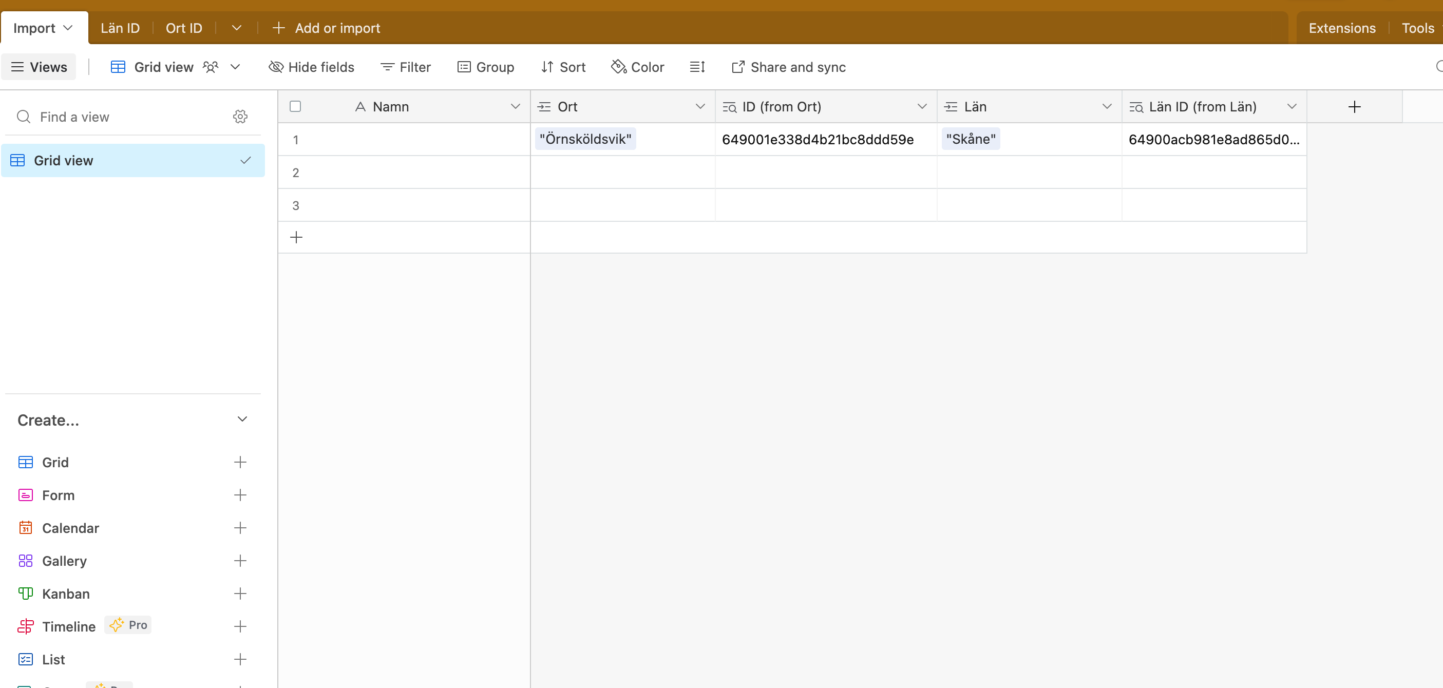

Hello,
This is my first day with Airtable and I have a question.
Ill be importing data via a webhook. Just one location per import (or filled out form that is imported to my Airtable). I I've connected each location to a individual ID for future export. I connected the ID's to all possible locations to choose from, and I want the ID for the imported location to show up besides it. However the ID's dont show up automatically.
Probably a bit of a messy explanation, so here are some pictures:

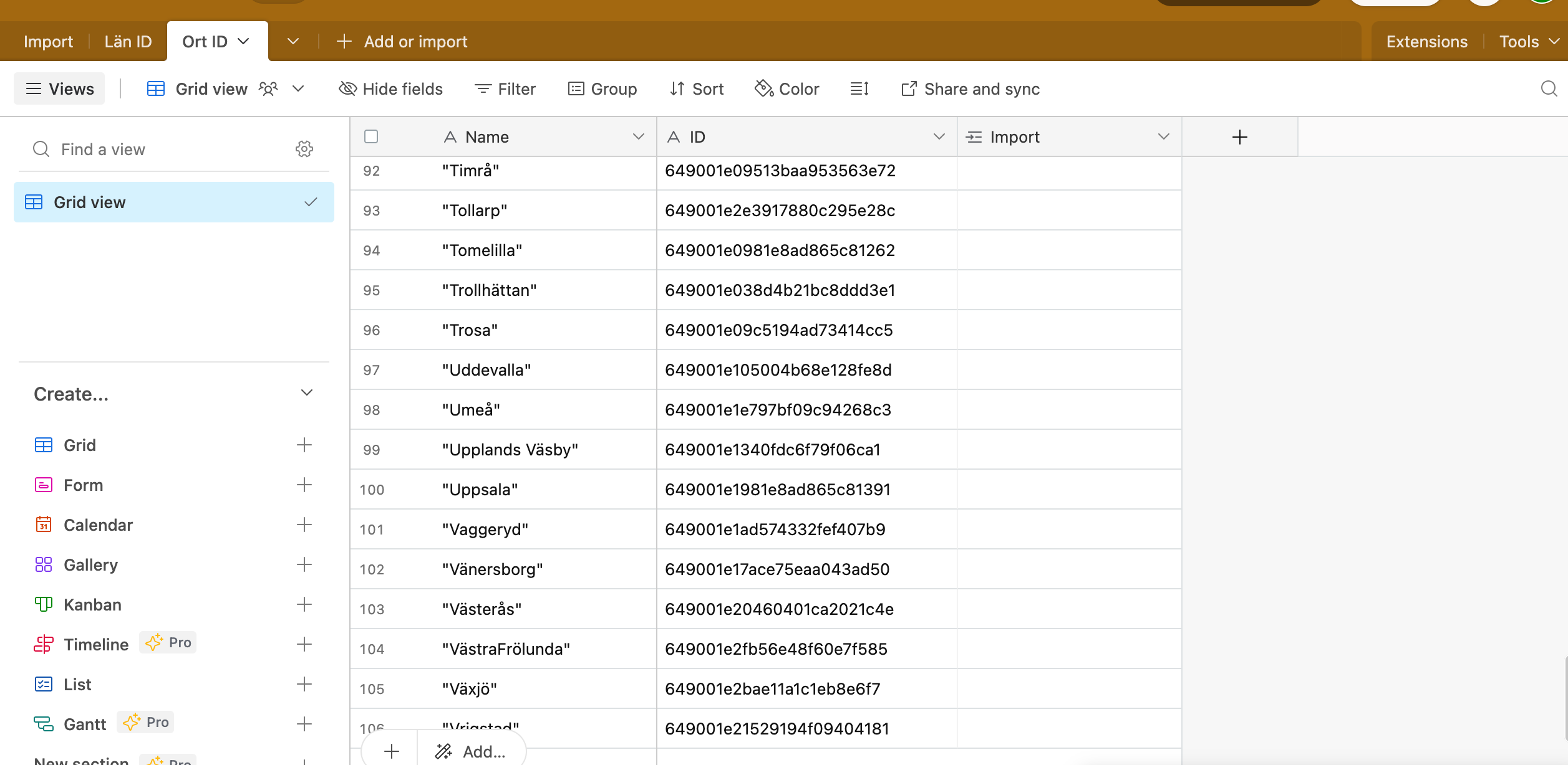

The first picture is where I want the ID's to show up. So beside the "ort" column is the "ort ID". I added this ID manually to make it more clear. On the second picture are all the possible "ort" and their respective ID's. So when importing a "ort" from my website form (automatically) I want Airtable to pull the correct ID from the other table and display it beside the "ort" on the first place. How do I do that?

So the table in image one will be populated how?
If the 'Ort' table is being populated via webhook, then ultimately you just need to make sure that whatever or whomever populates the first table is entering an 'Ort' that exists within the 'Ort' table, and same for the 'Lan' table & linking.
For example, if you entered: "Uddevalla" on line 2, automatically you will get '649001e105004b68e128fe8d' in the ID field since that is the ID associaated with "Uddevalla" on the 'Ort' Table

Exactly, the webhook will populate the "ort" column on the import table. And then I want it to automatically pull the ID from the "Ort ID" table and paste in in the import table under the "ort ID" column.

  • Jun 20, 2023 7:45 AM UTC
Well guys, seems like Im just retarded. Misstook ¨ for " and therefore my "orter" and "län" did'nt match my lookup records that linked to the ID's. Now they update automatically.
