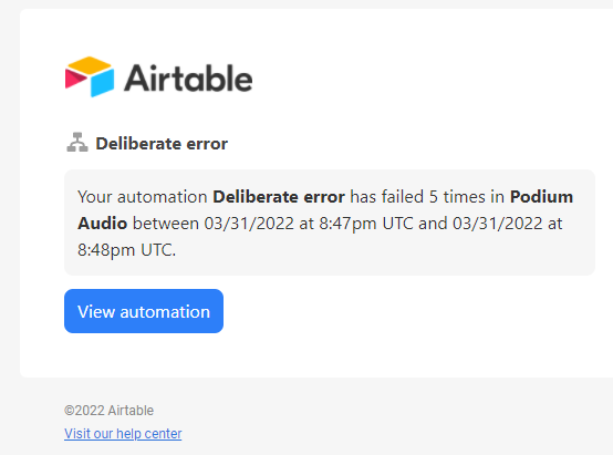

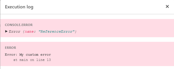

Here’s an example. I checked my email and while I had another automation like this which definitely emailed me when my custom error was thrown, it doesn’t seem to be doing that anymore. Unsure why, but here’s the execution log from a failed run:
So you can see it is failing and recording my custom error code as intended.
Forum|alt.badge.img+13
I should have had faith! Email dropped a tad late:
