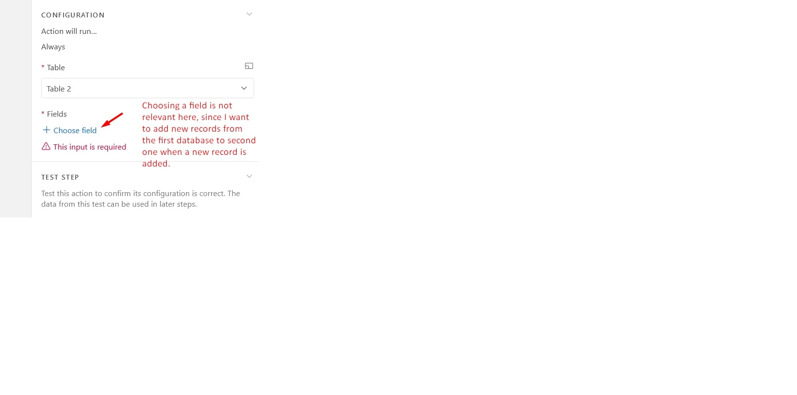

I tried both of your options. But it seems that "field" is a compulsory option for automation. In my case, I want to add new records from Database 1 to Database 2 when a new record is being pushed to Database 1 from Notion.
I think I'm missing a point here 😕😕
