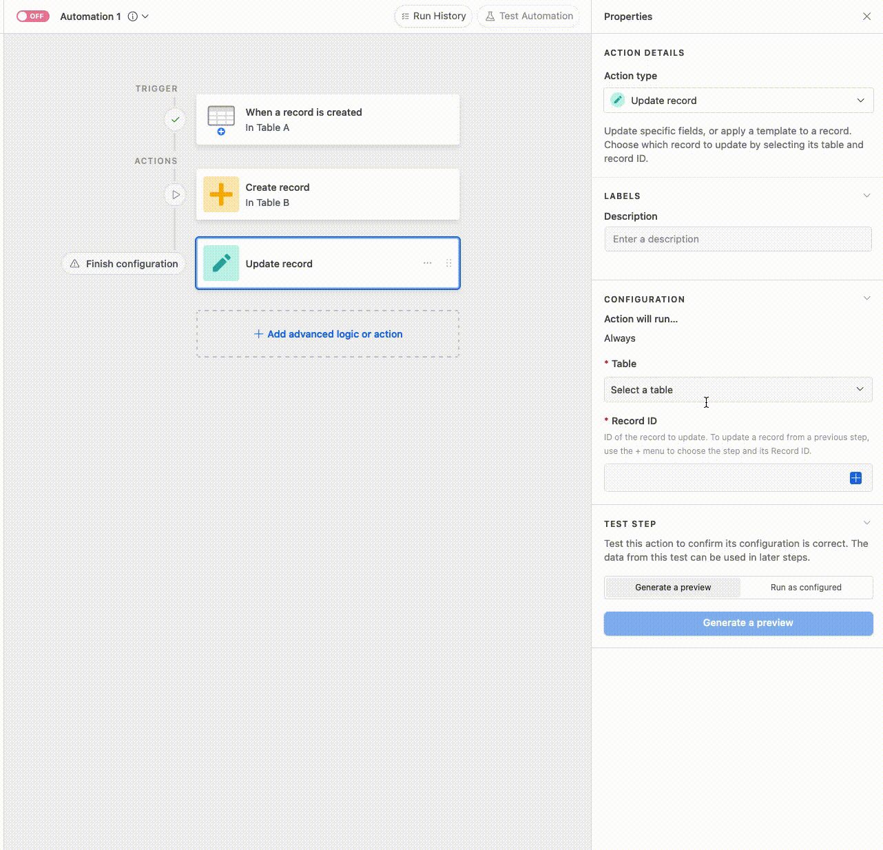

I have a problem using Automation to create a link between records in two tables.
I have Table A and Table B.  Table A has a link field (’Link-A-B’) to Table B.  Table A also has a Form to create a new record in its table.  The form requires user to choose an entry into the Link-A-B field.  If the user selects a particular choice for the value, then the Form exposes another field in A (‘New Option’) that the user is required to type a value into.  Upon submission of the Form in this case—with a non-empty value in the’ New Option’ field—  an automation is triggered to create a new record in table B, and to enter the value of ‘New Option’ in A into the primary field in the new record in B.
All the above I have working just fine in my Automation so far.  But the next action that I want to subsequently have happen in my automation is to change the link value in the Link-A-B field in the new A record: From what the Form user had selected, To a link to the newly-created record in the B table.  I can’t construct an Action that does that update to the new Record in A.  I cannot find appropriate record references to perform this Update Record action properly.  Can anyone provide some detailed step-by-step guidance?  [I find the guidance words for designing the Record Update far too spare and ambiguous— like when the Airtable design framework asks for a Field, I wonder, “from which table and which record, and for what purpose? Source or Destination?]  Examples that I have reviewed usually show options from previous Automaton steps, but I do not see them.   Thank You.
Try the following:
Add an "Update record" step after your current "Create record" step that creates a record in Table B
In the "Update record" step, select Table A and then select the record ID of the triggering record.  Then, add the field "Link-A-B", and then place the record ID value of the "Create record" step in here
Should do what you want I think

Try the following:

Try the following:
Thanks for the solution!  I used this solution and it worked!  The key was choosing the proper step reference after clicking the blue '+' button.  Your animation was great-- but it ran very fast and was hard to follow.  [And my comment about Airtable's design panel being sparse and ambiguous is still my feeling: There should be more guiding notes and information made available for inexperienced users.  Can I make a product suggestion on that?]
