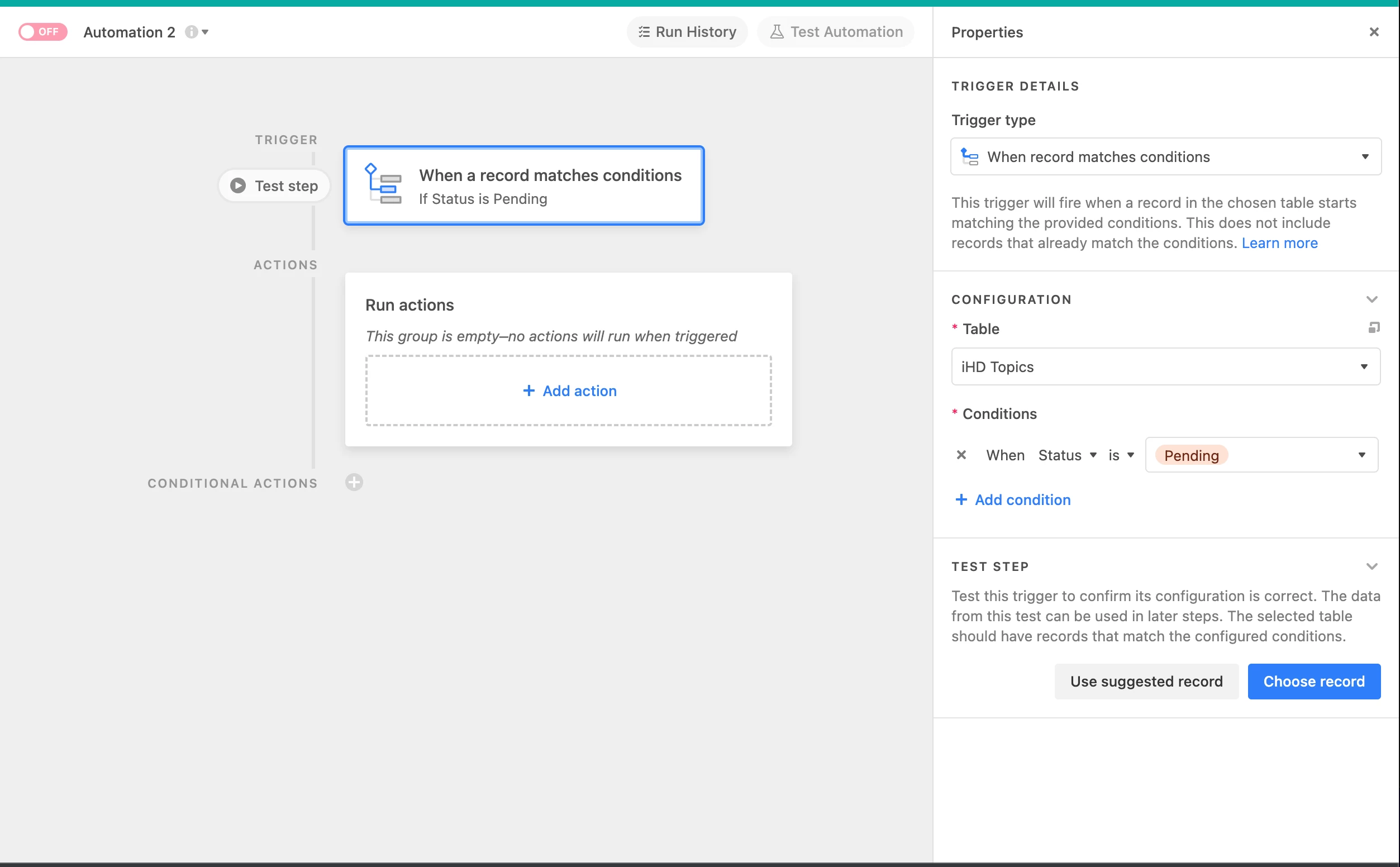

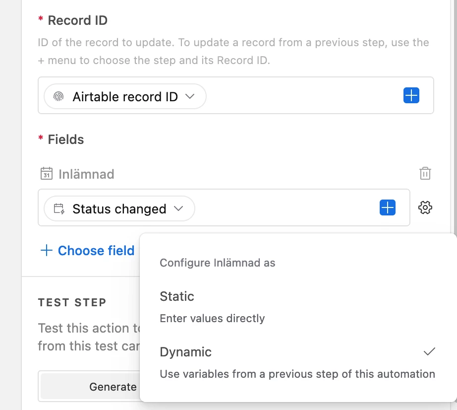

I really appreciate your help on this. I'm so close. I'm just having an issue with the Update Record Configuration (see image #3).
I've got the Last Modified Time set. I've got the automation trigger set (see image #2).  
It's just the last few steps I keep getting errors on. I want to stamp the Last Modified Time into the Pending column (see image #1) when the Status is changed to Pending. Should this column be formatted as a Date or something else?
Again, I've got the modified time set, when the status changes to Pending it schedules...well, nothing because that's where I'm hung up.
Thank you again for your help. So close.

  • December 16, 2022
For your circled Screenshot, you're needing to place the Record that's been matched from the Conditional Trigger - basically the automation is needing the details of the record that will have it's fields updated.
  • December 16, 2022
Okay, one last question and then I'm just going to manually enter the date every time a record is marked pending.
I did what I think you were saying, but I'm getting an error. Are my entries for Table, Record ID and Fields correct? Obviously, I have something wrong.
Sorry to keep bothering you with this. This will be my last message. Thanks again for all of your help.

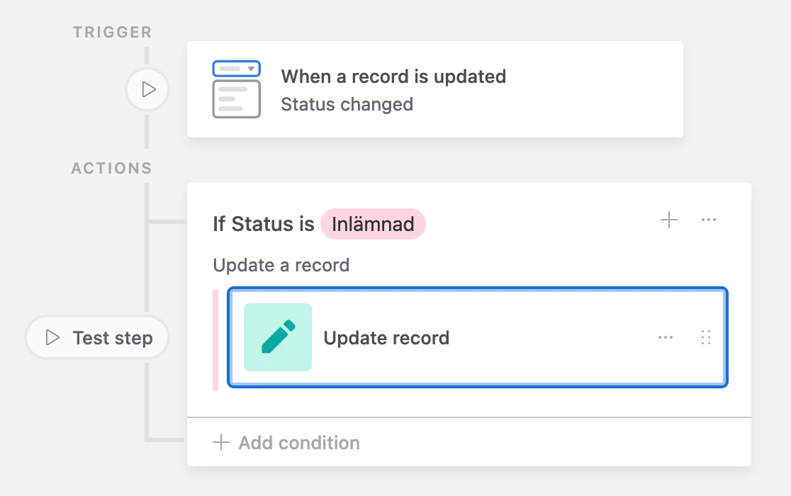

  • August 2, 2023
I guess you have solved this by now. I had the same problem and did like this. First I added a datefield to always update on status change. Then create a new datefield that you want for that speciell status. Then I made an Automation that looked for status and if status was the one speciell the I copied the time from the first datefield.
