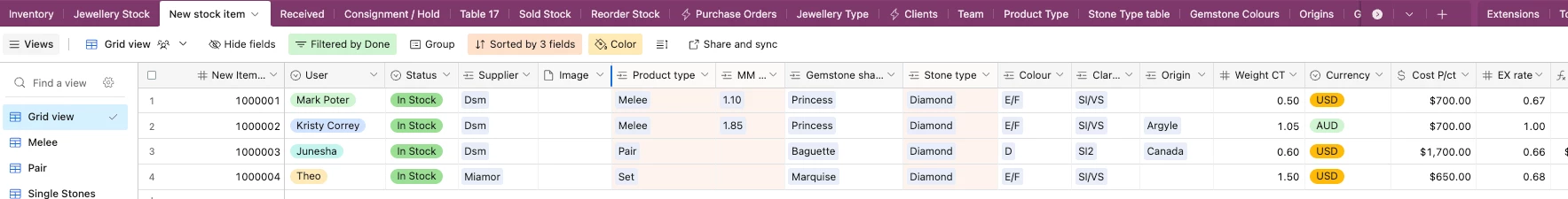

I have two tables I want to update when adding a new product
Table A - Inventory
Table B - Received ( Products received )
Table C - New Item Table : Junction Table
I have created a junction table so I can multiple "New" products quickly and that do not exist in Inventory.

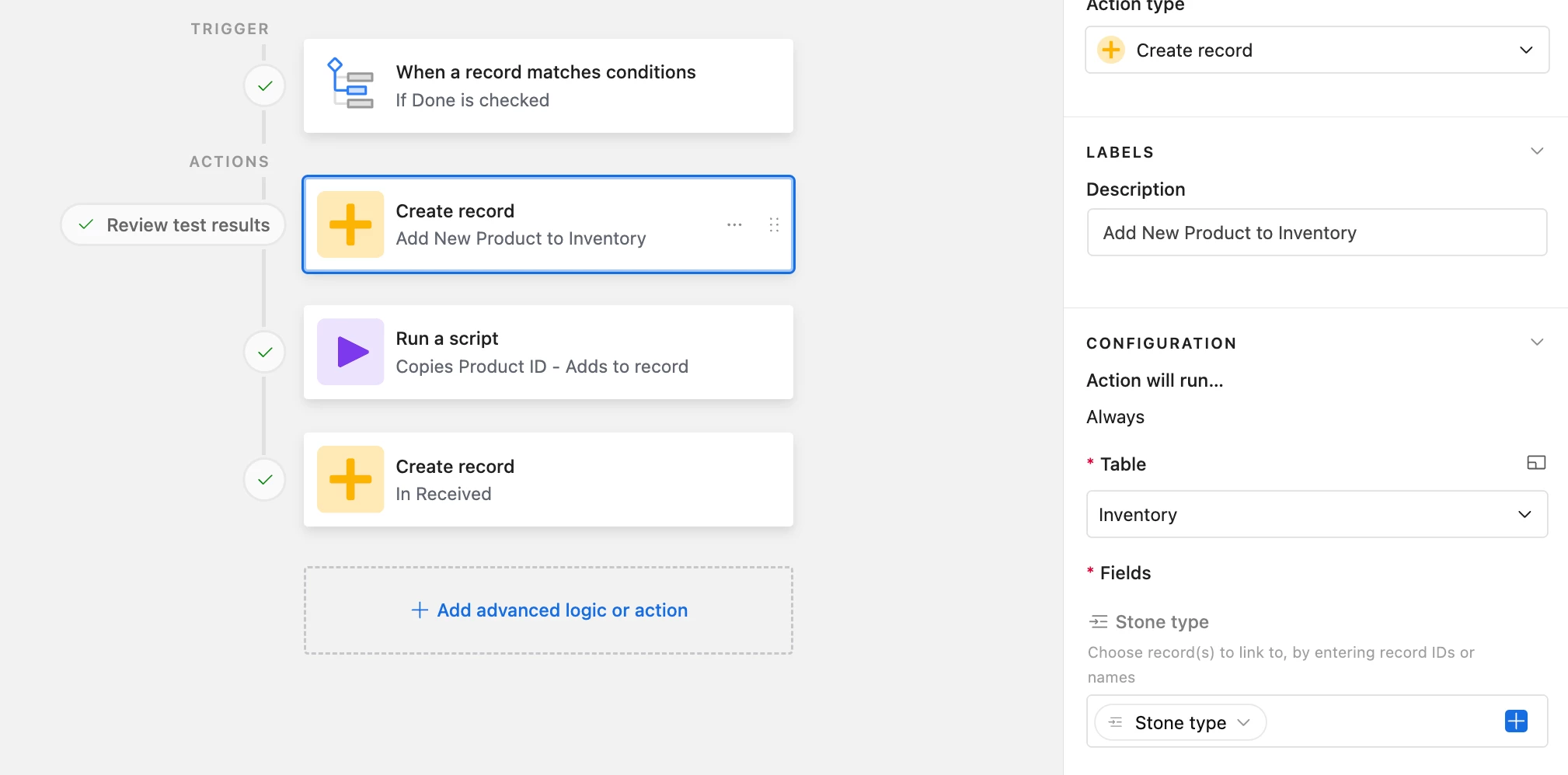

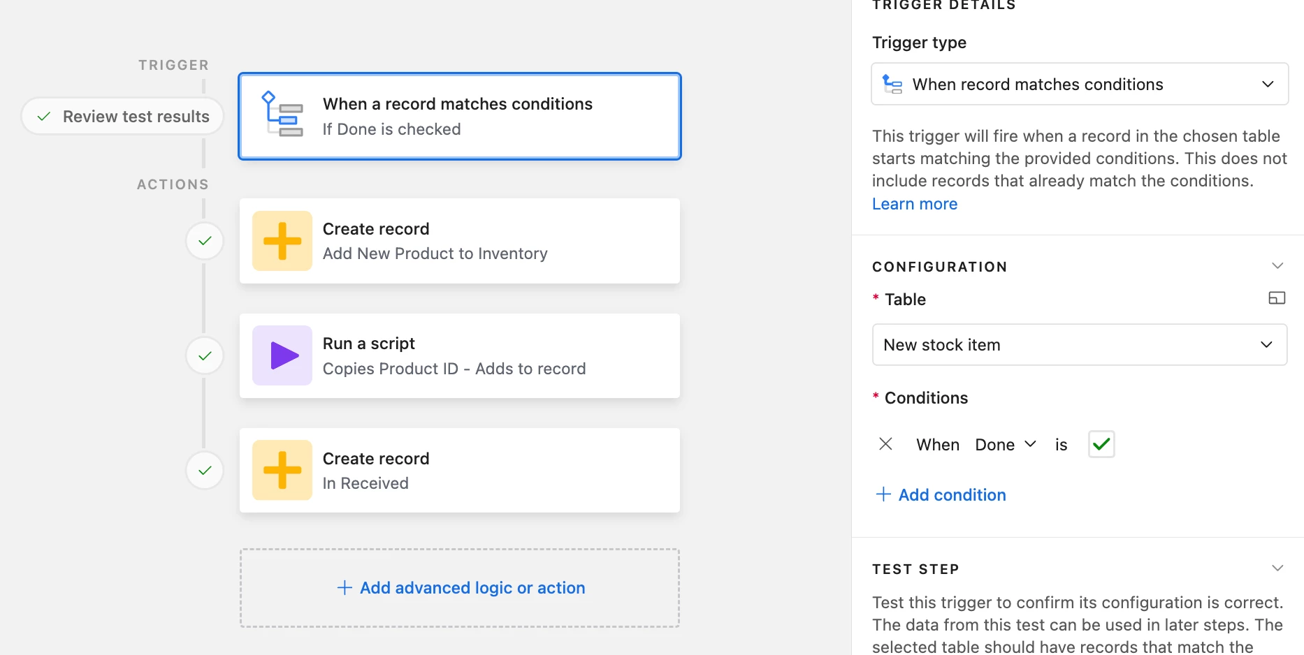

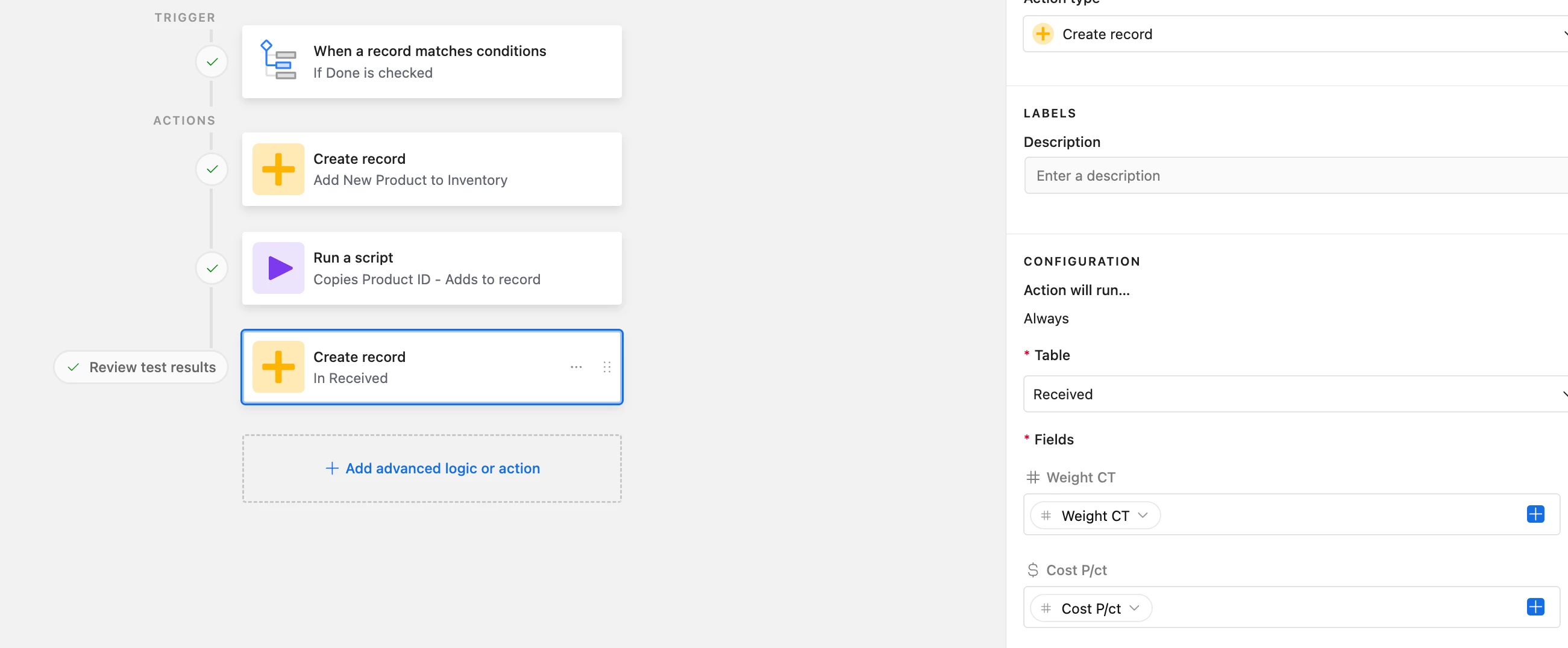

So in the automation I am doing the following
1. Trigger - If Done Checkbox is True
1. Create new record : Inventory - Add all parts of information needed here.

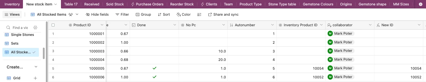

2. Copy New Inventory ID ( Run Script)- Paste onto : New Item Table : Field : Inventory ID ( Because of permissions I create an extra field also - New ID) - Took a while but working
3. Create new record : Received Table : Add quanity received / cost etc..

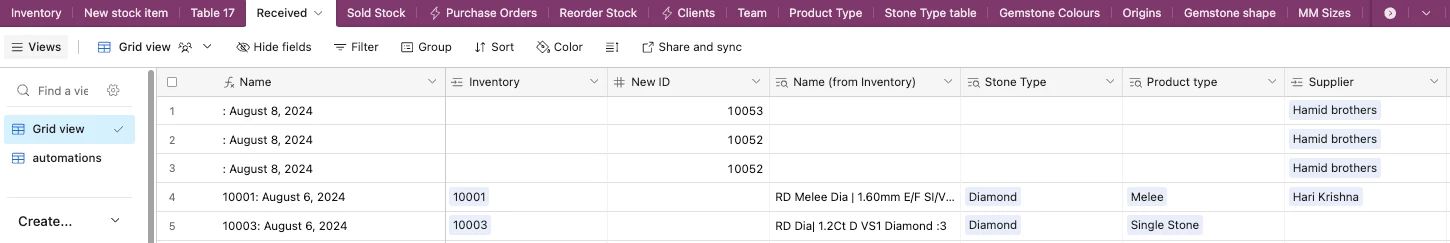

I tried to directly update Inventory ID field ( Linked relationship Field ) Linking Inventory & Received Tables - However worked only 50% of time then stopped altogether : Feel it was a time lag in the software

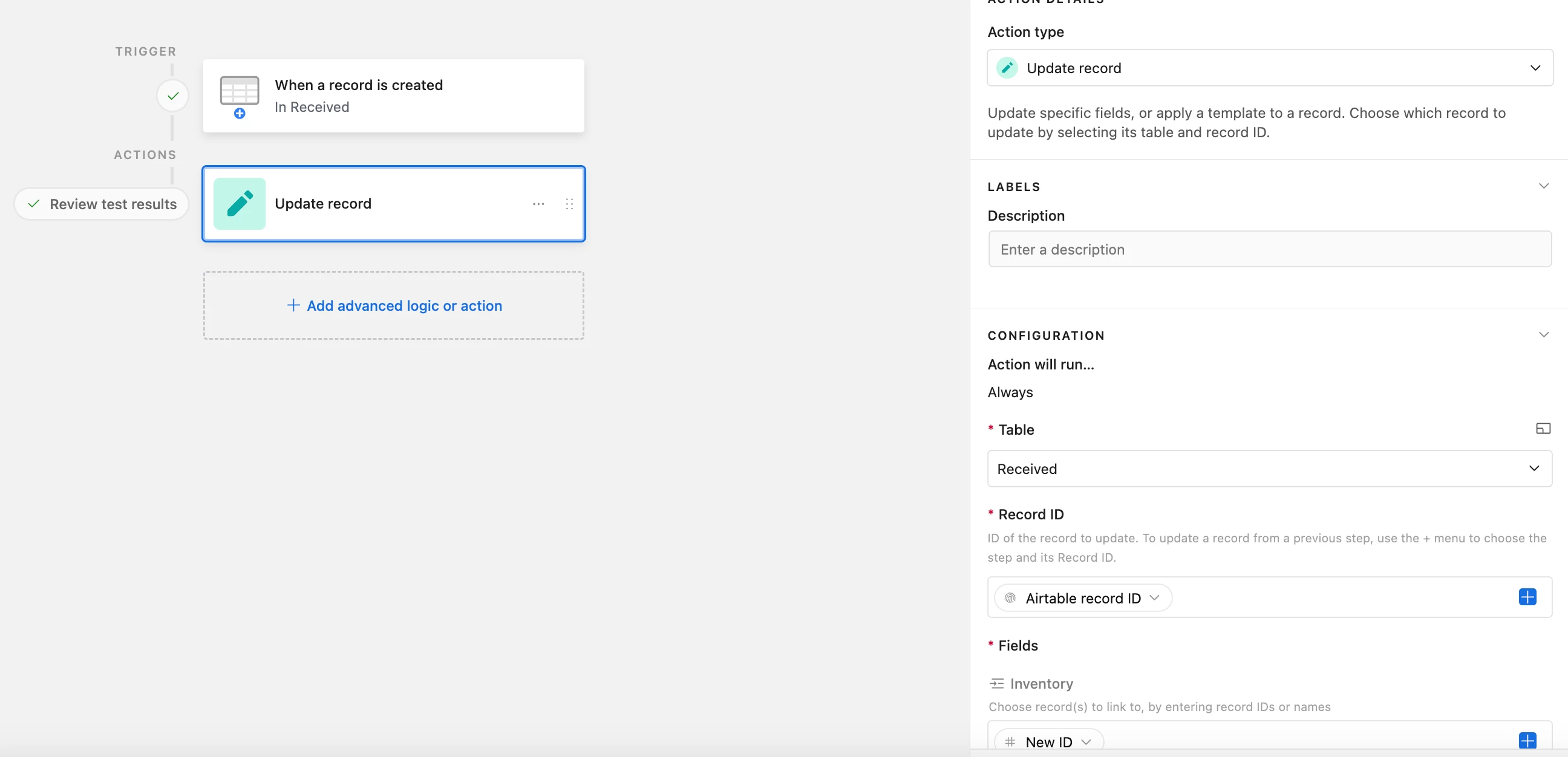

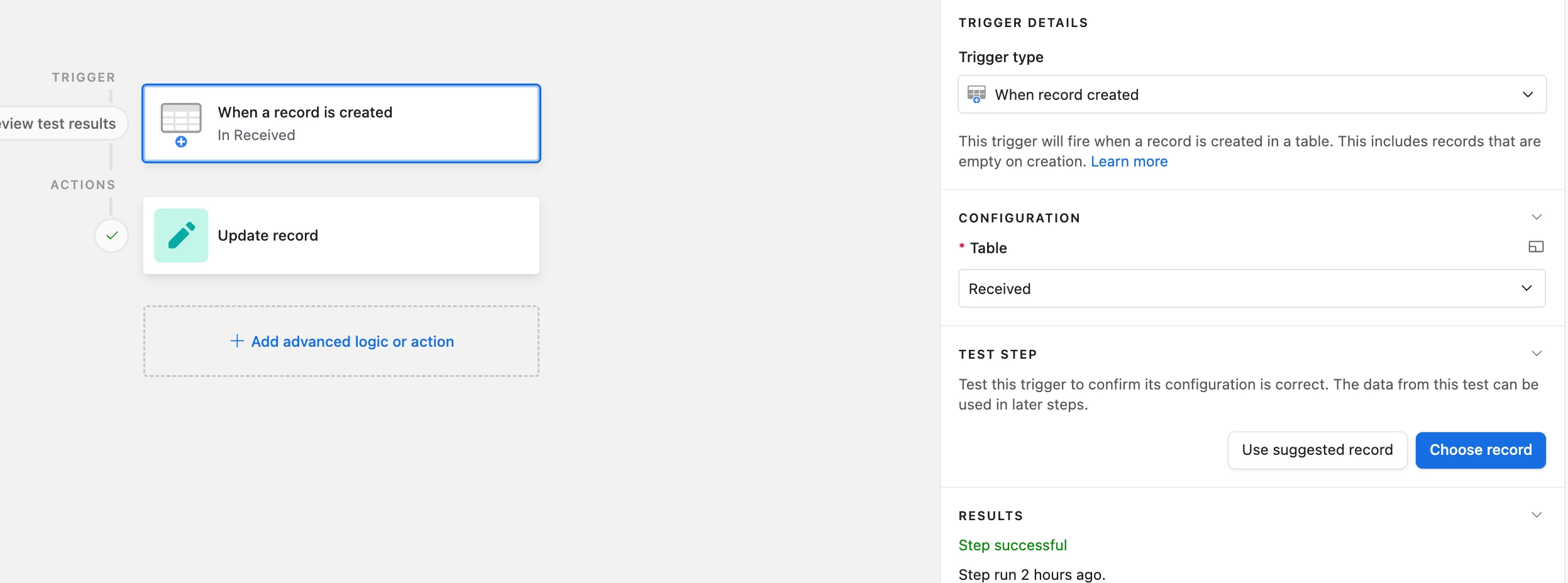

So I created a new second Automation - Update Record
1. Trigger - When a record is created
2. Update : Inventory ID field : from New ID Field

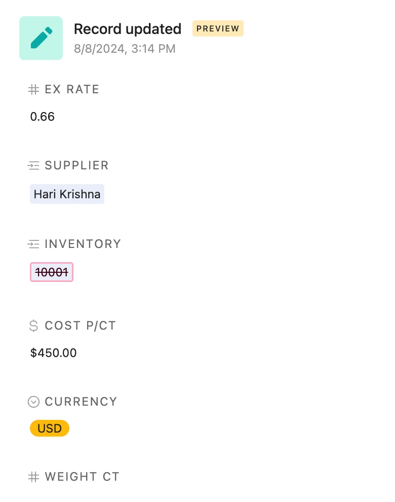

Not working : The number in results has a line through it
This Automation makes no sense to me as been working then not working then working sometimes - I am the creator of this base and added Automations as Creator access so no idea why not working. Does anyone know how to Fix?
I can copy paste into the Inventory ID Field So do not understand the issue every other field is working
I have been trying to resolve for a day and a half as I will need to create similar automation for consignments etc..
Any help
Thank you for your time and help really appreciate it

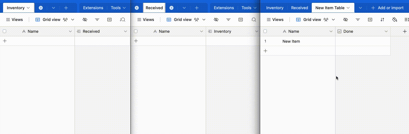

@TheTimeSavingCo Here are screenshots of the whole flow

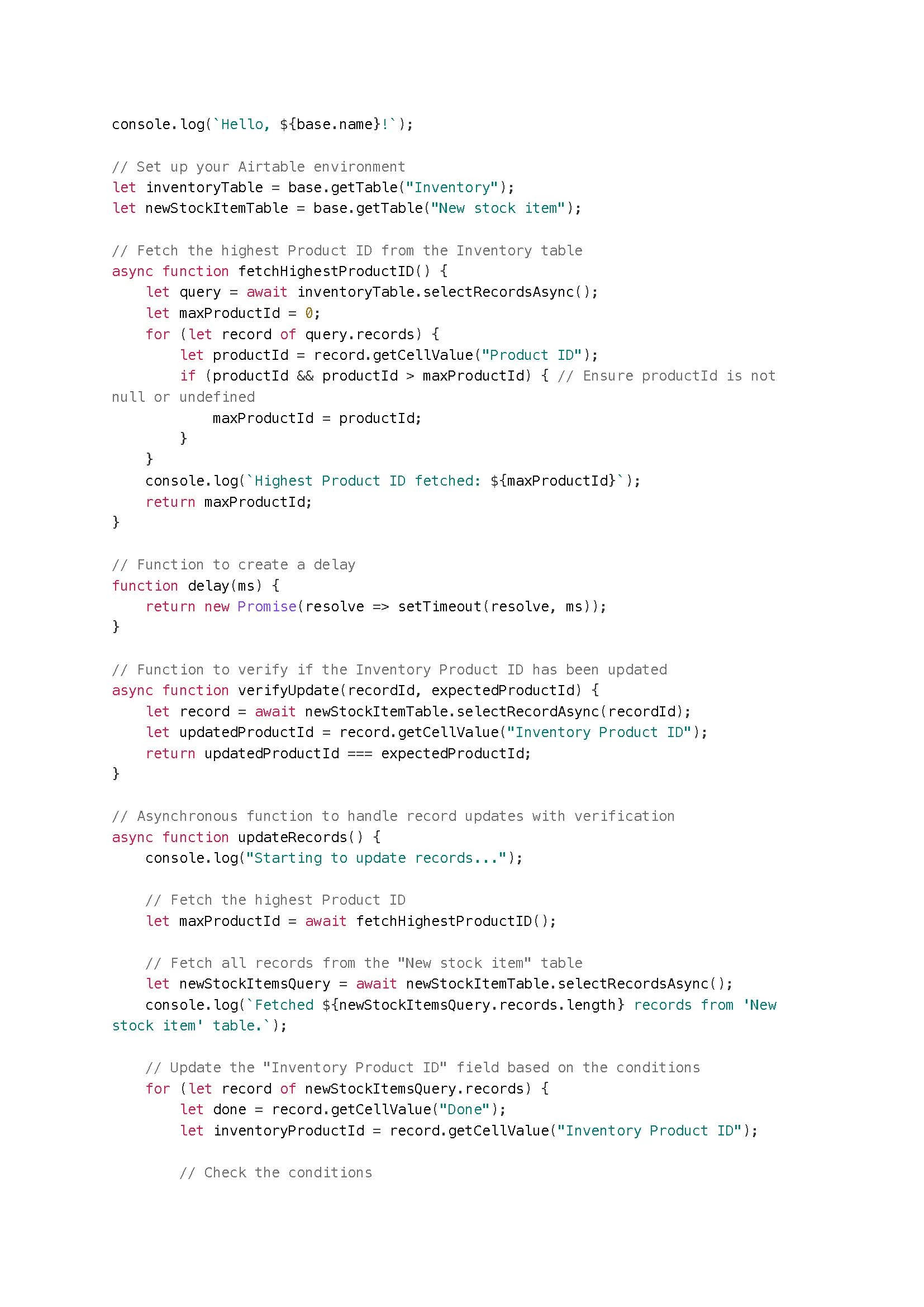

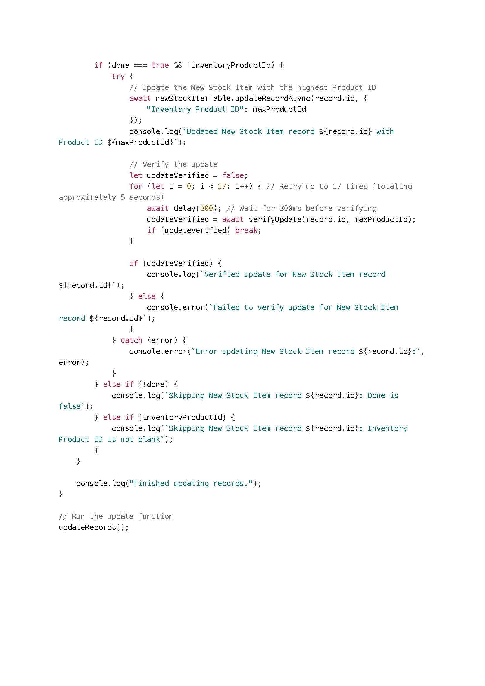

I used ChatGPT for script as no idea what I am doing - maybe format is coming back wrong but : I can copy paste the data and works
Hmm if you don't have much experience with scripting I'm not sure I would recommend using ChatGPT in that manner

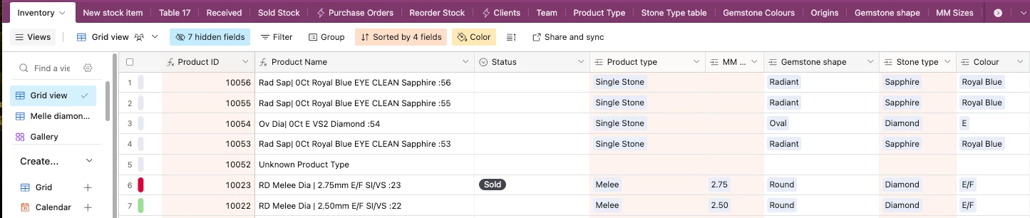

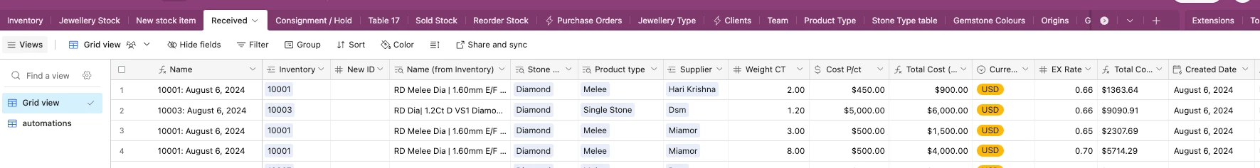

Could you explain what your use case is in general?  Could you also provide screenshots of examples of data input and output?  Specifically, a screenshot of the New Item Table with data keyed in to it, and screenshots of how you want the Inventory and Received tables to look afterwards?

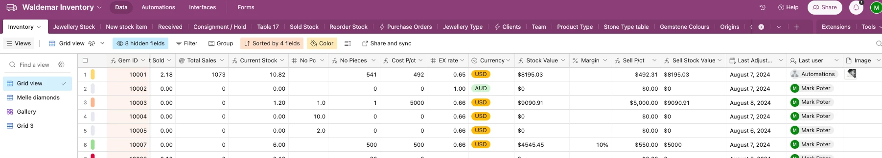

Creating Inventory system that links to Client orders / Consignments and jewellery pieces
Basic case use is to add multiple new items to stock that do not exist in my Inventory already

Thank you so much - I did not think to create Intial : Product id in the New item table. The amount of hours I tried to get this right - Thank you so much!
