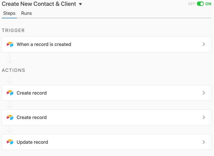

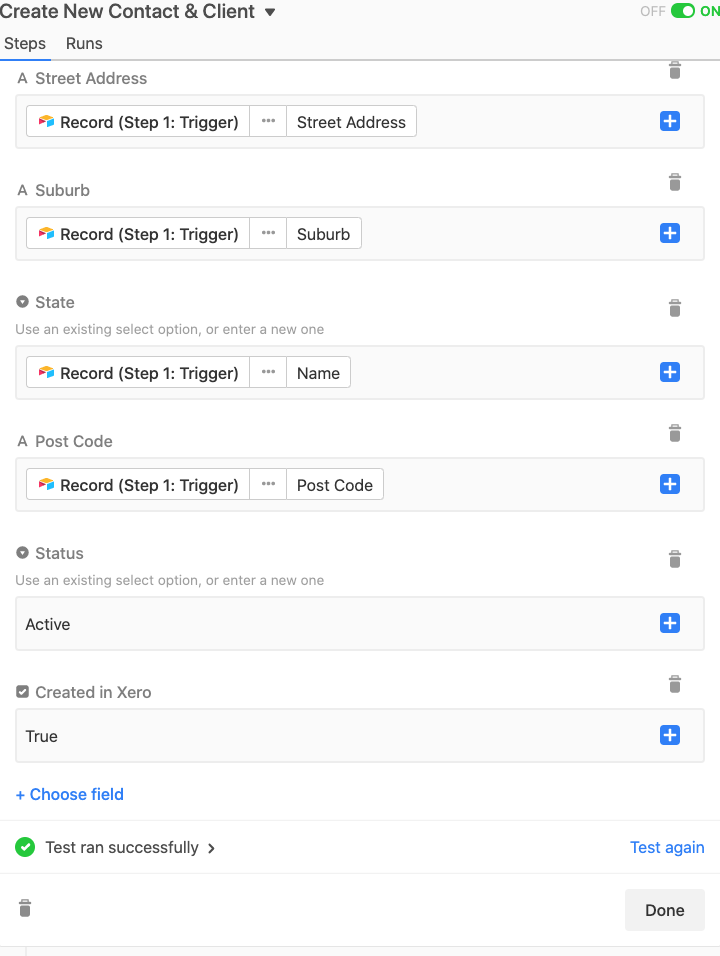

I have attached screenshots of the record creation steps in the automation. I cannot see a duplication in the automation process.

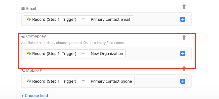

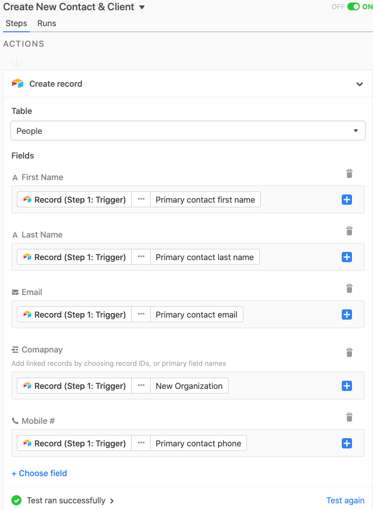

Hi @Brad_Legassick - I’m not sure how you are doing this with a native Airtable form, but I can see you are creating the org in the first create record action (for Person):
This will create a new record in the linked table, but will only populate the name or primary field.

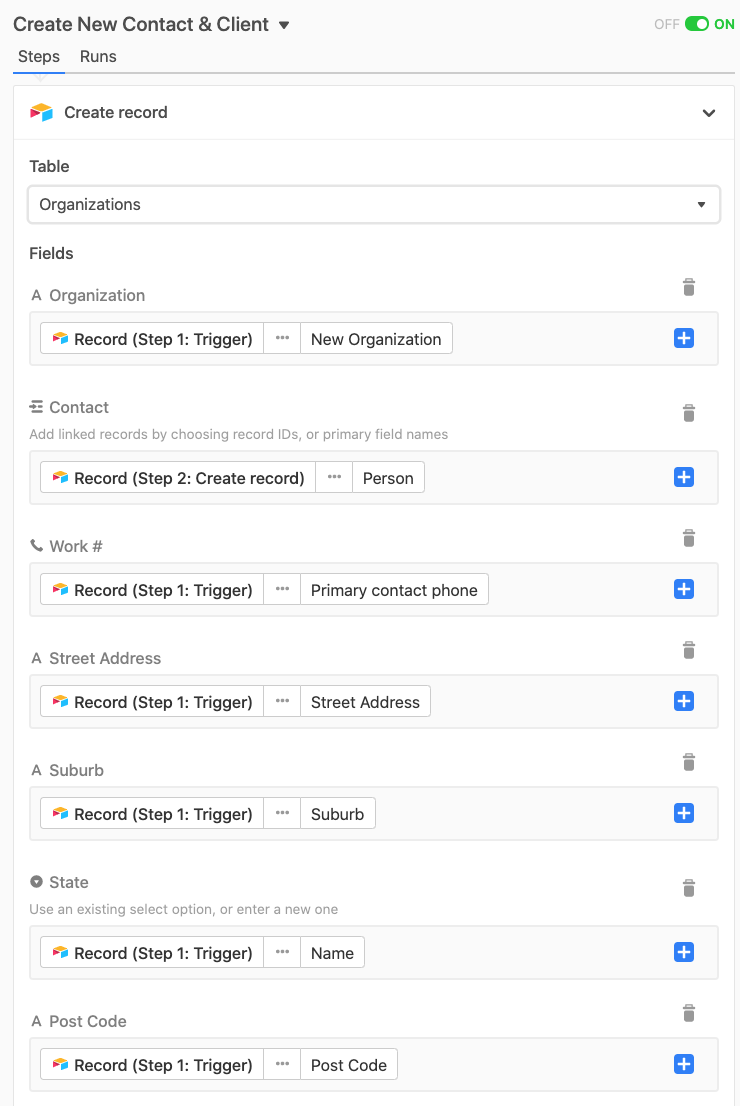

On your second action you are creating the company again with all of the detail.
I haven’t tested this out, but I think it might work if you reverse the order of actions, i.e. create the company first, then the person. The value you pass to the company field on the person action would then be an existing company and so might just link instead of create.

Hi @JonathanBowen thanks for your response. I fixed it by using your advice, just changed it a little. I create the Person but don’t assign an organization to them. Then in the Create Organization step I pass the person created as the Primary contact. All the links are working & only 1 org is now created. Thnks
