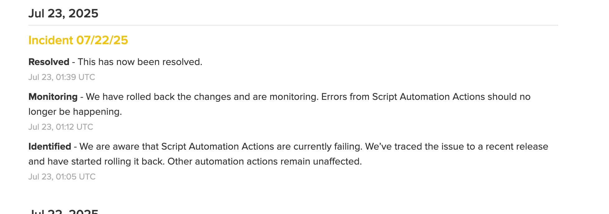

Airtable was having a temporary outage with scripts.
You may want to subscribe to Airtable’s Status Updates at the top of this page, where they will email you when there are outages.
They're not always on top of it — because it requires an Airtable employee to remember to manually update the status page and manually send out the emails — but they’re pretty good about it.
Hope this helps!
If you have a budget and you’d like to hire the best Airtable consultant to help you with anything that is Airtable-related, please feel free to contact me through my website: Airtable consultant — ScottWorld
Hey ​@laurav04
For further context, below you’ll find a screenshot of the AT issue Scott is making reference to above.
The incident seems to be making reference to Errors rather than delays… not sure exactly if that includes delays as well I’ve been experiencing delays on my side as well :(
