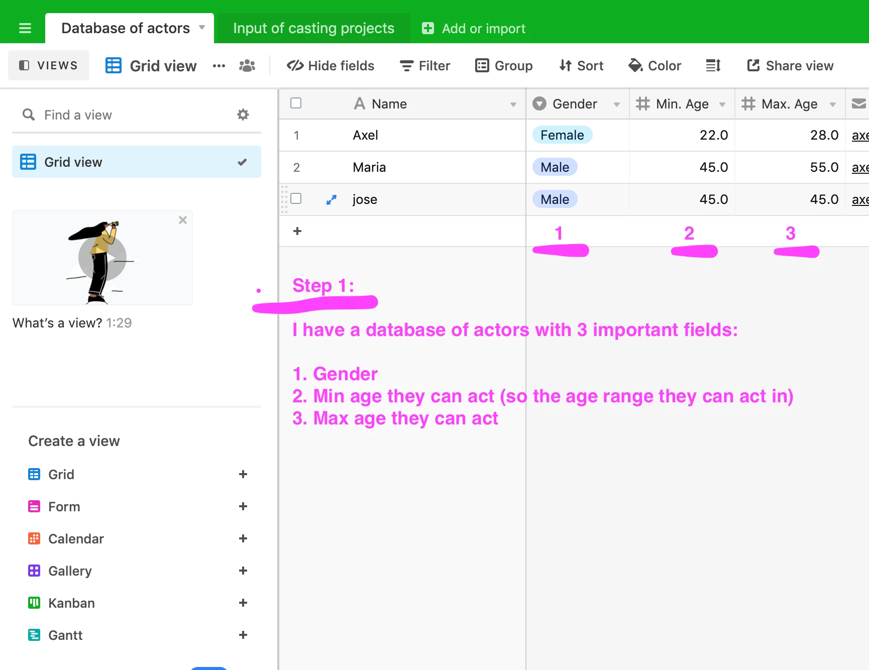

  1. Actors (a database of actors sorted by gender [single select], min.age they can play and max. age they can play)

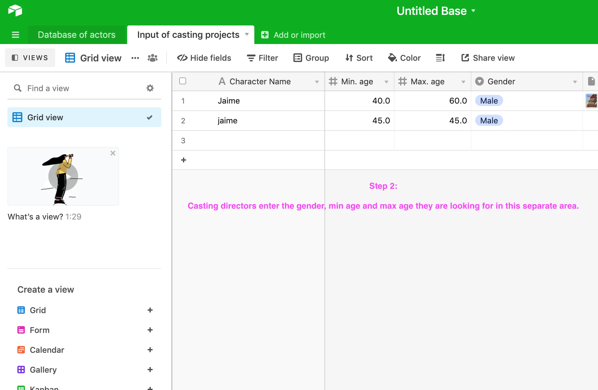

  2. Actors wanted (a database where directors can input the gender [single select] and age range they are looking for)

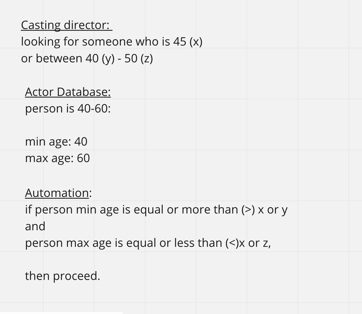

I’m trying to run an automation where when a director enters what she/he is looking for, it filters for all qualifying actors and sends an email to all qualifying actors.

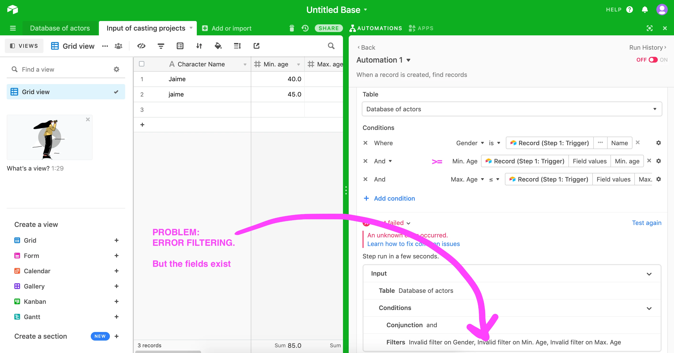

Problem: the filter is showing an error. I’ve tried to only filter by age, only by gender but it always responds with an error like " Invalid filter on Min. Age".
Any idea what I can do to make the filter work?

Welcome to the community, @Elisabeth_Schloemmer! :grinning_face_with_big_eyes: Could you describe your setup in greater detail? Screenshots would be very helpful (even if you have to mask out things for privacy).

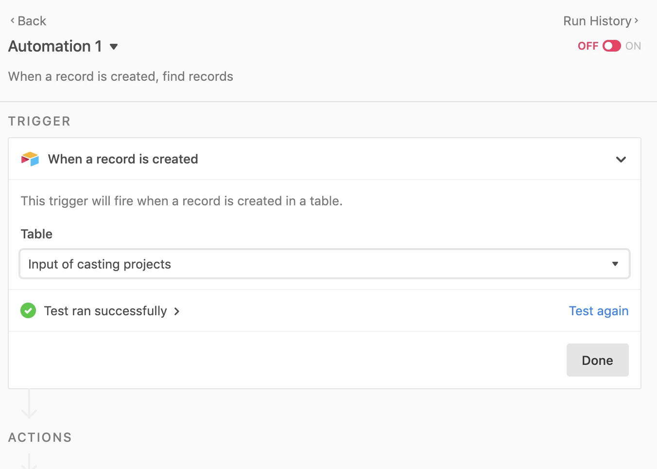

Hi, thank you so much for the quick replies! I’ve been able to solve the issue with changing the trigger. It now runs on “When record is created” and the first action is to “Find records”. That way the error didn’t occur again.
