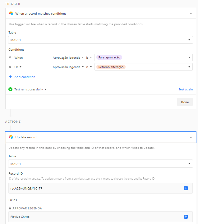

I created an automation that, once a Single Select cell is updated, it will tag a Collaborator in another cell. However, I have to create one automation for each record. Is that right? Is there an easier way to do that?

I typed it myself, since I couldn’t do it with the trigger step.
Here is a print of the automation:
The Trigger part is working fine; whenever I chance a Single Selection cell, it tags the collaborator. However, it only tags this specific cell, and not the one on the same line.
Thanks again for the replies, Kamille!
Take out the typed in record ID, click the blue plus sign and select Record (from Step 1), then click “insert” next to Airtable record ID

Incorrect. The Automation will run whenever any record in that table has its Single Select field updated.
You have probably already done what you need to do unless you’ve set something up inefficiently.

It’s vey likely that I’ve made a mistake, it’s my first time running automations. Let me try to explain it better.
On the Actions, I had to set a Record ID for the Collaborators cell. Therefore, everytime I update a Single Select field, only that one cell is uptaded, instead of the Collaborator cell on the same row as the cell I’ve uptaded.
Is that more clear? (Sorry for the mistakes, English is not my native language).

Did you type in a record ID yourself, or are you using the record ID from the trigger record? If you are using the record ID from the trigger step then you shouldn’t have an issue.
If you’re still “testing” your Automation, tests pick one record in the relevant table and use those values for all tests. If your Automation is turned on and you’re still having issues, that’s a different story.
Can you post a screenshot of your automation?

It worked! This must’ve been so obvious to you, but I couldn’t figure out. Thanks so much for the help, Kamille :slightly_smiling_face:
