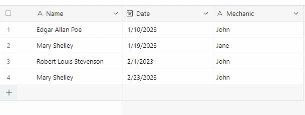

So, table 1 here has customer names and the date they booked our mechanics. (The data in this table is updated from our website)

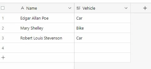

Table 2 (also updated from our website) is basically a contact information about our clients and their vehicles. 
As you can see in Table 1, it's basically the bookings so any of the clients can re-book us and it will be logged separately (Mary Shelley being in 2 and 4). However, in table 2 she's only registered once and thats what our programmer did.

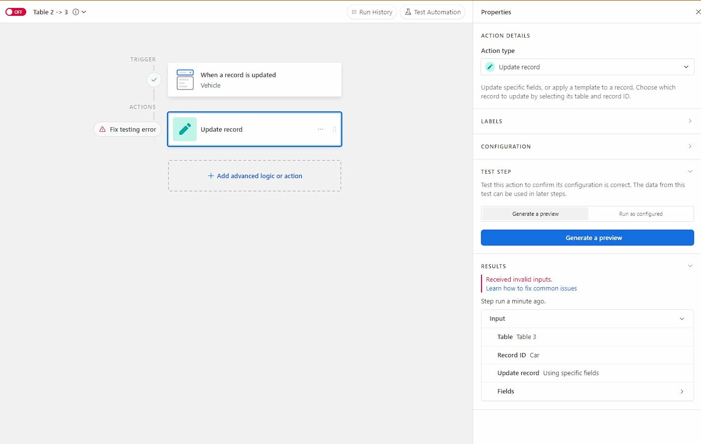

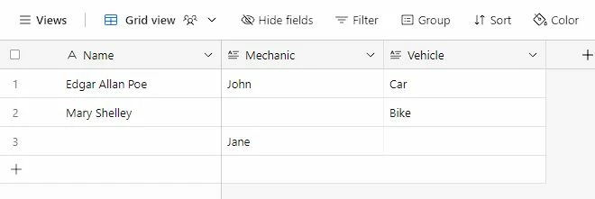

Now on to my issue: Table 3 was supposed to use airtable automations to gather the Clients name and mechanic from table 1 and the vehicle from table 2 into one. But I can't seem to make this work without it overlapping or creating its own row. 
As you can see the first row is supposed to be an example: data from table 1 and 2 all into one row. Meanwhile the automations I've created have made them overlap each other. I've tried updating records as an action however I can't seem to get record ID correctly as the automations does not run.

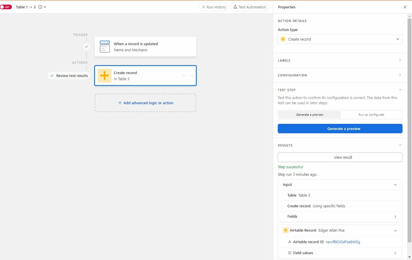

Thanks for replying to my issue once again. My automations trigger when the record is updated (Table 1 and Table 2 is updated automatically from our website) and from those updated records the automation should be updating table 3 (basically all the information is now into table 3)
More I look into it, basically Table 3 is our contacts list (Table 2) since the names should not be replicated but with more information which is taken from table 1.
From this image: Once Table 1 or our bookings is updated then we go ahead and create a record for table 3 which works and I'm glad it does!
But for table 2 (contacts) -> table 3 I chose to update records since my goal is to make it all in one row for each client.
 But the automation seems to not work, I'm not exactly sure why. If its the record ID I've went and tried each one to no avail.

If your goal is to make it all in one row for each client, I would suggest not using Table 3 at all
In "Table 2", create a linked field to "Table 1", then create an automation that will trigger whenever a new record gets created in "Table 1", and its action will be to paste the value from the "Name" field into the linked field.
Then, create a rollup field in "Table 2" to display the mechanic names and dates as needed
Check out this guide by Airtable on linking existing records, as well as lookup fields
