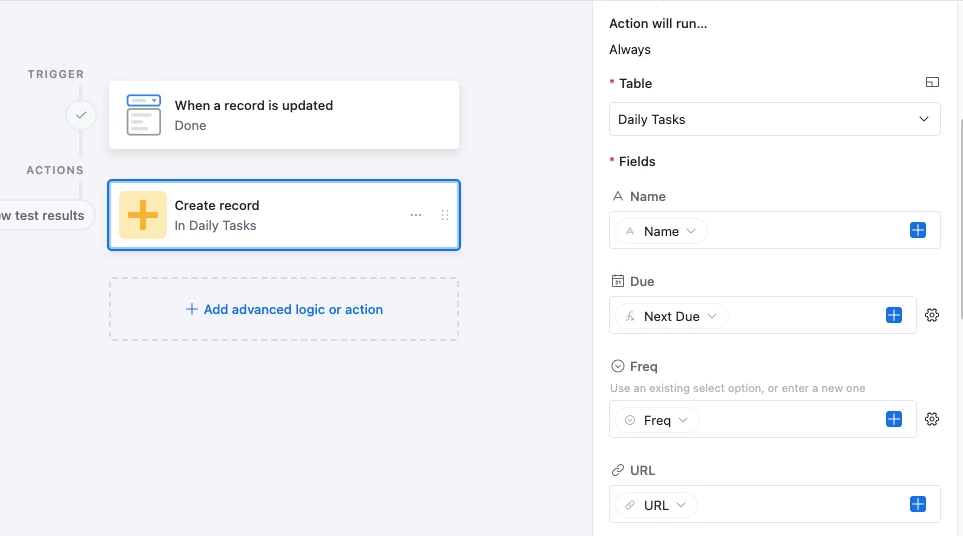

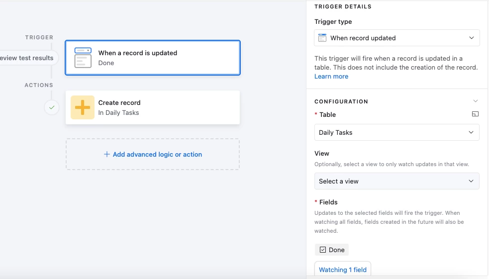

I then have an automation that runs to create a new record with a 'Due' date populated with the previous records 'Next Due'

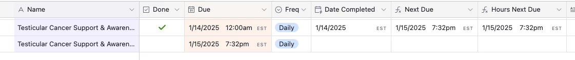

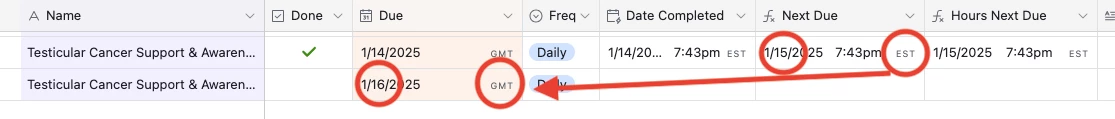

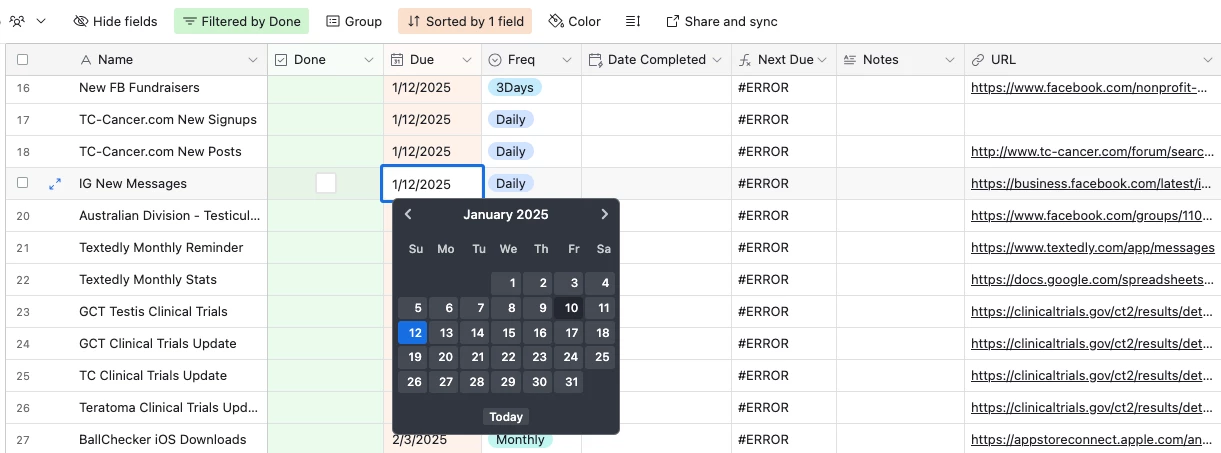

You an see in the attached, "IG New Messages" was clicked 'Done" on 1/10, 'Date Completed' was 1/10, 'Next Due' was 1/11 but then the automation changed the new records 'Due' to 1/12
It is like there is a time zone issue somewhere but I can't figure it out so any help is greatly appreciated.

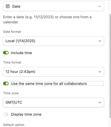

TL;DR: It appears that the 'Date' field type defaults to GMT, unless you turn on the 'Include Time" function and 'Use the same time zone for all collaborators' and then select the desired time zone. However, the time zones are still not respected unless you use the 'include time' in the formula formatting results. With my abilities I can't find a way for the formulas/automation to respect the time/time zone without displaying the time, which makes it messy looking but at least it is functional.
OK, so I have a mixed solution. Thank you @ATSolutionist as the Error code fixed the annoyance and the hours code worked too. I saved it in the base incase I need to use it somewhere else.
As @DisraeliGears01 mentioned, I turned on the show time zone and noticed that the "Date" record type is basically hard coded to UTC/GMT and the only way to get around it is to turn on the time format.

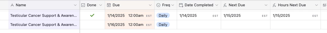

Even with all fields on EST, the error occurred again tonight after 7pm.
I edited the automation to be based off the 'Hours Next Due' and it still skipped from 1/15 to 1/16.
Only after I turned on "Include Time" in the formatting of the formula was there finally resolve and the adding a day was removed. This last example, was based off the original 'Next Due' field.

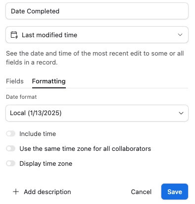

Is the date completed field formatted to also show time? Have you tried turning the include time off?

The completed field does not have a time included. I did turn on the "Use the same time zone for all collaborators" to troubleshoot but turned it off and it still just added a day.
Same with the formula field. I did again turn off the same time zone function but still added a day and here are the formulas
I apologize as I am a pharmacist by trade and this is for a cancer charity I founded so I am not sure what is the best way to share the automation but

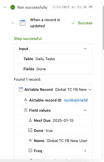

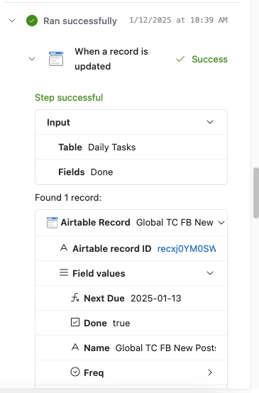

I did notice that the same "task" run during the day and then run just now, the one late in the evening is when the extra day is added to the 'next due' at 10:39am it changed from 1/12 to 1/13 appropriately but at 11:38PM it changed from 1/13 to 1/15. I tired to go back and there are automations that ran at 6:58pm and were fine but then after 7pm is when it adds a day and it is for all formulas, add 3 days changes to 4 days, etc.

This is absolutely a timezone issue, Airtable loves to convert everything to UTC/GMT. Have you tried turning on all the time fields, setting your timezone to the appropriate one, and then just ensuring your automation/formula fields format away the time part of your datetime string? That usually solves this problem for me.
