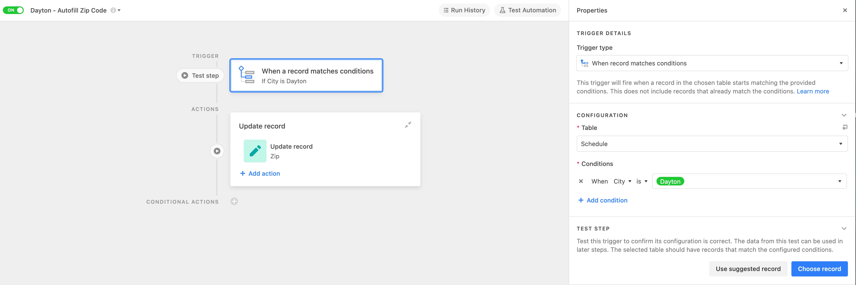

Hello, I would really appreciate if someone could help me to solve my puzzle)
I have a table "Schedule" where we input addresses, every address goes into 3 separate fields,
"Street Name", "City" and "Zip Code"

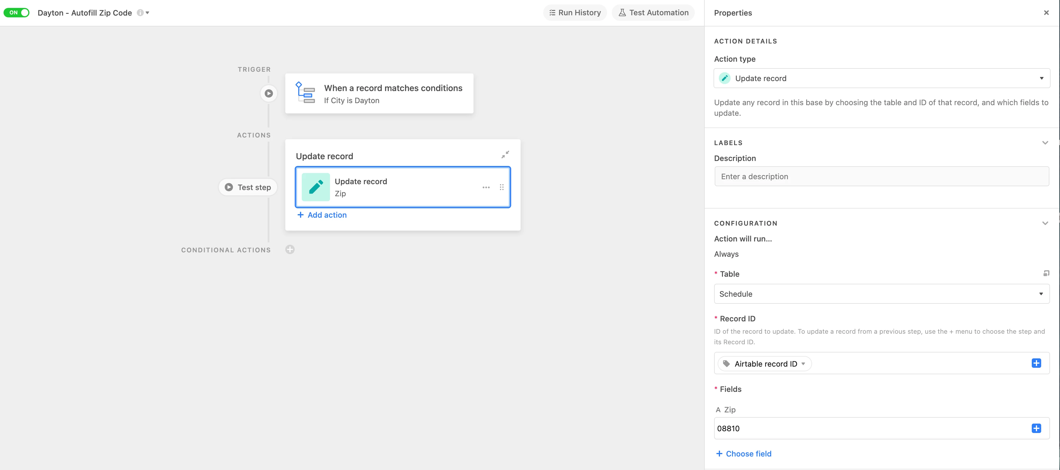

So I created an automation (check images attached) where "Zip Code" field is auto filled with preset zip code when a "City" is chosen. Everything works fine, but automation works with one city only and my question is, is there a chance to modify automation where I can add options to fill zip codes for other cities in the same automation, not just one or I need something else and I chose the wrong path to do it.
I tried to create a separate automation for every city we have in the "City" field, but very quickly I was told by Airtable that my plan allows me to have only 40 automations and I have around 100 cities in the "City" field
Thank you in advance for those willing to help.
Hm, what if you used a formula field with `SWITCH()`to deal with this instead of an automation?
SWITCH( City, "Dayton", "08810", "City 1", "12345", "City 2", "67890" )

Thank you TheTimeSavingCo, everything worked and you are the creative mind!
