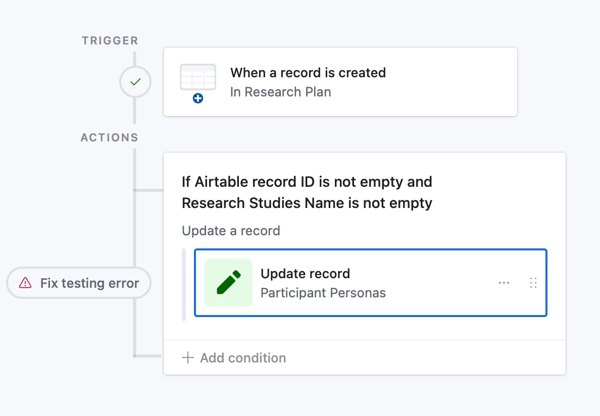

We tried doing this with an automation:
  • Trigger: When a record is created (Research plan)
  • Action: Update record (the same Research plan record)

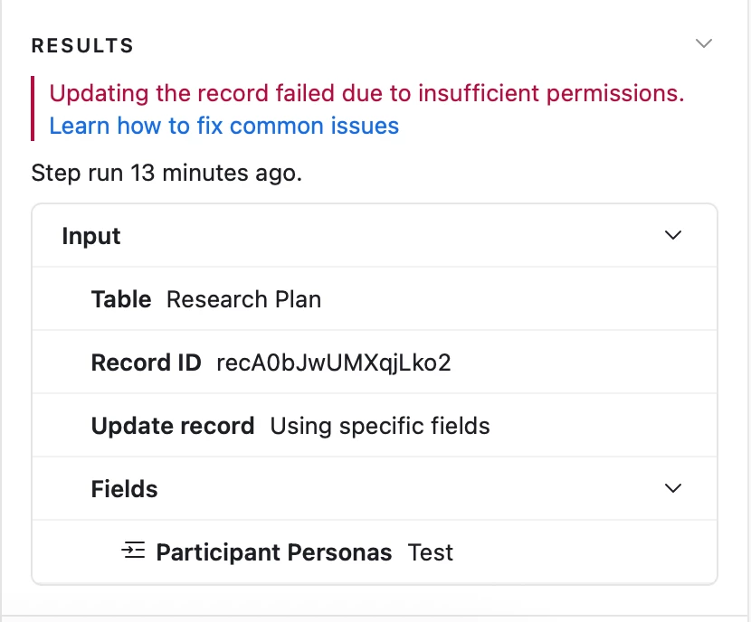

However, the automation fails with the error: “Updating the record failed due to insufficient permissions.”

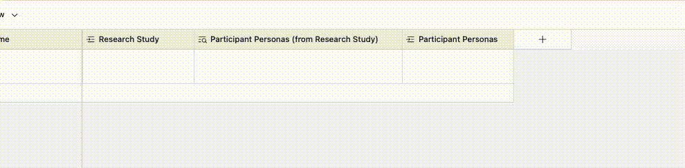

Could you provide screenshots of your tables with the relevant fields as well as the automation set up?
If that’s not possible, may I know the field type of the ‘Persona’ field in the Research Plan table is?  Could I also confirm that there are no permissions set up on the Persona field and no permissions set on the Research plan table as well?  No worries if the lookup field already solves your problem though!
  • Apr 16, 2026 3:22 PM UTC
Hi, in this particular case, yes — lookup solves the problem because we’ve already linked the research study in the Research Plan.
I’m still interested in this topic, since in some cases we’ll want to automatically add data without having it in the table.
I’ve attached a few screenshots below.

Are you trying to update a record in the “Research study” (or Personas) table while passing the Record ID from the Research plan table instead of the linked record’s ID? I think you might be using the wrong Record ID.
Hm, is the primary field of the Participant Personas table a formula field?  If it is, and we get the automation to update the linked field with a value that doesn’t exist in the Participant Persona’s table’s primary field then the Insufficient Permissions error will pop up

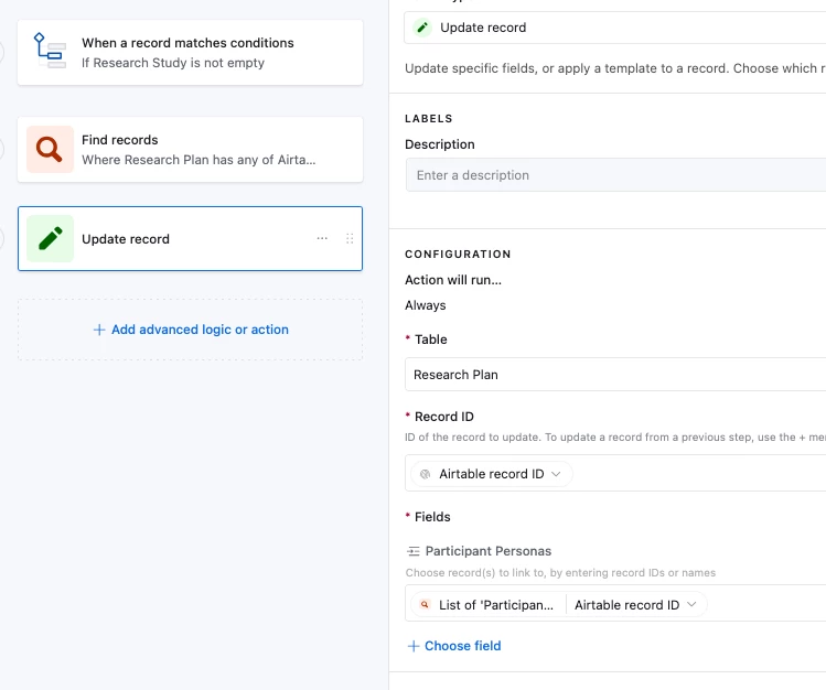

I’ve set up an example here for you to check out in case that’s helpful as well

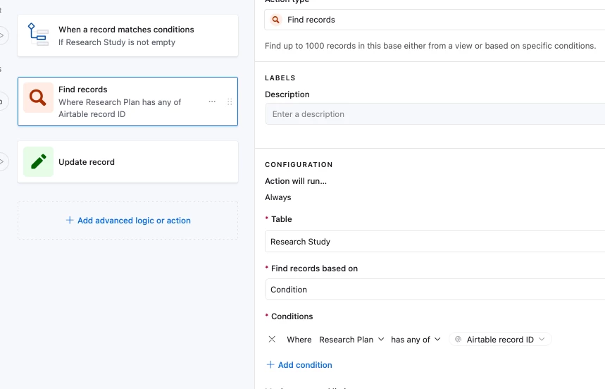

The automation first retrieves the Research Study record via a Find Record action:
And it then updates the Research Plan record with the found record’s Participant Personas:
Looking at your screenshot, it looks like "Participant Personas" is a linked record field, so the update step needs a record ID, not a text value. Passing something like “Test” won’t work there even if permissions are fine.
Building on what Adam shared above, if you’re pulling Personas from the linked Research Study you’ll need to either use a lookup, or retrieve the record first (Find records) and pass those record IDs into the update step.
