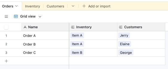

My base contains 3 tables. An inventory, a customer table, and an orders table.
There are linked fields in both my Inventory and my Orders table that link to the customers table.
Within my Inventory table there is also a linked field that links to the inventory.
What I want to do is whenever I add a piece of inventory to a record in the Order table, that it adds the customers name to the item within the Inventory table.

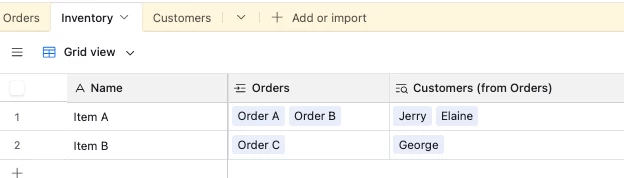

Hm, may I know why you’d want to add a direct link between Inventory and Customers?  In these situations it’s usually recommended to use a lookup field to pull data over like so:

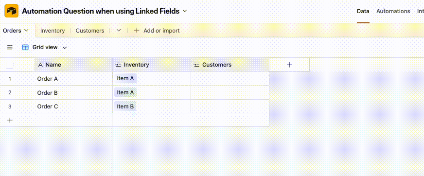

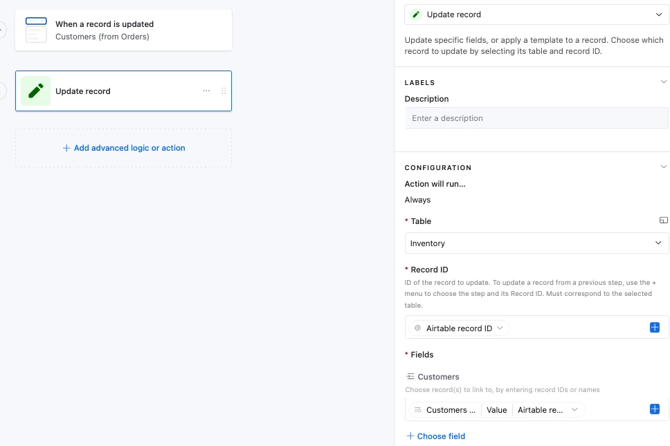

If you really needed the link set up, you could then use an automation that triggers when the lookup field gets updated, and its action would be to paste the lookup field value of the Customers into the actual linked field to Customers, and I’ve set it up here for you to check out
  • Apr 12, 2026 5:26 AM UTC
Thank you for your answer. After some extremely specific prompting to Omni I was able to get this working. Essentially, we sell houseplants, and our inventory is very specific. Like 1 item per record. Were a small in home nursery and we have hundreds of plants so sometimes it can get very confusing, so much so I switched over to Airtable from our basic spreadsheet. Hence why when I label something as part of an order I want our inventory to update.
